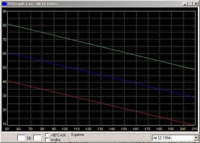

Hello everyone,
Could it be that in the new VCDS version (by Rainer), when selecting "TDI Timing," only the engine variants "AGR, AHF, ALH, ASV" are available? The dropdown menu only shows this one option. I'm missing the older 1Z variants – specifically, the ones for my 1Z.
I have readings of "t Diesel = 149" and "SB = 23" - according to the graph, this is too late (significantly below the lower line). Now I'm not sure if this is due to the wrong engine variant and whether these values are acceptable for the 1Z engine, or if I actually need to make some changes.
Translated on 15-08-2026, 23:33.
Joined: 03/13/2003
Posts: 10121
Location: in der Werkstatt
Post23-07-2008, 10:56    Subject: VCDS TDI Timing: No 1Z Support Quote
Here's the graph from a 704.1.
 Bug TDIGraph

Post24-07-2008, 4:25    Subject: VCDS TDI Timing: Troubleshooting & Solutions Quote
Hello everyone,
Could it be that in the new VCDS version (by Rainer), when selecting 'TDI Timing,' only the engine variants 'AGR, AHF, ALH, ASV' can be chosen? The dropdown menu only has this one option. I'm missing the older 1Z variants - or the ones specifically for my 1Z.
Do you use the current data as of June 26, 2008?
'With that in mind, the selection should actually look like this:'
http://www.Ross-Tech.net/vag-com/screen-shots/TDIGraph_Selection.png
We have reorganized the engine variants to make them more organized overall and to avoid redundant entries.
-Uwe-
