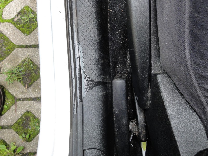

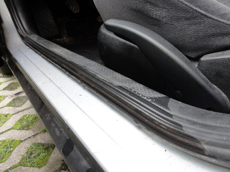

Hello forum,
My Passat is slowly transforming from a damp environment into an aquarium.
Water is collecting on the driver's side, both in the front and rear areas, above the seal, and then leaking into the interior. It then accumulates in the lower left corner of the footwell.
I haven't been able to trigger it yet, even with the watering can, whether by pouring water on the roof, the hood, or the window seal. The door mechanisms are free.
Could it be that the plastic seals at the bottom of the doors, which the Passat 3B has unlike the Golf and others, are so tight that water can't escape from the bottom and instead enters the interior? Or is there also the problem of poorly designed door seals here, as mentioned in a technical article? Documentation for the Golf IV/Leon/Octavia?

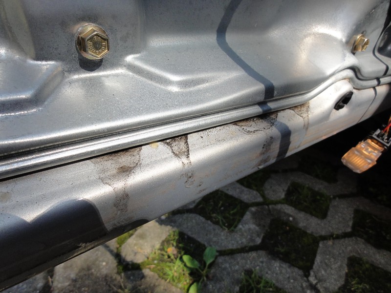

Check if the carrier panel inside the door (the metal panel where the window mechanisms, etc. are mounted) is properly positioned. Otherwise, water might run along it and leak out from the bottom. There's a rubber seal attached to it that usually sticks to the door frame a little bit.

It will fit in exactly the place that pax described.
It doesn't matter whether the seals have been removed before or are still factory-installed.
A seal made of a type of foam/rubber mixture is applied to the base, which is like a baking sheet. When it's new, it sticks well, but after a few years, it becomes porous and leaky.
You can either buy new aggregate carriers (€€) or use black VW sealant cord (part number...). AKD49701004R10) and remove any remnants of the old seal beforehand.

Hey guys,
Okay, I've heard what you all said. Actually, the pastry crust was leaky or porous. A look at the photo clarifies that. It is, incidentally, representative of all 4  doors.
To seal it, I used body adhesive from the hardware store. Instead of removing the baking sheet, I only lifted it from the bottom, slid a cloth underneath to dry/clean it, and then applied a generous amount of adhesive underneath. After screwing it back in place, I also applied an additional bead of sealant between the baking sheet and the door. If this stuff sticks to metal as well as it sticks to your fingers, then things are going to stay dry in the car from now on.
