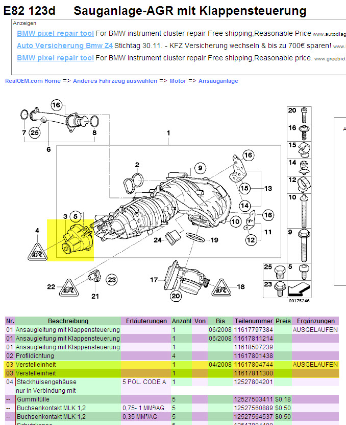

Here, you can see the affected component at position 3.
It seems to be easily replaceable, and a new version is already available.
http://realoem.com/bmw/showparts.do?model=UR51&mospid=50606&btnr=11_4101&hg=11&fg=40

Post02-11-2010, 11:57    Subject: BMW 123d Swirl Flaps: Problems & Solutions Quote
Here is a picture of the intake system.
The fee is 141.28 EUR.

Post02-11-2010, 13:34    Subject: BMW 123d Swirl Flaps: Problems & Solutions Quote
The part looks very similar to the V157 component of the 1.6 CR TDI engine in the drawing.
That's then a motor with a gearbox, referring to the teeth that Rainer mentioned.

Post02-11-2010, 15:27    Subject: BMW 123d Swirl Flaps: Problems & Solutions Quote
The part looks very similar to the V157 of the 1.6 CR TDI in the drawing.
Possible.
I will report.
Normally, I would just start tinkering with it, but considering the warranty, I'm going to hold off for now.
I'm just glad I now know what it is.
