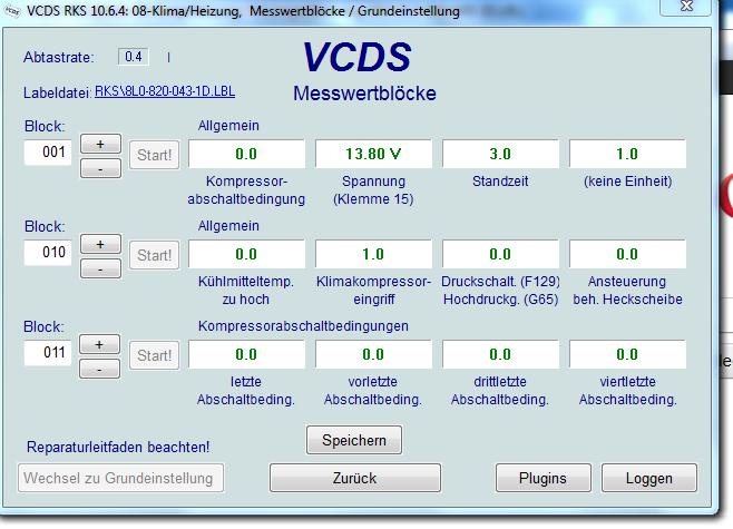

What values do you have in measurement block 1, 10, and 11 of the Climatronic control unit, with the engine running and the "Auto" button previously pressed?
Translated on 06-09-2026, 23:59.
chriskross
Joined: 04/19/2006
Posts: 304
Location: Österreich
Post29-06-2011, 9:18    Subject: Audi A3 Climatronic: Installation & Probleme Quote
Hello, the log file is attached.
Best,
Chris

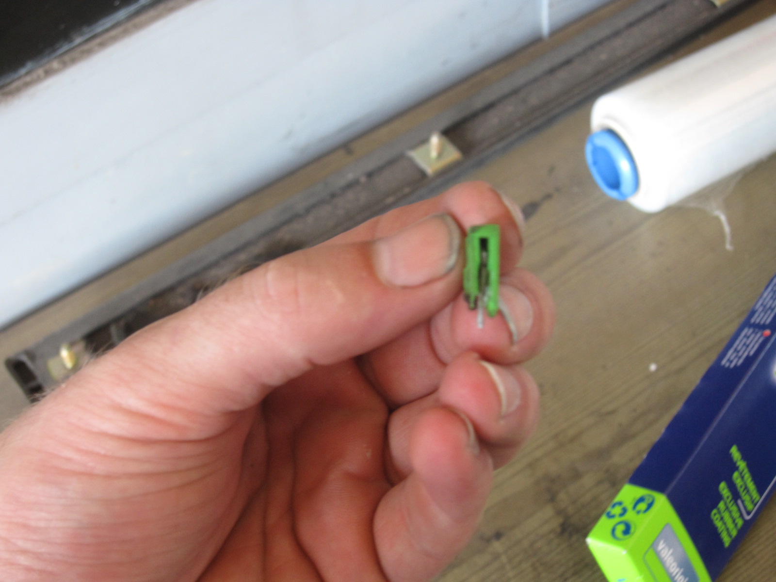

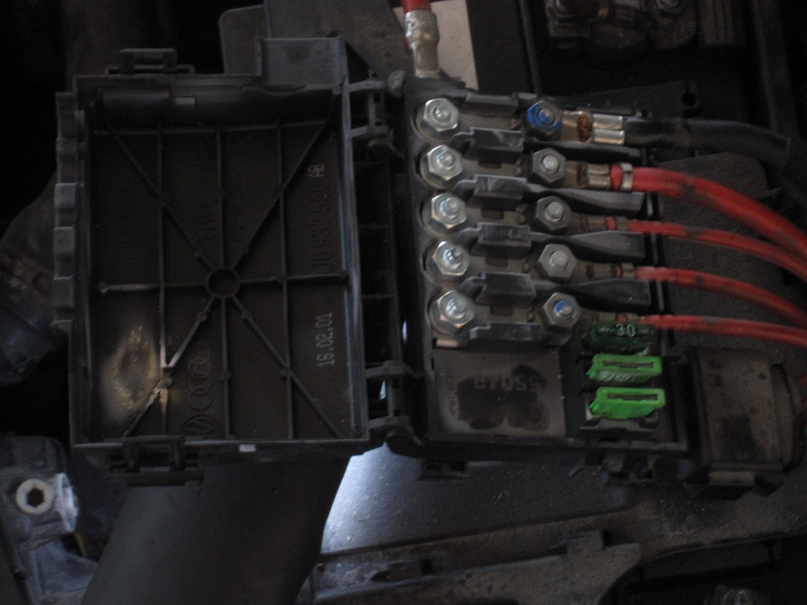

The error was finally found; it was a burnt-out fuse that appeared to be okay upon measurement, but it had actually burned out over time. icon_mad.gif
"Thanks everyone."
