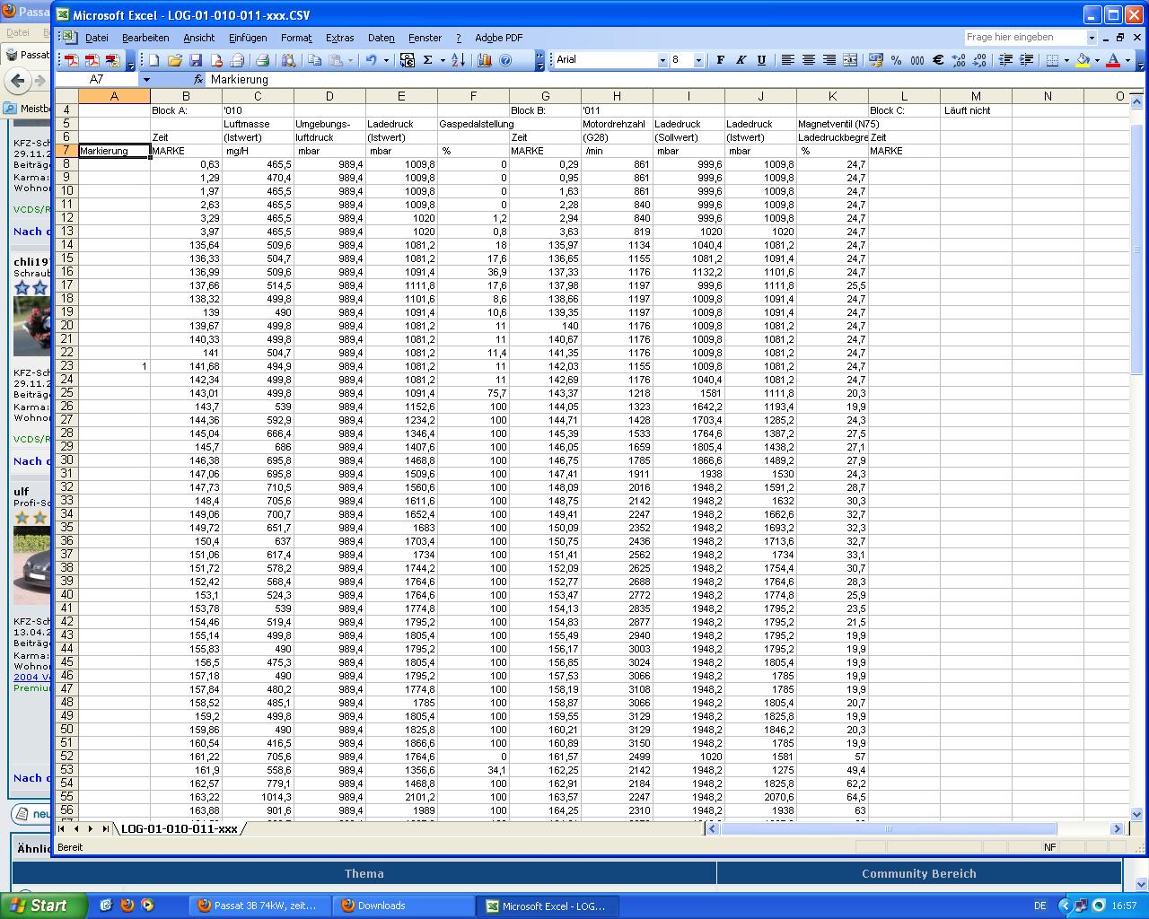

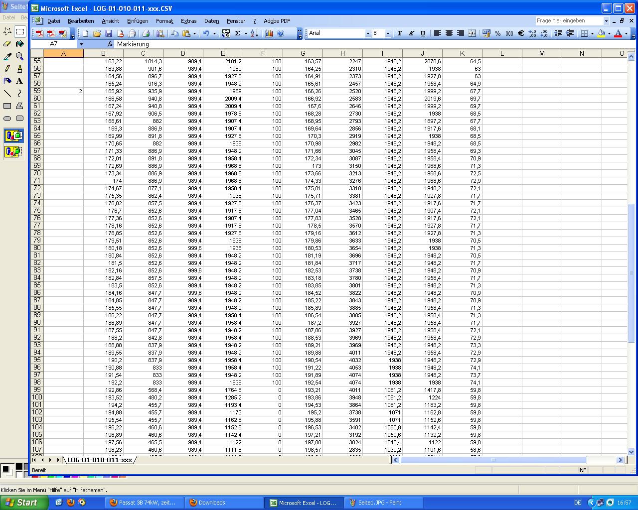

Post10-08-2012, 16:00    Subject: VTG Closure Fixes Temporary AVB Light Issues Quote
Hi Ulf, I have Excel 2003 and can open it normally, of course using the CSV converter beforehand. Which version doesn't require the converter?
I took two screenshots for you.

Post10-08-2012, 17:52    Subject: VTG Closure Fixes Temporary AVB Light Issues Quote
. They are not very helpful to me, because I usually create charts to look at; that is much more understandable for me than just rows of numbers.

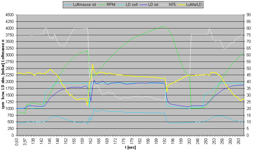

I hope I've done it correctly this time.
Ulf, could you please take another look at this? Thank you.

Post11-08-2012, 18:19    Subject: VTG Closure Fixes Temporary AVB Light Issues Quote
chli1976 wrote:
I hope I did it right this time.
Ulf, could you please take another look at it? Thank you.
The log shows a LuMa suction process, then everything runs as it should, and then another suction process occurs -> which is very "nice."
You can see that, similar to the vacuum cleaners, the LuMa/LD ratio decreases starting around 2200 rpm. To achieve this, there must be a bottleneck somewhere behind the LD sensor icon_eek.gif.
I would actually like to rule out the possibility of a very wide opening (VTG), because according to what I saw on LD-TV, it was already partially open at the beginning of the drama.
As a spontaneous idea, I'm thinking of the secondary air control valve (or EGR throttle valve, if the vehicle has one).
