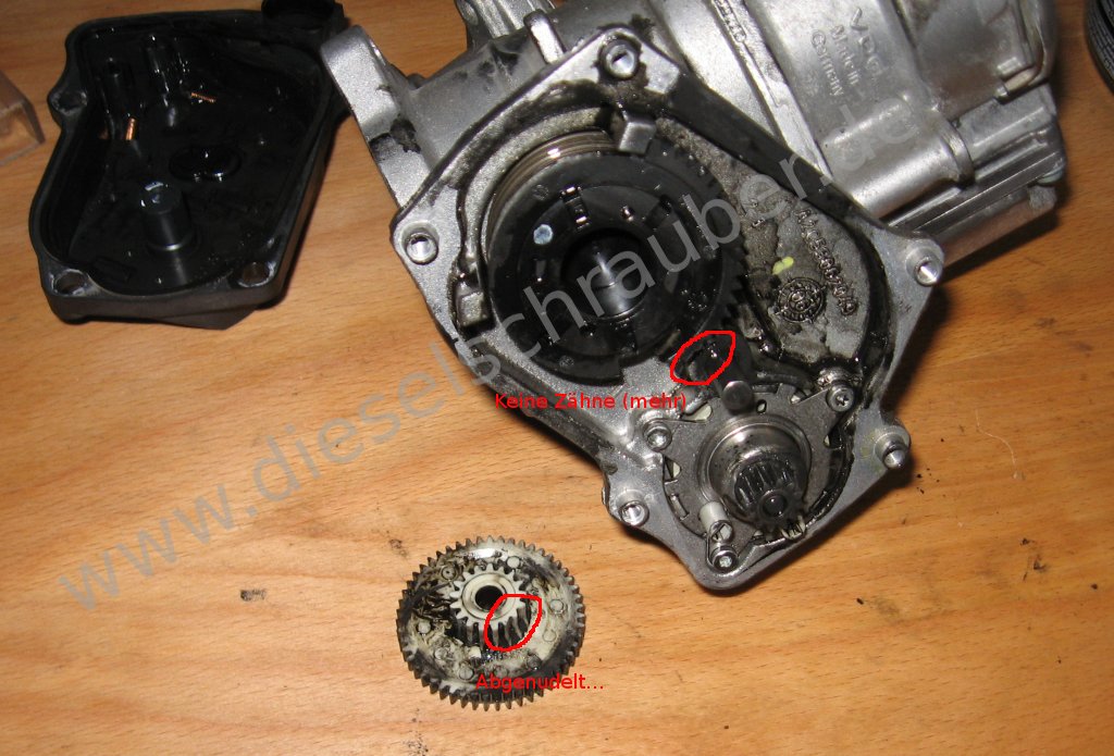

In my premium product, the mechanical component of the EGR valve failed after approximately 63,000 km.
The EGR valve consists of a type of throttle valve that is operated via a shaft and two sets of gears.
Ironically, the least stressed gear, which is located on the drive shaft of the actuator motor, is made of metal. The rest is made of plastic and suffers from tooth wear, even though the valve itself operates smoothly.
Clearly, the wear and tear is due to incorrect material selection or inadequate sizing.
- Is there an improved EGR valve with a metal wheel?
- Is 03G131501Q the latest revision level?
- Is there a free replacement available from the manufacturer of the premium product, as there appears to be an obvious design flaw?

The cross-brother BMR received a new valve in 2008.
03G131501 to 03G131501P.
How did you notice the defect?
Translated on 02-08-2026, 12:50.
Posts: 18113
Post26-02-2010, 11:16    Subject: 2.0 TDI AGR Valve: Faulty & Replacement Guide Quote
Fortunately, it's at least always "too."
@bakkanoViewing profile: bakkano: Thanks, DM!

Posts: 18113
Post05-03-2010, 8:40    Subject: 2.0 TDI AGR Valve: Faulty & Replacement Guide Quote
I ordered the 03G131501Q part relatively cheaply from a general parts supplier instead of from the overpriced dealers. The cost was probably even lower than what Audi would charge with goodwill arrangements.
I'm going to check if the teeth are made of a more durable material or at least wider. It should arrive today.
Translated on 02-08-2026, 12:54.
Posts: 18113
Post11-03-2010, 23:02    Subject: 2.0 TDI AGR Valve: Faulty & Replacement Guide Quote
It's also cheap plastic junk, and that's on an A6...
Translated on 02-08-2026, 12:55.
