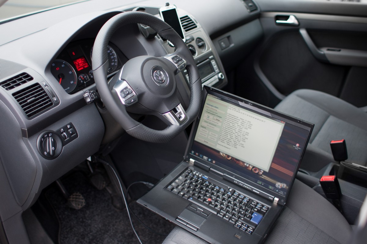

Yesterday, I installed a multifunction steering wheel from a Golf 6.
So far, everything is working. "Except for the Bluetooth pairing with the UHV."
"Previously, there was no MFL installed. The instructions state that you should press the telephone button twice in quick succession within 5 seconds of turning on the ignition, and then you should hear an audible signal. Unfortunately, that's not happening for me." Do I need to code anything else there?

Post02-03-2013, 13:59    Subject: Multifunction steering wheel (Solved) Quote
I see an empty charging tray and a...
Code:
Adresse 77: Telefon        Labeldatei: DRV\3C0-035-729.lbl
   Teilenummer SW: 3C0 035 729 G    HW: 3C0 035 729 G
   Bauteil: Telefon             7609
   Revision: 00012000    Seriennummer: 0000B6A102843
   Codierung: 0016021
   Betriebsnr.: WSC 01324 785 00200
To the best of my knowledge, that doesn't work on the 729G if there's absolutely nothing inside.
At least one earbud or the pairing adapter.
At least, our...
Code:
Adresse 77: Telefon        Labeldatei: RKS\3C0-035-729.lbl
   Revision: 00012000    Seriennummer: 0000B6A004801
   Codierung: 0016041
   Betriebsnr.: WSC 00000 785 00200
Exactly like that.
Was das 1K0-953-549-CH already installed?
Because with LIN 1.3 and 2.0, it's a truly remarkable piece of technology.
Too bad, I had installed a different one back then.
Translated on 06-07-2026, 18:31.
