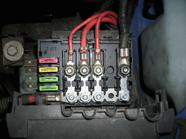

"@brezelmann01: Yes, I checked the fuse box in the engine compartment, including the fuses, and they are all fine, and there's no sign of corrosion. However, the fan is not turning on."

@brezelmann01Viewing profile: brezelmann01: Thank you for your input. I'm not sure if the fan starts automatically with the air conditioning when the Lupo 3L is turned on, because energy saving is a priority. It might only start at a certain coolant temperature - but that's just a guess.
The "frost sensor" is likely the G346 (temperature sensor for compressor shutdown) – I have at least already checked its functionality with a small series of measurements (see my first post, point four).
The fuses appear to be in good condition, both visually and electrically. I cannot detect any signs of scorching or corrosion that are sometimes present in this type of construction (see picture).

 Sicherungshalter auf Batterie Lupo 3L" auf "Sicherungshalter Motorraum Lupo 3L" (Batterie ist nämlich im Kofferraum bei diesem Modelljahr)

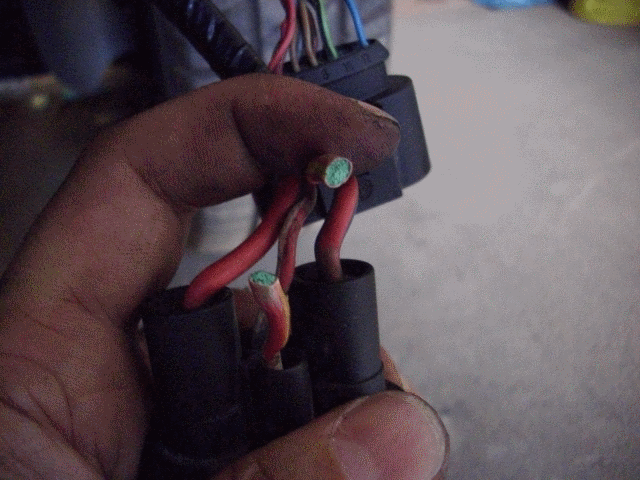

Thank you for the help; the problem is temporarily resolved. The checklist from guste100 contributed significantly to this solution.
A positive wire leading to the fan control unit was so heavily oxidized under the insulation that none of the strands were sufficiently conductive. After being bent a few times, the cable completely broke.
For now, I've soldered a piece of wire in between to make the connection, as there was just enough cable left on the connector. Unfortunately, I haven't been able to remove the contact from the connector housing using my available unlocking tools. I tried using the timer contact release tools, but they seem unsuitable. How can I get the contact out, and with what tool?

 Stecker fĂźr LĂźfter der Klimaanlage (Lupo 3L) auf "Stecker LĂźftersteuergerät
 File size:  139.43 KB
