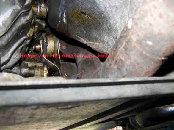

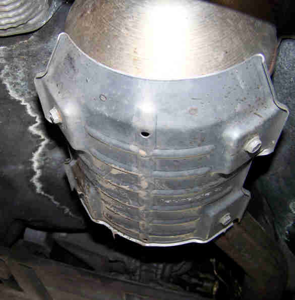

I have the OE conversion kit installed on my Passat, consisting of an Oxicat and DPF which now replaces the intermediate pipe, along with a rear mounting bracket for the (5-speed) gearbox. The manufacturer is HJS. It fits perfectly, there's no rattling, no corrosion or other problems. There are also no power losses or increased fuel consumption. It has been installed since autumn 2009. I have driven approximately 60,000 km with it since then. If I have time this weekend, I will take a picture of the system for you.
The Sharan mentioned above also has a HJS combination filter, and it hasn't experienced any corrosion problems so far.
EDIT: Here are the pictures. Considering it's been under snow for two winters, it looks pretty good.

Thank you for the pictures.
Specifically, the bracket in picture 2 appears to be much more robust than the one on my Twintec version, although it looks different anyway with the 5-speed gearbox. However, the Twintec bracket is not different for the 5-speed gearbox variant either.
In image 1, which shows the DPF (Diesel Particulate Filter), I can't quite determine the exact position from which the photo was taken.
Translated on 05-08-2026, 22:17.

Post22-05-2011, 19:30    Subject: DPF Not Fitting: Twintec on VW Passat 3BG - Rumble? Quote
"The photo was taken between the doors, approximately behind the DPF filter, and then angled forward. It's not a combination filter. More would be visible if the rear underbody protection panel were removed. However, due to chronic time constraints, we unfortunately have to postpone that."
Passat Variant BGW 2005
Translated on 05-08-2026, 22:18.

Post22-05-2011, 19:51    Subject: DPF Not Fitting: Twintec on VW Passat 3BG - Rumble? Quote
You're welcome, I understand now.
Overall, I find your bracket design very similar to the Passat models, where the intermediate pipe is also mounted (at least if I compare it to the AKTE diagrams).
Regards,
