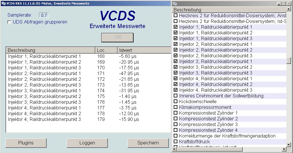

Post10-09-2013, 17:05    Subject: 2.0 TDI CR (CAGA): Cold Start Issues & Fixes Quote
Here are the calibration points for the injectors at different pressures for comparison, as seen on my CFFB.
Here's another VCDS configuration file for the relevant advanced measurement values.
 Injektor Kalibrierpunkte mit VCDS auslesen.
 File size:  163.33 KB
 Viewed:  10811 times
CFFB-Injektor-Kalibrierpunkte.a01
 Injektor Kalibrierpunkte in erweiterten Messwertblöcken finden (CFFB Motor).
 File name:  CFFB-Injektor-Kalibrierpunkte.a01
 File size:  84 Bytes
 Downloaded:  427 times
