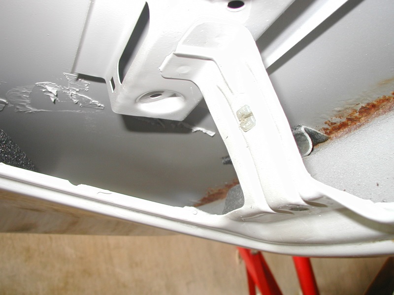

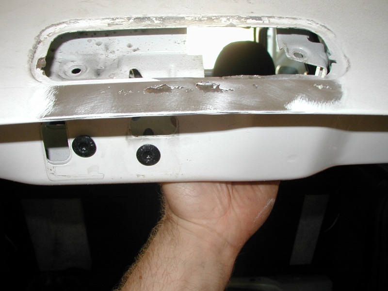

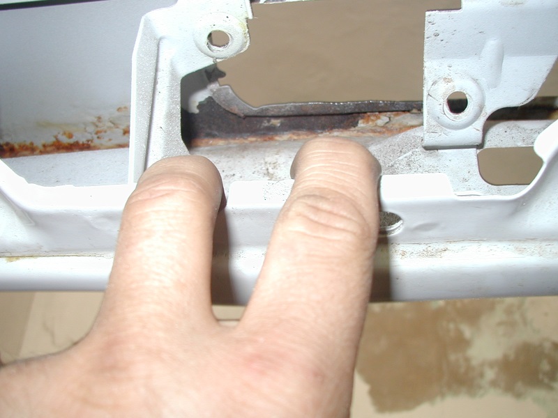

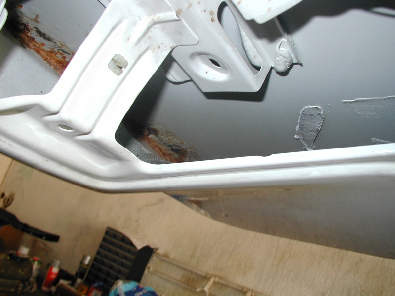

"On my white Lupo 3L, the rear hatch is rusted through – from the inside out. This is the standard steel rear hatch, not the aluminum/magnesium one. The problem area is where the outer and inner panels meet in the lower section."
"Question: Is there any chance of getting a warranty for rust damage on the Volkswagen, considering the car hasn't been to the service center very often? I suspect it's unlikely."
2. Question: How can I temporarily fix this? I've sprayed plenty of Fluid Film inside to at least preserve what's left of the wood. But how do I fill in the holes? Putty will probably fly right out of the tailgate pretty quickly. In the medium term, a new tailgate needs to be installed, but I'd like to drive it for another year without being embarrassed by a completely rotten rear.
Bye.

How can you temporarily fix something like that?
Honest opinion: it's best not to do it at all anymore, because it's unpaid work with no satisfactory result.
I would now prime the bare spots. Then, I would carefully cut a piece of protective film (like the one on the rear bumper of a VW Passat 3B), apply it, and paint over it – and that's it.
Of course, there's also the option of filling it with putty, but that requires a bit more skill to ensure a smooth finish without any bumps. To do this, you need to push the remaining material inwards by about 2-3mm to create enough material for the fill, which isn't easy in the area of the grip indentation.

Here's a quick update: The original hatch is temporarily patched up with filler. Unfortunately, the new rear hatch handle wasn't available over the weekend, and so far, the locking cylinder hasn't come loose from the old handle.
I examined the first 50 Euro coin. Although the seller had assured me it was rust-free, it naturally also showed signs of corrosion in that spot. While the spread wasn't as extensive as on mine, I could see that someone had also ground a hole into it during the rust removal process.
I read somewhere that the original aluminum/magnesium rear doors used in the Lupo 3L were replaced with standard steel rear doors in production, among other things, due to corrosion problems. Does anyone happen to know where the aluminum/magnesium rear door had its problem areas?
