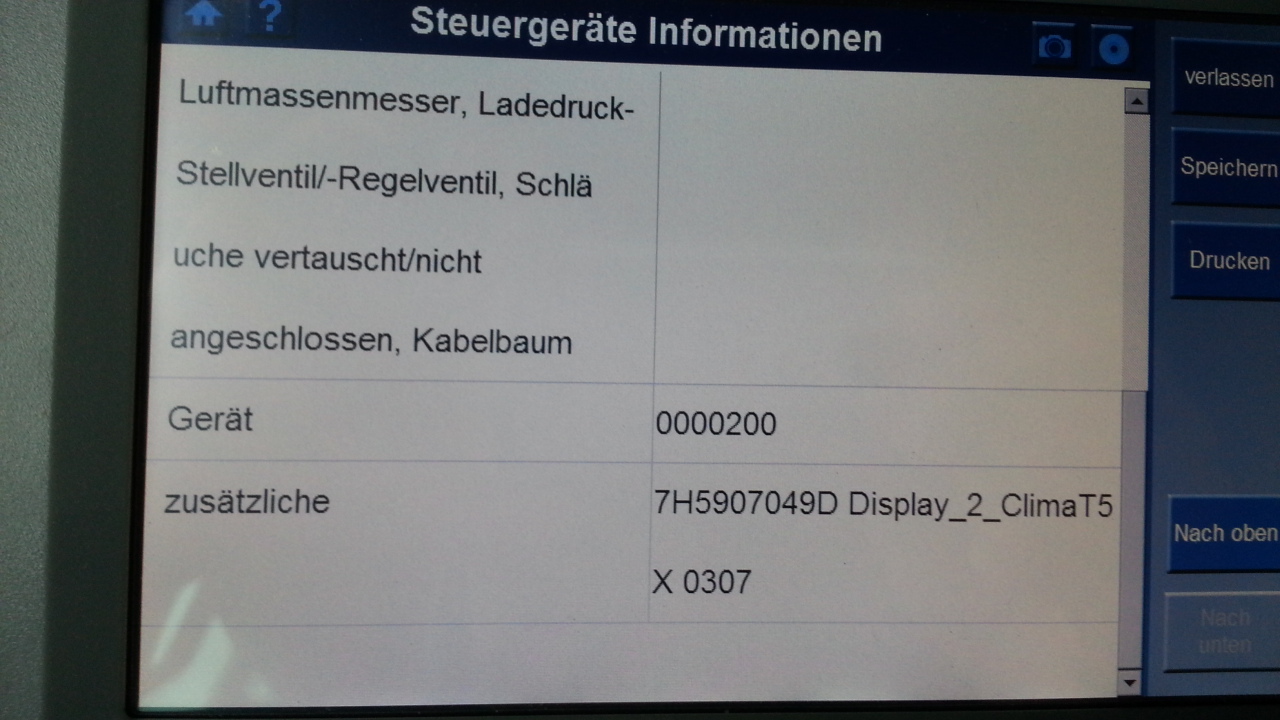

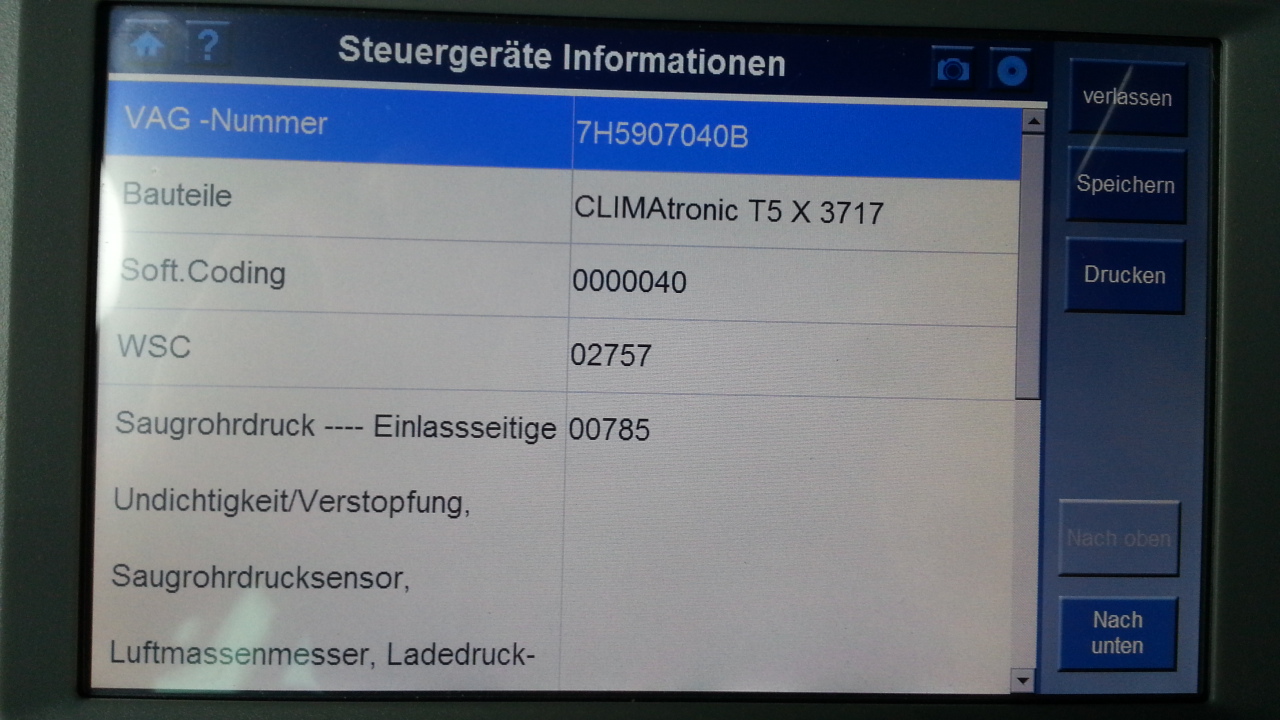

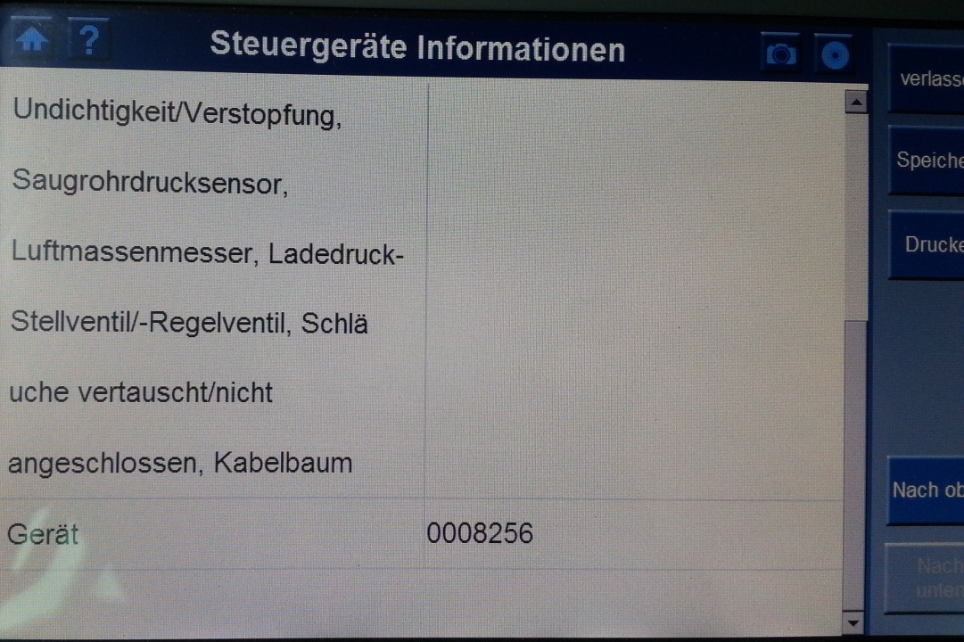

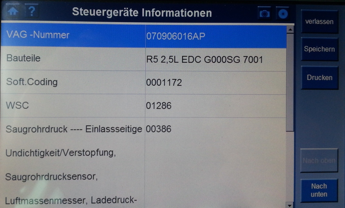

Hello, thank you for the reply. I didn't notice anything unusual in the engine control unit. Revving the engine above 3000 RPM while stationary results in fault code 18.
Here are the details for the climate control unit. These printouts were retrieved using my Autel 'workshop tester' via 'control unit information.' Why does every control unit display 'intake manifold pressure ---- intake side leak/...'?

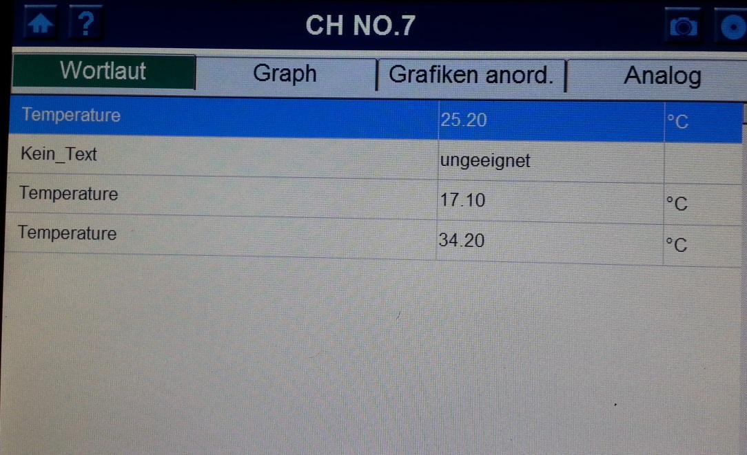

Please check the temperature readings on the engine for plausibility (refer to sections MWB 7 and 68 onwards, specifically exhaust gas temperatures).

Post15-08-2014, 21:17    Subject: Climate compressor T5 only runs occasionally, shutdown condition 12 Quote
Unfortunately, not all the temperatures in my diagnostic tool are accurately labeled. There are no temperature readings for MWB 68 and following, and I suspect that only vehicles with a DPF (Diesel Particulate Filter) have a corresponding exhaust temperature sensor. I haven't been able to find a temperature reading that falls within that exhaust temperature range. The T5 does not have a DPF. I have attached the reading for MWB 7.
'The air conditioning system hasn't been serviced. With the engine running, the pressure in the AC system is 4 bar at 20°C. When it actually starts working (which is only when the car is moving, as it doesn't even turn on when stationary), the pressure is around 13 bar. So, it's unlikely that there's too much refrigerant, right?'
Both radiator fans can be activated via actuator diagnosis. However, it is now clearly audible that neither fan is running. Does the second fan always have to run when the air conditioning is active (i.e., the compressor is running)?

Hey, are those weird screenshots actually from the VAG tester?
Fehlercode 00386 ergibt in einem Motorsteuergerät Null Sinn und im Klimasteuergerät steht 00785. icon_question.gif
00785 indicates: temperature sensor - control panel - G56, which would make sense.
Your quirky tool (which one?) is babbling something about the intake manifold pressure in the air conditioning system (doesn't that exist there!) icon_question.gif

Post16-08-2014, 8:41    Subject: Climate compressor T5 only runs occasionally, shutdown condition 12 Quote
Autel "Workshop Tester"
Ok, das habe ich übersehen. Irgendwie sind die Fehlereinträge (?) aber für den Lokus. DeThe first one would be...
00386 - Minusausgang Audiokanal für Sprache/Telefon.
and has no place in a motorcycle's engine control unit.
Perhaps it's time to use a working diagnostic tool?

Post16-08-2014, 9:26    Subject: Climate compressor T5 only runs occasionally, shutdown condition 12 Quote
Hello, thank you for the feedback. I have an AUTEL Maxidas 708, not a VAG tester.
The screenshots are not from reading the error memory; they are simply 'control unit information.' The nonsense like 'intake manifold pressure ---- leak on the intake side/...' can be ignored there. I don't know where that information comes from, but it's the same for all VAG vehicles.
