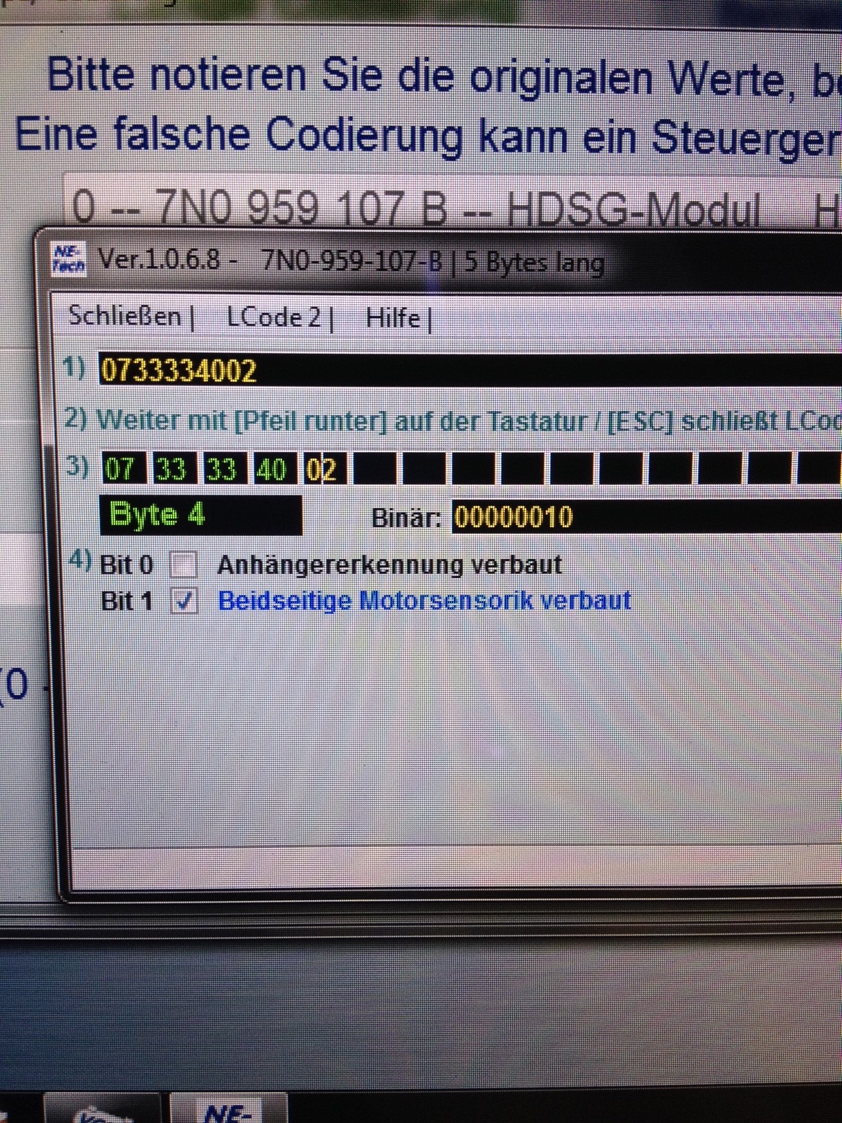

Post25-11-2014, 9:46    Subject: Recoding the tailgate control unit without trailer function Quote
Hello, I happened to see a Sharan 2 parked outside my door yesterday, and it had a tow hitch and an automatic tailgate. I then went into the tailgate control unit for long coding, and lo and behold: it works!
You can uncheck the box in byte 4, and the tailgate will automatically open when a trailer is connected (with the 13-pin connector plugged in).
Since the pin configuration can be changed in byte 1, I assume that this control unit is installed in the following vehicles: Porsche Cayenne, Skoda Superb, Octavia, VW Sharan, and Seat Alhambra.
I've attached a scan of the control unit and a photo of the coding.
Perhaps this is suitable for the section "Instructions".
Sincerely,
Address 6D: Rear hatch (----)
Label file: RKS\7N0-959-107.clb
Part number SW: 7N0 959 107 B, HW: 7N0 959 107 A.
Component: HDSG Module H11 0803
Revision: 41011001 Serial Number: 149100132
Encoding: 0733334002
Operating Number: WSC 00020 999 12345
ASAM Dataset: EV_HDSGVW428 201133
ROD: EV_HDSGVW428.rod
VCID: 366898BC895B39AE711-8063
No error codes found.
 Lange Codierung, Anhängererkennung Sharan
 File size:  840.59 KB
 Viewed:  4127 times
