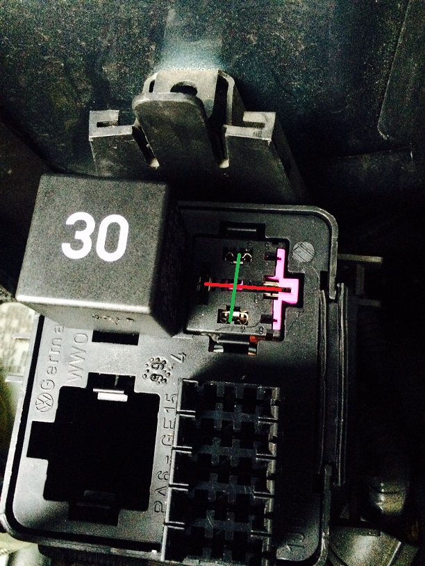

For the past few days, I've been trying to get my air pump working, but without success, and I'm not sure what the exact problem is.
I measured the control signal and the power supply as shown in the diagram. The red wire provides the power supply to start the pump; I'm measuring 12V, and when I bridge it, the pump also starts.
When the motor is running, the switching signal for the relay (green line) shows 12V; when the motor is off, it shows 0V.
So, it seems like the cables are in good condition up to that point?
Is the relay not defective either? I've already installed two other relays, and I even bought a brand new one directly from VW today to be sure.
The error code indicates that the secondary air pump's flow rate is too low (which makes sense, since it's not working), and the relay shows a short circuit to ground. That means there's nothing on the 12V line, but isn't everything supposed to be there?

According to your somewhat difficult-to-understand measurements, there seems to be voltage both at the coil and at the load contacts of the relay (by the way: RELAY!  ). If the latter are shorted, the pump (valve) runs. The relay is also new, so I would look elsewhere, such as... AGR (if applicable to vehicles manufactured in 1999 or later), throttle body, air filter, etc.
Just think that the error message you described will likely have a different cause.

Here, you could also test the part's functionality. It's possible that a faulty valve could cause condensation and... Exhaust gases entered the pump in reverse and damaged or destroyed it.
Otherwise, measure the voltage at the relay again - preferably when it's plugged in!

The problem was with the pump. The voltage was always okay, at least when the relay wasn't plugged in. Even when bypassing the relay, the pump turned on. As I mentioned before, I even went the extra mile and bought a brand new relay from VW.

If I bypass the control signal, the pump starts, so it should be okay, right? I'll take a look anyway.

I also measured the wiring. There's no continuity when the relay is plugged in? Okay, so when I hold the measuring device to both cables, it shows 0V. But when I do it without the relay, it shows 12V.
I then wanted to measure the cables individually. On one cable, I measured 12V when applying voltage to the blue/yellow wire, which, as far as I know, comes from the oxygen sensor. The other one goes to the engine control unit. If I connect it to the positive terminal of the battery there, should I have continuity? (Sorry, I'm not an electrical engineer, and I don't know if I'm expressing myself clearly  ).

Hello AutoService,
Thank you for your participation as well. Everything sounds quite logical. However, what doesn't fit is that it only happens when he's warm. When it comes to an electrical problem, shouldn't it make no difference whether it's hot or cold?
But I'll still check the cables generally, just to be sure.

Cr4sh wrote: | ... what do you mean by "securely and firmly" closing? Do those rubber hoses need to be sealed?
Unfortunately, I don't have the valve in front of my eyes right now, so I can't describe what it looks like ... | .
"A silver-colored, metal container" should be located above the secondary air pump and connected to it with hoses.
The exhaust outlet needs to be well and securely sealed because hot exhaust gases can otherwise flow backwards into the plastic components. Rubber, does it break?
Best regards from Munich!
