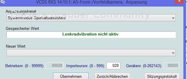

I made these changes as an adjustment (see the image). I didn't go into the coding to make these changes, but rather used the adjustment settings. I was able to modify the adjustment, but I can't set the original value because I always get the message: "Invalid value." I should have the option to revert to the original setting.
Should I perhaps create a backup image of the control unit? Or do I need to take it to a workshop and have them reset the control unit to factory settings?

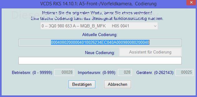

Hi there,
Please provide the complete ECU coding (screenshots), the overview for adjustment channels, and specifically the variations of the two adjustment channels in question.
Maybe you'll see something there.

I've now created a representation of the adaptation channels and also took a Screenshot of the encoding.
- In Lane Keeping Assist system mode, the setting "Steering wheel vibration not active" is now enabled. Previously, the setting was "Steering wheel vibration active."
- When the lane keeping assist warning intensity is set, it is currently configured to "Low." The original setting was "Medium." Additionally, there are options for "High" and a setting that can be adjusted through the menu.
It should be possible to revert to the original settings, but unfortunately, the message "invalid value range" appears.
Could it be due to the VCDS software?

Post09-03-2015, 22:32    Subject: Reset settings: Can't undo changes? Quote
I had already asked about something else, not a photo with the long code.
That was already in the scan.
Here's that thought again:
- Complete encoding of the control unit (screenshots), with each byte/bit labeled.
- an overview of adaptation channels,
- the variations of the two adaptation mechanisms in question;
It might be possible to figure out what's blocking the reversion of the adaptation.
Did you re-enter both changes together, or separately? Also, how did you make the first change?

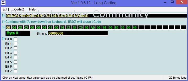

I have now taken screenshots of every byte in the A5 control unit.

ich habe von Deinen n Bildern nun n-1 gelöscht. Why?
Because everything shows the same thing, namely that there are no texts for the bits, and the line with the green bytes ( 3) already contains everything. Nothing else is visible in the deleted images either.
