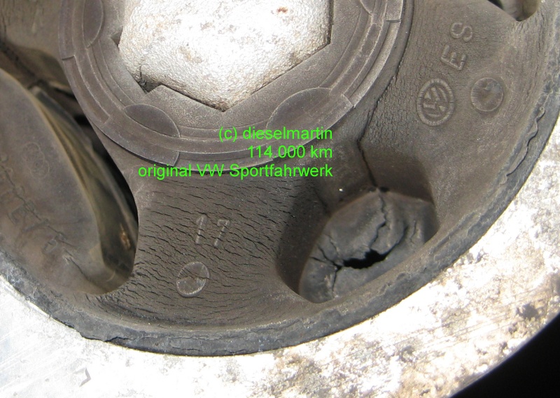

how easy are the rear wishbone bush removal from the wishbone and do I always have to use the T10096 when installing?
How does the T10096 work exactly?

Well, it's centered by default. I would recommend replacing the existing bearings and then measuring their position. This certainly won't hurt the KM stand. If the entire salad already deviates from the basic setup, you essentially have no choice but to have it measured.
The stabilizer bar should be able to be easily detached from the bearing with the aid of WD-40.
If you were to have it measured at VW, I would also have the assembly done there – because the official time estimate is low.

Can you provide detailed photos of the T10096?
The internet shows screws with cones for threads, but also with heads for screws. How do cones form halves?
If you first insert the T10096 and then push the corresponding component over it so that the cone centers it?
Can the part then be used as a mounting bracket (but not centered) instead when screwing it in?
Many questions, some of which are primarily about understanding.
Thank you.

VW only requires "officially" one inspection if the final test drive results in a steering wheel that is tilted.
Well read icon_wink.gif, but the steering wheel doesn't necessarily have to be tilted if it's misaligned...
Many questions, some of which are simply about understanding.
What makes it so difficult? The mounting holes on the axle support are significantly larger than the mounting screws, presumably to... To be able to compensate for part tolerances or misalignments after accidents.
In the normal case, everything should be installed centrally. To do this, you screw the entire body in, including... Strut bearing supports with fixing tools and the bearing supports on the axle body are fixed, and then the fixing tool is replaced "piece by piece" with screws.
Theoretically, when replacing the wishbone bearing mounts, only the outer fixing hole should be centered. However, since the two inner fixations on the axle support are quite tightly drilled, there isn't much to center around, because the axle body itself is still in its correct position and hasn't been removed.

That's clear.
only how does the T10096 become centered when assembled like this?
http://www.samstagsales.com/images/vw_matra_t10096.jpg
In this way, I can imagine centering, where the cone presses against the prey and centers it:
http://www.buzzmart.com/media/products/70/big_0.202735001327749484.jpg

You're thinking.
In reverse, it seems to work as well. In this case, the axle body is simply pushed over the cone as a mounting aid. It's like a jacket and pants. The rest will become clear during assembly. icon_wink.gif
