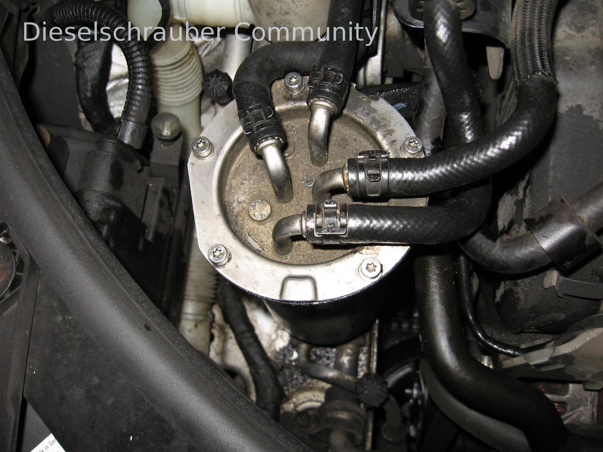

Is there a trick to closing the diesel filter on the CFFB engine? The cap is incredibly difficult to tighten.
 Dieselfilter mit O-Ring im Deckel, Motor 2.0 TDI CFFB.

Lubricate the rubber band and use wood to propel it.
Don't overtighten the screws; the flange will warp, and it will never seal properly again.

I always use screws and have never had a leak.
Make sure to lubricate the sealing ring properly, and then rotate each screw a quarter to half turn in a circular pattern.

findus170 wrote:
Grease the rubber ring and push it down with wood.
Don't try to tighten it by pulling on the screws; the flange will warp, and then it will never seal again.
chli1976 wrote:
Always do it using the screws, and I've never had a leak.
Lubricate the sealing ring properly and then rotate each screw a quarter to half turn
-1... These things are extremely sensitive; I've even made one leak myself despite being very careful.
I'll never do that again; I'll only put the screws in after the lid is properly aligned.

-1... These things are extremely sensitive; I've even damaged one myself, despite being very careful.
I will never do that again; the screws won't go in until the lid is properly seated!
Assuming you can still get the screws in, even with the offset angle.
Always tighten the screws gradually, while simultaneously applying pressure... I haven't broken any yet icon_wink.gif.

Okay, thanks! Lubricating also helped me a bit. I then used pliers and some wiggling to push the filter in piece by piece, and the rest was done with the screws.
I don't consider this to be a very well-designed component compared to the other filters that are completely replaced.

I apply a thin layer of fresh motor oil to the gasket and the gasket's seating surface on the housing, and then I press the cover down with my bare hand - it works great this way. icon_wink.gif
Note: I use the oil that also goes into the engine for this purpose. icon_idea.gif
