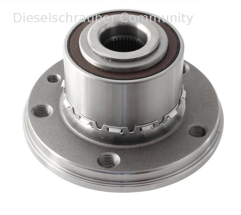

"Take it apart and send it back! The ring is essential; what else would prevent the bearing from migrating outwards?! Your dealer is telling you nonsense. About ~4 months ago, I installed a FAG bearing in a very similar Seat Ibiza, and of course, there was a ring on it; and that is certainly still the case today. icon_wink.gif"
@ Rainer: We're talking about something like this. icon_wink.gif
 Radlager
 File size:  47.43 KB
 Viewed:  4457 times
Translated on 13-10-2026, 2:28.

Post09-11-2015, 21:57    Subject: Skoda Fabia Wheel Bearing Problems Quote
Hi!
Yes, that's the warehouse.
I also don't know why they left out the ring, and I can't explain it.
"However, that's now quite common. The manager of the company where I bought it knew about it and said that the products are now usually sold in that condition."
I have also searched online, and it turns out that the storage containers are available both with the ring and without.
Someone probably saved 50 cents in the wrong place again.
