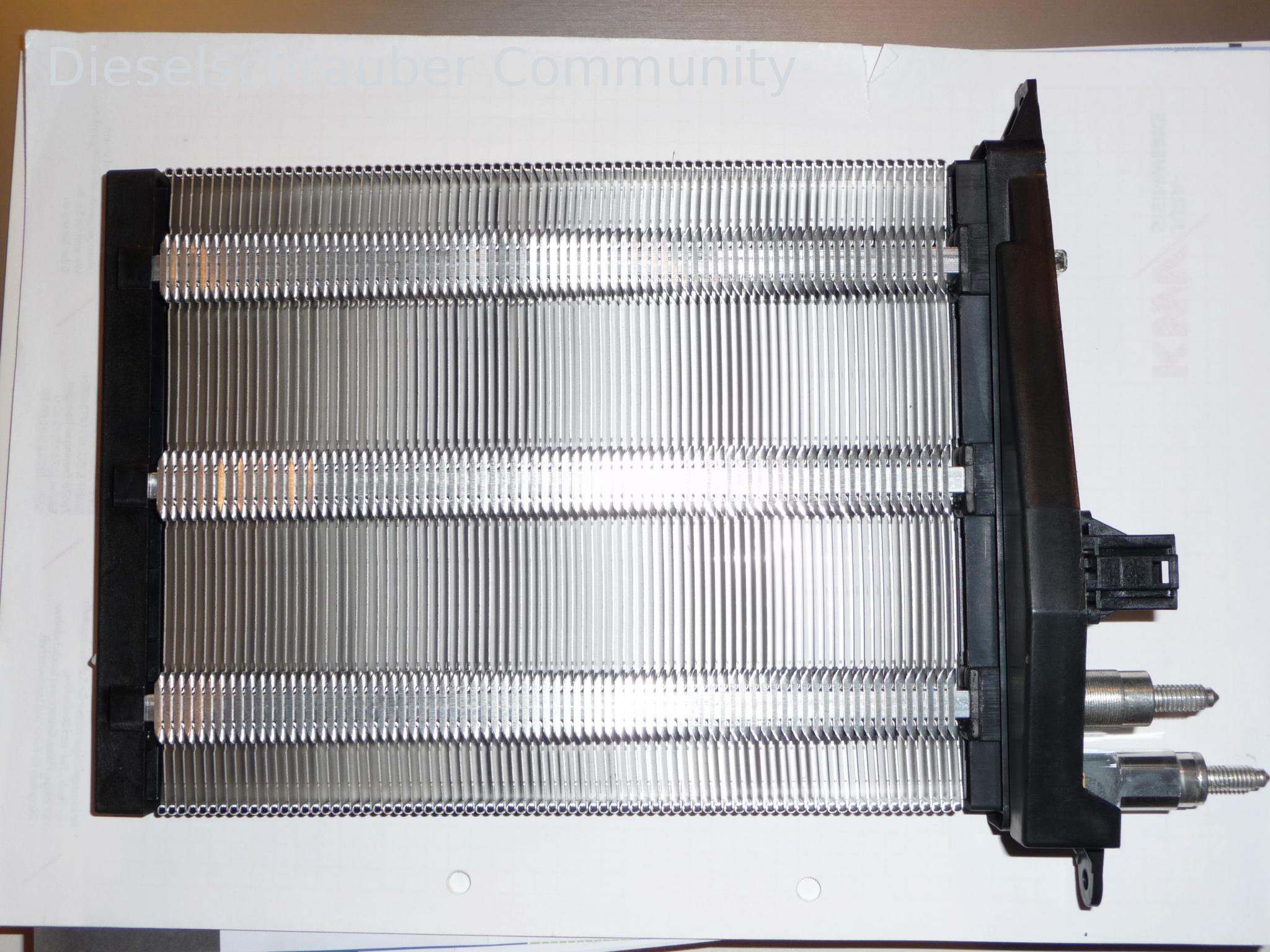

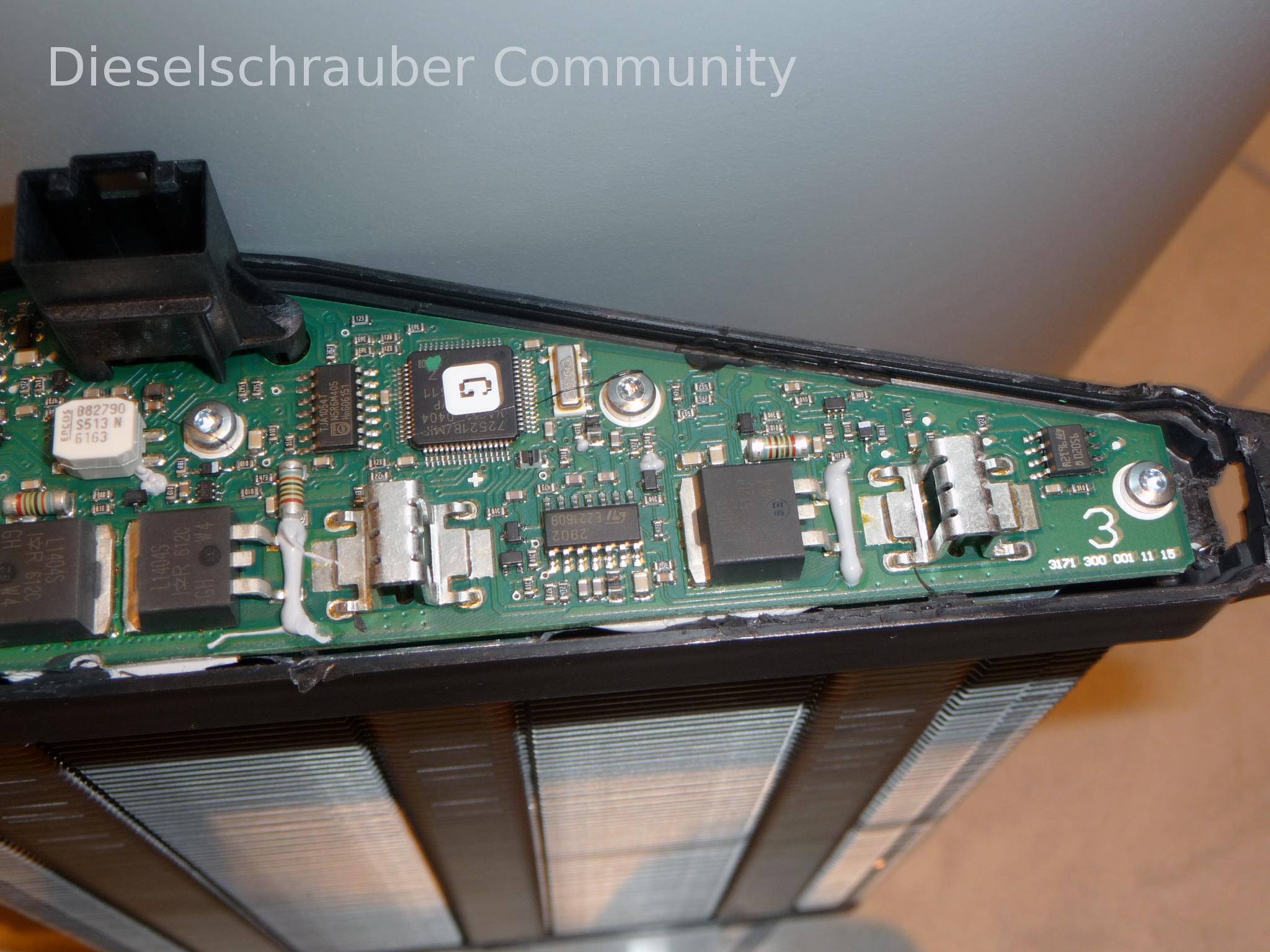

Unfortunately, there is no visible direct damage (such as a scorched component or similar).
Well, let's start with some chip identification and gradually get used to the idea of spending 305 euros...
 Kaum, dass man Haltegriffe, Aschenbecher, Verkleidung der Schaltkulisse, die komplette Mittelkonsole, die untere fahrerseitige Armaturenverkleidung und eine LuftfĂŒhrung entfernt hat, kann man das blöde Teil auch mal erblicken:
 File size:  3.43 MB
 Viewed:  11235 times
 Dann muss man nur noch unter WĂ€rmeeinwirkung und Dauerverformung zweier Kunststoffnasen das verklebte GehĂ€use öffnen und sieht das:
 File size:  3.26 MB
 Viewed:  27039 times

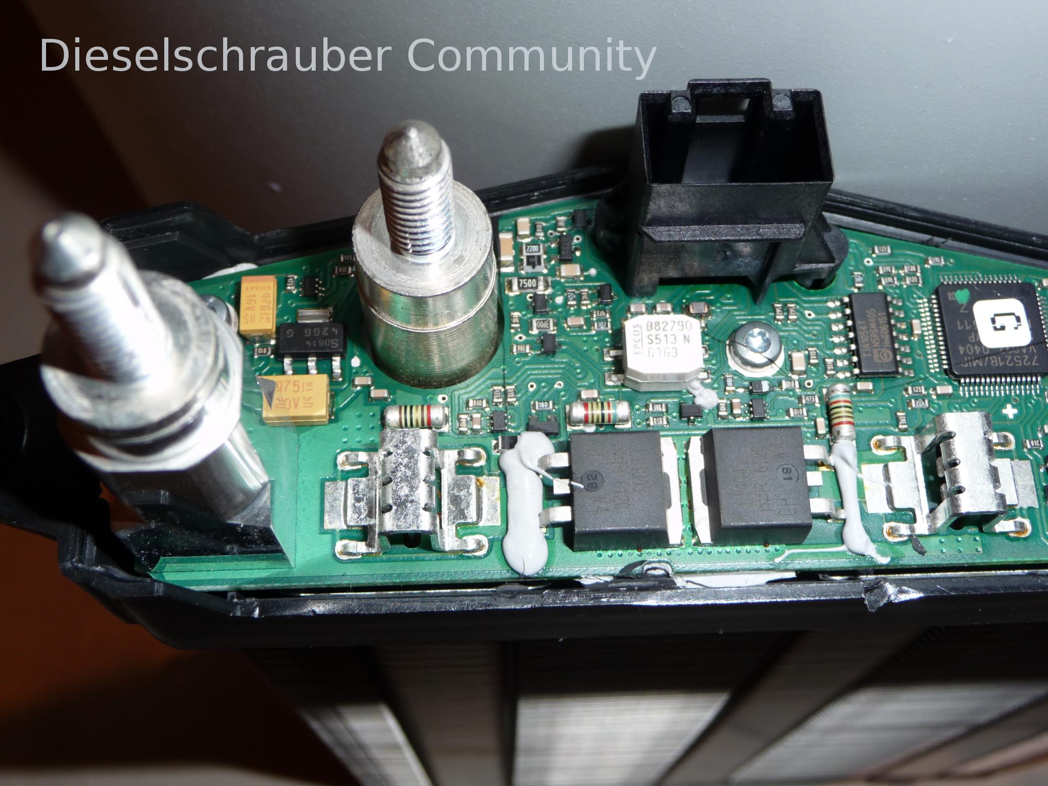

 Elektrischer Zuheizer
 File size:  3.39 MB
 Viewed:  14140 times

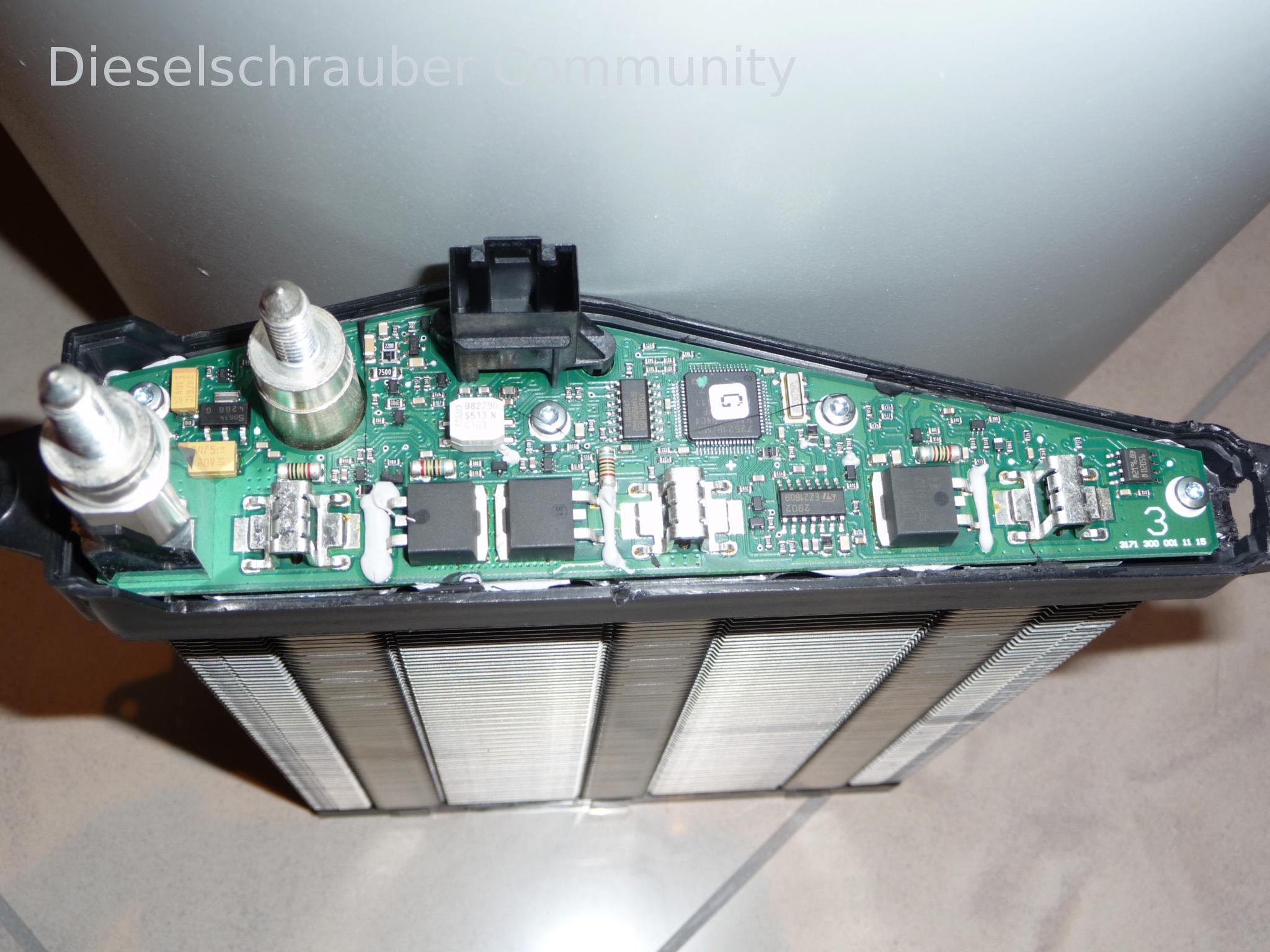

 File size:  3.51 MB
 Viewed:  14503 times

Did you only expand it because of the error? icon_rolleyes.gif Or did it not get warm inside anymore?
reflexsilber met.
pschaefer
Joined: 08/21/2002
Posts: 300
Post27-11-2011, 21:46    Subject: 7D - Auxiliary heater malfunction Quote
RedR32 wrote:
Did you only take it apart because of the error?icon_rolleyes.gif Or did it stop getting warm inside?
The latter. I've been wondering for a while now that it sometimes gets quite warm very quickly, and other times it takes forever. I hadn't even thought about the auxiliary heater. I only noticed the error after replacing the battery, when I was trying to clear the usual error codes, and it was stuck at code 7D.
The inconsistent behavior could also be due to the already weak old battery, as the auxiliary heater is controlled in a rather "unintelligent" way.
Removing the trim pieces is a pain, but I'm used to it; this isn't the first time icon_biggrin.gif. I'm just annoyed that this process is much easier on the sister model, the Golf, but on the A3, you always have to remove everything. Actually, I should also replace some of the climate control actuators because some of them are constantly ticking (a known problem; there are updated versions available). But for that, much more needs to be... icon_wink.gif
Basically, I'm just curious... Now I'm going to take a closer look at the circuit board (checking for hairline cracks, temperature issues, etc.). The heater itself is quickly installed or removed; the car also runs without the cover parts icon_wink.gif ...
*Die Fahrbahn ist ein graues Band, weisse Streifen, grĂŒner Rand*

Thanks for the tip. Yes, when I contacted the seller, he wanted to know the chassis number (even though I had only inquired about the "E" version mentioned above...). Audi probably switched to relays in the A3 at some point as well.
Under [url][/url] or [url][/url], you can see the whole range. The STG variant is the "top"-of-the-line model... icon_confused.gif
Currently, I've ordered some Power MOSFETs (they only cost 4.50 EUR). If replacing the MOSFETs doesn't solve the problem, I'm considering the relay option, although I would need to figure out a) who will drive the relays and b) how to securely attach the rather thick cables to the PTC elements without the car potentially catching fire icon_biggrin.gif.
guste100 wrote:
I don't know if anything else needs to be coded.
Okay, in the CAN gateway, "7D" needs to be disabled. That would also be my Plan C: simply deactivating the heater – I've already removed the 100A fuse in the engine compartment.http://www.beru.com/de/produkte/elektronik-und-sensorik/heizelemente-ptc{MARKER}http://www.beru.com/download/produkte/prospekt_ptc-neue-generation_de.pdf{MARKER}

Brief feedback... It wasn't the MOSFETs.
Desoldering the components was a risky endeavor, as the circuit board is glued to the metallic base with thermally conductive adhesive, and even with significant heating, it is very reluctant to detach. However, desoldering is impossible without doing so, as the metal acts as an excellent heat sink. After replacing the MOSFETs, the same problem persisted, as indicated by VCDS. Furthermore, the thermal resistance is likely significantly higher than before due to the action taken (obviously: there's not enough solder under the MOSFET, and the thermal paste also needs to be replaced), so I'm not going to risk running the device.
End result: Disassembled. Opening with blind cover closed. Disconnected from the CAN gateway.
