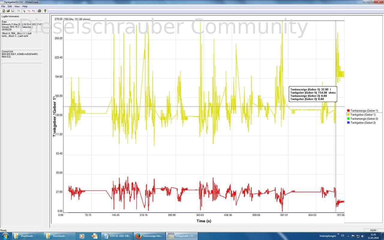

Okay, so, I just ran a log.
Unfortunately, it is only mildly informative, as I first had to find the correct MWB (I initially searched for the engine electronics before finding the KI).
Therefore, the effect is not so extreme, but I was wondering if that trend is sufficient on its own.
Attached is the log from the fuel sender and display. At the beginning and end, I was in the same, level position. Within the 8-9 minute driving time with very few kilometers (I estimate 3-4), the sender value increased by 5 Ohms (from 144 to 149), which caused the display to drop from 32L to 30L - note that this happened after the ignition had been on for several minutes and the effect was not fully realized.
Would that be sufficient for you to see Tankgeber as the culprit and replace them, or would AI still be an option for you?

The log abruptly stops, just unplug it?
Around 705s, the average of the transmitters changes in the log, previously it remained approximately the same. Was, is that car parked that way?
Since the average had remained roughly the same, nothing should change on the fuel gauge needle either.
Best regards, Rainer

Hello Rainer!
Thank you for the response!
It was my first log, so I may not have finished it correctly. I pressed the "Stop" button when I was finished, then closed the program and unplugged it.
Did I miss a step?
Exactly, the car was parked at the end in a double parking space, with the front facing downwards. Therefore, the average value changes.
I will try again this evening and hope that the values will be more distinct if I log the correct cutting value directly after ignition.

Possible, that it was difficult in certain positions, but what happened in the log starting at second 705? If the input would be constant at a certain point, then the output would also be constant.
As mentioned before, the average remains approximately the same.
| Back to top |
Profile PM WWW Garage |
Florian320
Joined: 04/30/2016 Posts: 100 Karma: +17 / -0
2004 Audi Cabriolet Premium Support
11-05-2016, 12:11 Subject: Fuel gauge not working - A4 Cabrio 2.5TDI (BDG) |
Quote |
From second 705, I drove into my double parking space.
Just before, I was standing there, briefly checking the value (which was also quite stable), then I drove into the double parking space (with the front facing down) and looked at the value there for a few more seconds.
Therefore, the average is different there.
