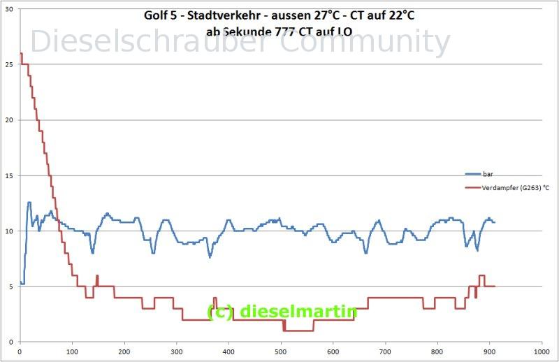

Unfortunately, there's no log data, but I still have an empirical value from the G IV, where I often observed the vaporization temperature:
Even with an outside temperature of 35°C, the evaporator temperature quickly rose to 2.5-3 degrees within 10 minutes and remained there. The setpoint was 22°C. Cold start followed by... Highway driving: 90-130 km/h.

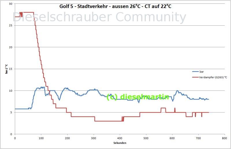

Post12-08-2015, 12:26    Subject: DataLog Air Conditioner Quote
Is there anyone who ever logs data on the climate? Martin is actually a master of data logging.
Martin is also a "master of going to France" icon_wink.gif.

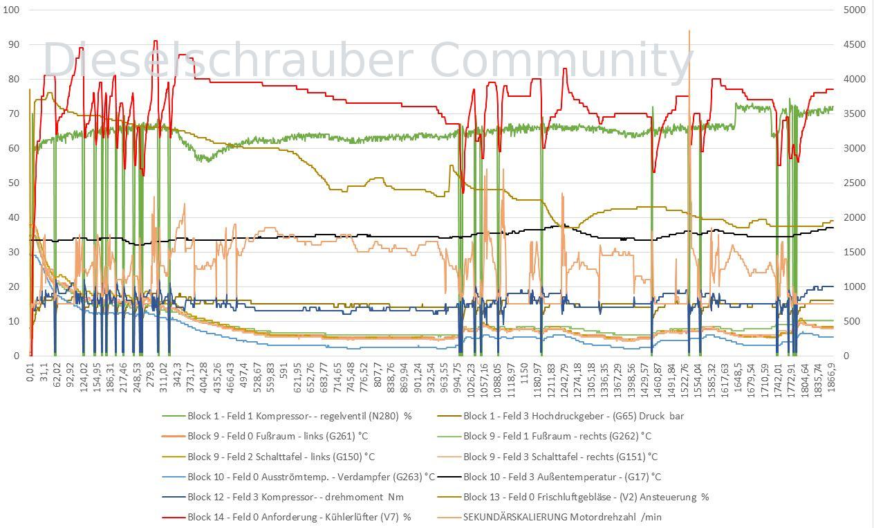

Post12-08-2015, 18:46    Subject: DataLog Air Conditioner Quote
Thank you for the additional logs!
I find it interesting that in Martin's logs, the temperature at the evaporator drops to below 5°C within 120 seconds. For me, it takes at least 460 seconds (though this is under 33.5°C and in direct sunlight). The minimum temperature afterwards is approximately 2°C. The compressor remains at its maximum operating level throughout the entire duration.
