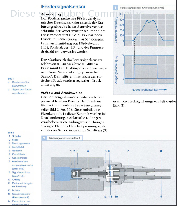

 VP37 Cable Screw: Alternative to Hex Head Screw

Okay, that's quite an answer. Very cool, thank you!
A friend, who's a toolmaker, made a custom tool for me, and then the old O-ring popped out.

What is the purpose of the conveyor signal sensor? Determining the start of the conveyor, the conveyor duration, and the pump speed seems unnecessary.
This doesn't change the injection control system, as the engine speed and NHG signal are available, and the injection duration is quantity-controlled.

My Screenshot shows that such a thing exists and what it does.
..but I have never seen this myself on a VW-Audi vehicle, and I can't find any information about its use depending on the model icon_eek.gif.
