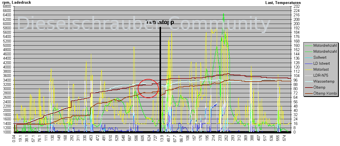

05-01-2018, 20:39 Subject: Full throttle only when the oil is warm? |
Quote |
Hello again (it's been a while).
To gather more data on the topic, I conducted tests during a roughly 20-minute drive, including... I've extracted log data on water temperature and two different mold temperatures from the MSG, and I wanted to share it with you.
I'm not entirely sure how the two melting temperatures are measured or calculated in detail.
The Polo with the older EA113 engine has an oil pan sensor, but AFAIK it doesn't have any other oil temperature sensors. The log data labeled "Oil Temp Combined" shows -59°C for a short time after the engine starts, possibly while the oil level is being measured. Otherwise, they roughly correspond to the AI display, which only shows "---" when the temperature is below 50°C.
The dips in the log data represent short periods of minimal engine load, during which I didn't expect any significant oil temperature increase.
After the gas station stop, we got onto the highway, with a brief period of speeding.
It seems that the higher "oil temperature" reading, up to 83°C, is rigidly derived from the water temperature. Furthermore, the two melt temperatures seem to be somehow linked, as indicated by the small, parallel depressions shown in the red circle.
Does anyone have any ideas about what the MSG is doing with the higher "oil temperature" value?

I'm familiar with the issue of the calculated temperature from the temperature sensor on the air compressor in the Allroad.
If the temperature sensor on the compressor is defective or, for example, simply forgotten to be reattached, the compressor will overheat and be damaged.
The first temperature is the calculated value, which is always closer to the "threshold" than the actual temperature. This is to allow for intervention in case of a sensor malfunction.

ulf wrote: | ...
What to expect, taking into account your engine's cooling system.
The oil temperature is being measured, and it should be reasonably accurate.
The oil temperature on the combination instrument is either calculated or measured by a separate temperature sensor. It should (if present) be located near the oil filter.
Your engine should have what's called a water-to-oil heat exchanger. This pre-warms the oil to approximately 80-90°C, and then the process reverses. After that, the oil is cooled by the water.
I am sorry, I cannot access external websites, including the one you provided. Therefore, I cannot translate the text from the given URL.
Therefore, I almost suspect that there is a second donor.
Alternatively, a fictitious temperature can be calculated based on the motor's load profile and (known) temperature model. I'm familiar with that from newer engines, but I can't confirm whether yours is one of them  .
Quote: |
Does anyone have an idea what the MSG is doing with the higher "oil temperature" value? |
What do you mean by that?
At the very least, this method calculates the effective (i.e., actual) motor load.

Bertil wrote: | | The oil temperature is measured and should be largely accurate. | Which of the two log values are you referring to? "Oil Temp" or "Oil Temp Combo"?
Quote: | | The oil temperature on the combination instrument is either calculated or measured by a second temperature sensor. This | should be located near the oil filter or in its vicinity. In the wiring diagrams, I cannot find an oil temperature sensor other than the one located in the oil pan.
Yes, the heat exchanger is installed.
Quote: | | Therefore, I almost suspect that there is a second donor. | As I said, the SLP results do not show a second donor. Furthermore, it seems unlikely that two sensors at different locations would provide such strikingly synchronous readings of real values, considering factors like "slow creep heat" within the solid materials of the engine block, heat exchanger, etc.
Quote: | Alternatively, a fictitious temperature is calculated based on the load profile and the (known) temperature model of the motor. I'm familiar with that from newer engines, but I can't confirm whether yours is one of them  | . That would be my guess.
Quote: | Quote: | | Does anyone have an idea what the MSG is doing with the higher "oil temperature" value? |
What do you mean by that? | What the MSG uses this value for.
Quote: | | At the very least, this calculates the effective (i.e., actual) engine load. | What I understand as engine load (= the yellow line in the log image) is mainly calculated from air mass and engine speed. I know of several MED9.1 "tuner" setups with "modified" intake manifolds where the mass airflow sensor (MAF) provides significantly incorrect values - this is noticeable in the relationship between the actual values of air mass and boost pressure: in these cases, the engine load log data is also shifted accordingly based on the air mass, see, for example, https://turbolochblog.wordpress.com/2017/11/13/bosch-luftmassenmesser-hfm-6-vag-2-0-tfsi/.

ulf wrote: | Which of the two boolean values are you referring to? "OilTemp" or "OilTemp Combo"?
Oil temperature!
Quote: | As I said, the SLP images do not show a second donor.
Okay, that might be possible.
Sure...
One is the temperature in the oil pan, and the other is the oil temperature at the oil filter or somewhere freely in the oil circuit.
The oil sump needs to react much more quickly to changes in load.
That's at least how it is with my Jetta. I have one sensor in the oil pan and one on the oil filter housing. With the sensor on the oil filter housing, you can practically feel every sudden change in engine load immediately through the temperature, while with the sensor in the oil pan, it takes a little longer for the load to be reflected in the oil temperature. In this case, only a longer change in load is noticeable in the oil sump.
In the Jetta, no computer alters the display of the oil temperature  .
If you know the engine's temperature model, you can calculate one of the two oil temperatures based on the engine load.
"In your Polo, all input parameters are recorded by the computer using sensors. In my Jetta, I just pour fuel in using a 'watering can'. Air mass?" No matter what, just put in the fuel.
Quote: | ... That would be my guess.
That's definitely possible. That's what people do these days.
Quote: | What the MSG uses this value for.
I'm sorry, I don't understand. Can you please rephrase your request?
Quote: | | What I understand as "motor load" (= the yellow line in the log image) is mainly calculated from air mass and engine speed. I know of several MED9.1 "tuner" setups with "modified" intake manifolds where the mass airflow sensor (MAF) only provides significantly incorrect values - this is noticeable in the relationship between the logged values of air mass and boost pressure: in these cases, the motor load log data, based on the air mass, is also shifted accordingly, see, for example, https://turbolochblog.wordpress.com/2017/11/13/bosch-luftmassenmesser-hfm-6-vag-2-0-tfsi/ |
Ah... Now ...
While you can calculate the motor load from LM and n, you should definitely check it for plausibility. You can often tell a lot about it by checking the oil temperature.
You can also use it to calculate a load profile. That would be necessary, for example, for the LL service display (which I don't think your Polo has).
So, if someone starts the engine and immediately puts it under full load, that's a different stress profile compared to someone who gradually warms up the engine.
You cannot derive this statement from LM and n, but you can derive it (among other things) from the rate of change of the oil temperature.
