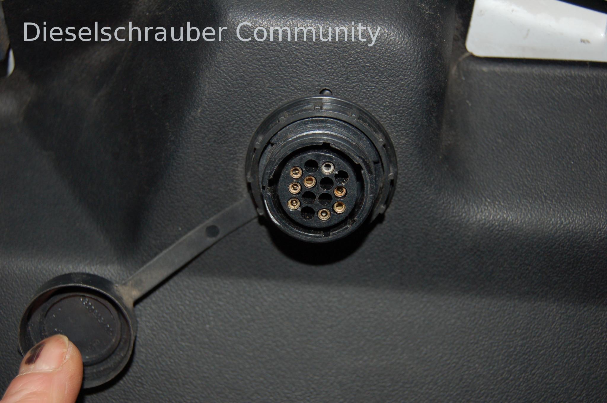

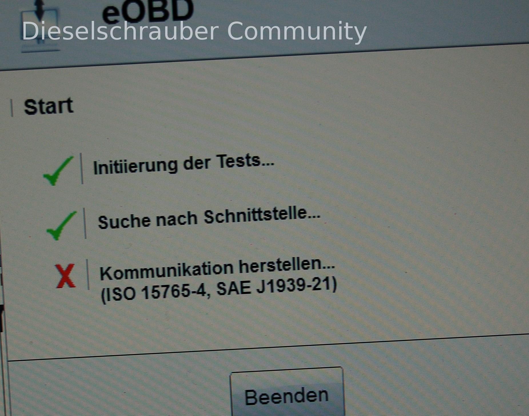

Looking for OBD scanners for commercial vehicles.
My current device works perfectly in passenger cars and vans. However, it cannot extract any signals from older vehicles with 16-pin round connectors, such as Mercedes-Benz models. The current device fails to establish communication.
ISO 15765-4, SAE J1939-21.
Now, we need something else, and it needs to be quick and easy.

It's obviously a guess if you don't know which vehicles it's for, but there are round OBD-14 pin adapters available.

Hey Diesel mechanics & Herbert!
First, a word to Herbert: If things were that simple with the 16-pin connector! After extensive research and numerous inquiries to dealers, I've had no results so far. The offers I've received always refer to MB Sprinter vehicles, which isn't helpful to me. I once stripped the cable and insulation from one of my adapters and found 4 wires inside. There are 8 wires connected in the socket. According to SAE J1939, it should be possible to transmit data (in heavy-duty vehicles), but I don't think my MB 814 Vario is equipped for that.
You're tired of days slipping through your fingers, and even your patience is running out.
Sure, here's the translation:
"Hey, diesel mechanics!"
It's a MB 814 D Vario model from 2001.

Hello, diesel mechanics!
The Delphi 2015.3 program.
Protocol specifications: ISO 9141-2/11898-2/14230-4/15031/15765-4.
SAE J 1850 / J 1939 / J 1979 / J 2411
So far, I haven't had anything negative to say about the Delphi 150 e; it has been working perfectly.

The corresponding multiplexer for the MB 815 in the Texa diagnostic system is: part number 3903429, "Mercedes Benz cable for vehicles Euro 2 and Euro 3 (3151/T09A)." It costs approximately 118 EUR, but the delivery time is about 2+ weeks, as I do not have it in stock.
