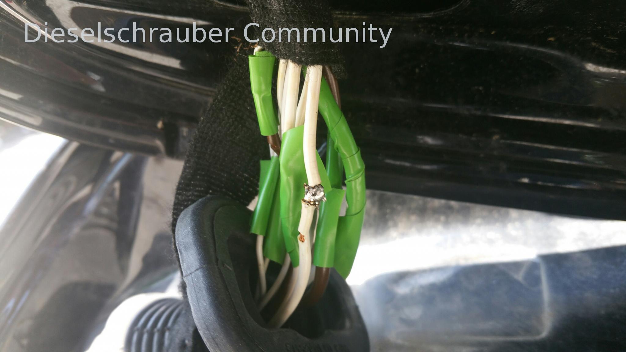

Post23-04-2018, 19:45    Subject: Non-Working Rear Wiper (Golf 5, 1K1) Quote
Hello!
Have you ever thought about something like that? That's usually the first thing people check.

Post24-04-2018, 17:44    Subject: Non-Working Rear Wiper (Golf 5, 1K1) Quote
Hi Steffen G.: I haven't even damaged the protective sleeve yet. And that's how it should stay for now. If no signals are reaching the motor, I can always rip the sleeve out.
BTW: What model is this photo of? It seems to be missing the rear window defroster and the third brake light, right???

Post24-04-2018, 19:32    Subject: Non-Working Rear Wiper (Golf 5, 1K1) Quote
Hi!
This is from my Golf 4.
On the left side, inside the connector, there were significantly more cables, and many of them were broken or had their insulation peeling off. There were also short circuits between the cables. It was a real mess of cables.
I don't have a picture of the left side, otherwise I would have posted it.
Just loosen one end of the connector, push the wires together, and take a look at the cables. You can easily reinsert them if needed.
I'm not sure about the Golf 5, but it will probably be similar.
It's actually a well-known problem. When I worked there 25 years ago, I almost exclusively repaired Volkswagen Golfs (specifically the Mk2 model), and this was a very common issue. We would sometimes try to fix it temporarily, but the next time, we would usually replace the entire wiring harness.
GrĂŒĂŸe, Steffen!

Post27-05-2018, 12:46    Subject: Debt Repayment: I Still Owe... Quote
..namely, the solution: It was indeed the wiring harness, specifically the left one. After finally finding the time and opportunity, and the weather being suitable, I removed the grommet and was quite dismayed. All the cables (except for a few thin ones) showed damage, and one was torn. I would say the insulation is of poor quality. Considering the trunk isn't opened and closed every day, I find that quite strange. I've temporarily fixed it for now and will see where I can get a replacement wiring harness, or where the connectors are located so I can potentially assemble one myself. Attached is a photo of the "horror show."
Best regards, Styrian.
