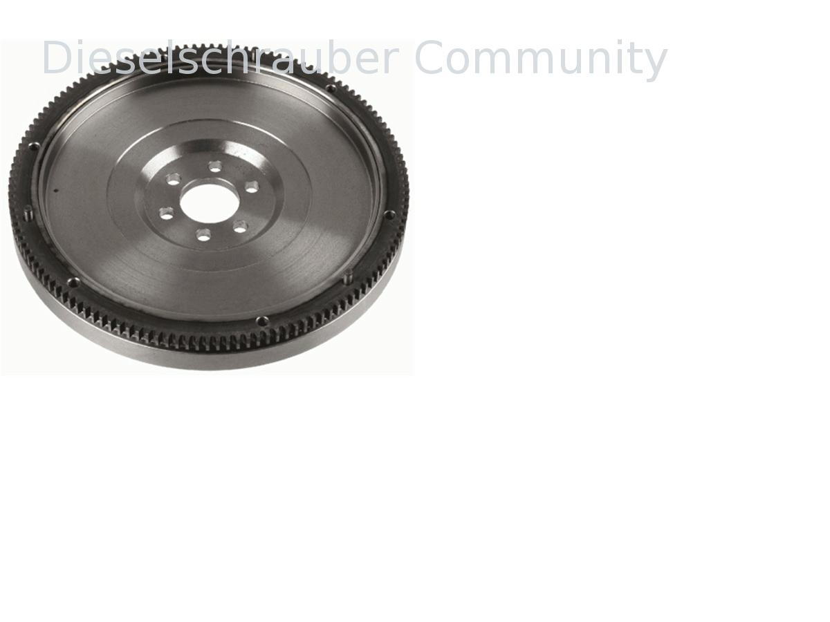

Post10-06-2018, 15:18    Subject: Skoda Fabia TDI: Rough Engine Idle (1000-1500 RPM) Quote
Yes, that's correct. The question is valid.
For the Fabia from TE, it comes with an EMS (Engine Management System) as standard, with the part number mentioned above. Sachs also offers a similar unit with the part number 3021 600 294.
I used partslink24 to find the information and sent the original poster screenshots and the complete list of part numbers (including those not listed on the sticker in the service booklet) for the car via private message.
It's about a specific vehicle, so that's why I didn't make it public. Here's a picture of the flywheel.
