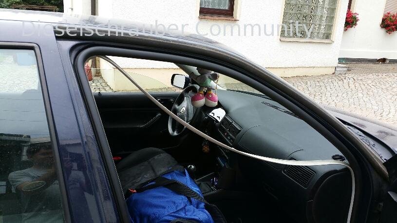

Hello!
A trim piece has come off my 20-year-old Golf 4 due to the recent hot weather.
Specifically, it's located inside the car, above the passenger-side door, and therefore has the same color as the car's headliner.
I'm going to try right now to see if I can upload the image from my phone.
So, the strip is apparently glued to the rubber seal on the door, although I couldn't detect any adhesive residue.
Door seals are typically made of rubber or EPDM.
The strip is on the side that needs to be glued, I think, and it's probably PVC.
I've already tried gluing things together three times.
With the adhesives available.
The first attempt used ordinary office glue, and that just didn't work.
The second attempt was with a type of adhesive similar to contact cement, but I only used a small piece to test it, and it didn't work at all.
Yesterday, I removed the adhesive residue and then glued it back on using spray adhesive, which is actually intended for this type of thing.
Of course, spray it into a small container, apply it with the brush on both sides, and let it dry. Follow the instructions carefully.
It looked good and it also lasted. Then I thought, it's okay.
However, today, in the full sun, the stripe came down again  .
Does anyone have any ideas about what kind of adhesive I should use?

Yes, IsoProQ. I used that to glue the headliner in my Audi 80. According to the data sheet, it holds up to 120°C, it's suitable for painting, and – most importantly – it actually held.
Common adhesives hold up to 90°C. Of course, any old residue needs to be removed.

08-08-2018, 21:58 Subject: Image: [Beschreibung des Bildes] |
Quote |
Trim.

Are you sure that's not a profile that's being held in a groove or something similar?
Translated on 30-09-2026, 18:50.
| Back to top |
Profile PM |
Steffen G Profi-Schrauber
Joined: 10/26/2006 Posts: 2560 Karma: +590 / -0 Location: bei Zwickau
08-08-2018, 23:37 Subject: Plastic Adhesive for Interior Car Parts |
Quote |
Hello!
Yes, I am. Of course, I've looked at the other side.
The top part is inserted into a slot, and the bottom part, near the dashboard, is inserted into the door seal. There's nothing in between to clip or attach anything to.
I had already glued it on before, and it looked neat then, just like the original.
But unfortunately, it didn't stay up for long... until it came down again.
Yes, I need to see if I can get the adhesive you recommended. Or something similar.
Sure, no problem! Here's the translation:
"Thank you in advance!"
Translated on 30-09-2026, 18:51.

There are heat-resistant spray adhesives, but the maximum temperature they can withstand is often only listed on the corresponding data sheet, not on the can itself.

Possibly, this contact adhesive might be helpful: http://www.sabakleber.de/12.html

"For things like that, I use spray adhesive from Tesa. It's important to follow the drying times, and if possible, spray both sides."

[Translating...] Hallo!
Danke schon mal für die hilfreichen Antworten.
Ehe ich den Wert meines Auto´s durch den Kauf einer Dose Kleber verdoppele,
hab ich gestern nochmal auf das im Haushalt vorhandene zurückgegriffen.
In der Schreibtischschublade von meinem Vater hab ich zufällig eine 20 g Tube Pattex- Repair-Extreme gefunden.
Da war abgebildet, wie man eine abgelöste Schuhsohle anklebt.
Einseitig auftragen, andrücken und anpressen, für 24 Stunden.
Irgendwie hatte ich keine Lust, die Klebereste der beiden vorherigen Versuche zu entfernen, was sich ja auch sehr mühsam gestalten würde,
also drauf das Zeug auf die Gummileiste, immer 10 cm, und mit großen Wäscheklammern fixiert.
Ich hab da letztendlich 20 Wäscheklammern benutzt, und bin wegen der 24 Stunden Wartezeit heute extra mit dem T4 auf Arbeit gefahren.
Heute Nachmittag gleich mal nachgesehen, die Klammern abgemacht, sieht ganz gut aus. Scheint zu halten, ich hab auch mal vorsichtig gezogen.
Beim letzten Versuch hab ich das aber auch gedacht.
Und da hat es nicht gehalten.
Na, mal sehen, was morgen passiert. Da nehme ich den Golf auch wieder zur Arbeit, der steht da auch ab mittag mit der Seite in der vollen Sonne,
ich werde berichten, wenn die Leiste wieder runterfällt.
Und dann auf eure geschätzten Vorschläge zurückgreifen.

[Translating...] Pattex repair extreme kann ich empfehlen, habe damit die sich ablösende Sohle meines Turnschuhs angeklebt, hält bis jetzt, anders als das sonstige Zeug das ich ausprobiert hatte.

[Translating...] Hi!
Also die Leiste ist noch fest dran.
Den Hitzetest auf dem Parkplatz bie mir auf Arbeit hat der Kleber auch bestanden.
Komisch ist nachträglich betrachtet,
es waren, als die Leiste runtergefallen ist, keinerlei Klebstoffreste zu erkennen.
Als hätte sich das in der Luft aufgelöst...
