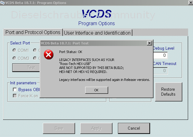

dieselschrauber wrote:
Try using the latest beta version of VCDS.
http://www.ross-tech.com/vcds/download/beta/current.php
Hi Rainer,
"The beta doesn't like my interface."
 Steering Wheel Position VW Polo 6R
 File size:  56.18 KB
 Viewed:  605 times
Translated on 29-07-2026, 4:31.
Posts: 18113
Post24-08-2018, 17:19    Subject: Steering Wheel Position VW Polo 6R Quote
icon_confused.gif Okay... that's a shame, then all that's left is to wait for the next release....
