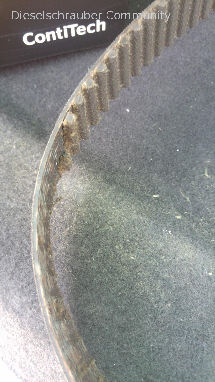

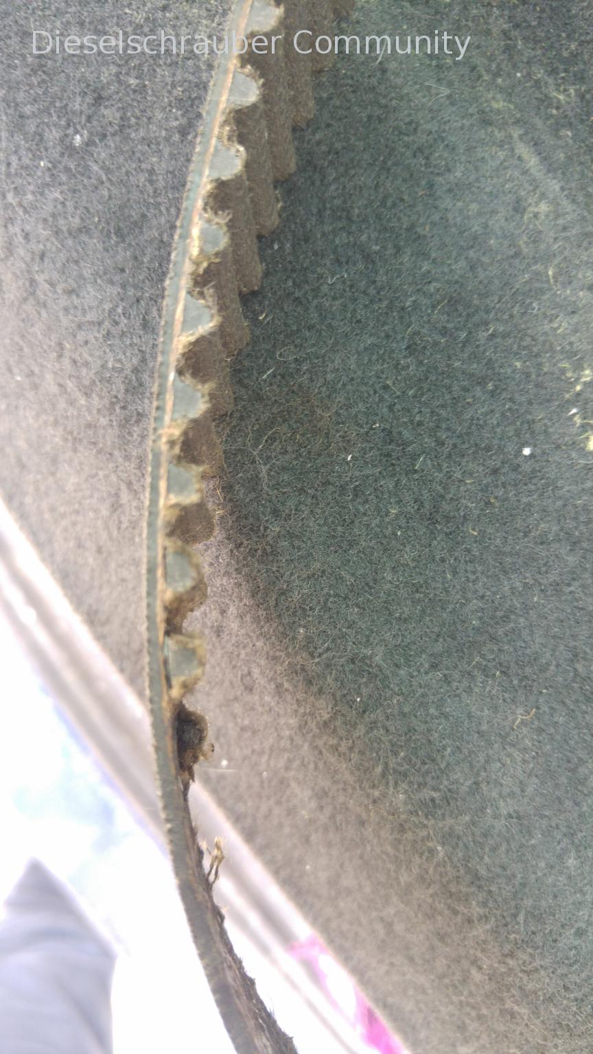

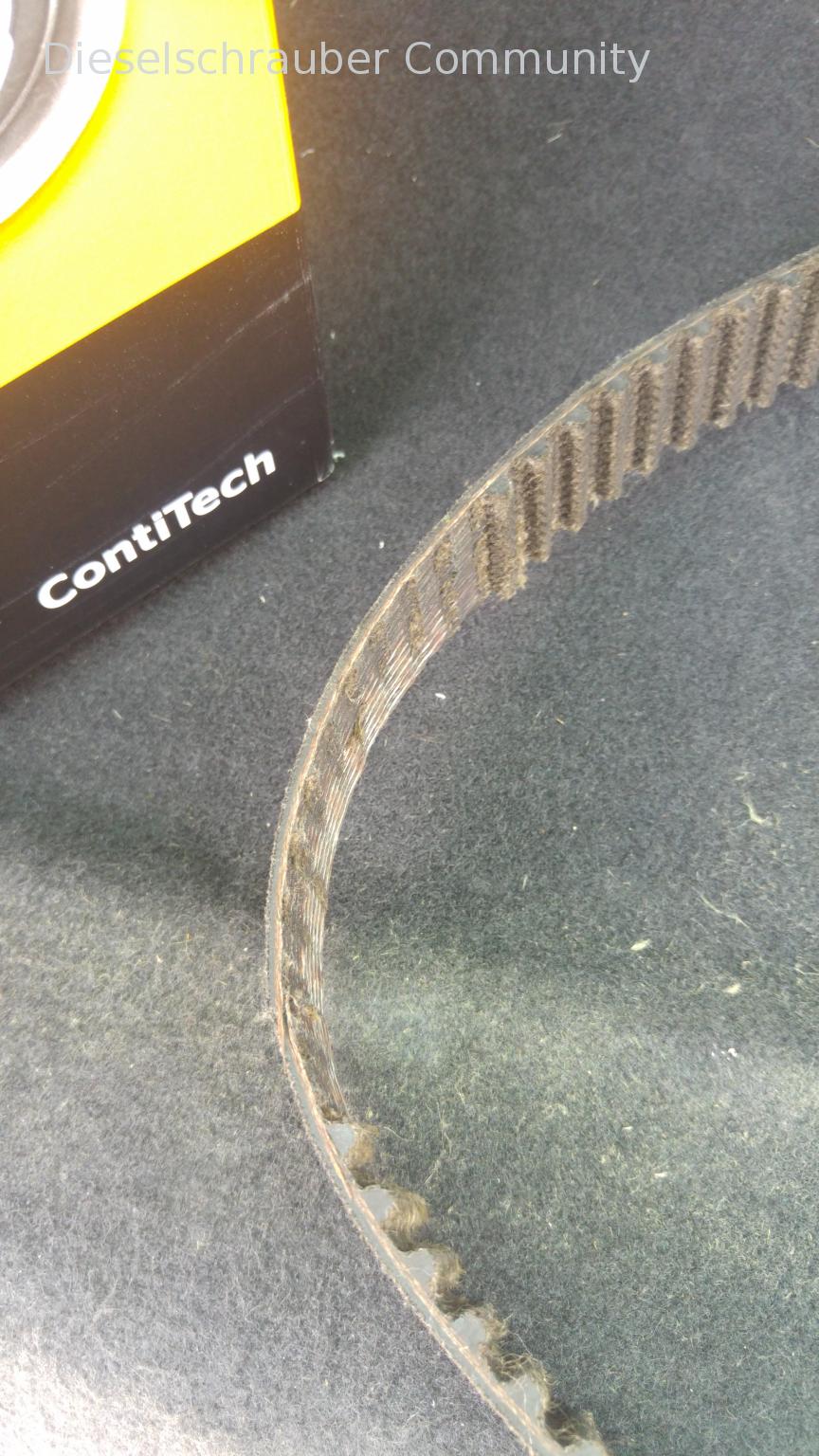

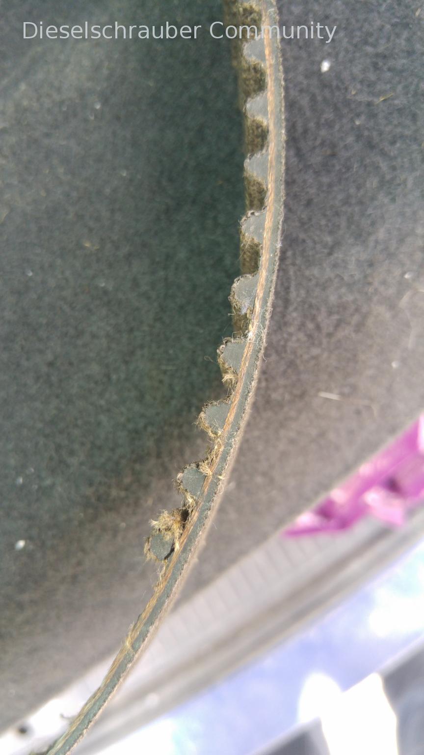

Vehicle: Golf V with BKC engine, purchased at approximately 123,000 km, belt reportedly replaced at around 120,000 km in late 2012.
Around 200,000 km (November 2015), the belt had lost 10 teeth and was misaligned by 2 teeth. New belt installed, and the car was running again.
Around 237,000 km (March 2018), same again, both times were Continental belts, this time the water pump was replaced, the old water pump looked okay, otherwise I couldn't see anything visually. Okay, so: Belt replaced, new water pump installed, and thankfully, it's running like new again.
The driving situation was exactly the same both times. The highway was moving at a good speed for a while, then I slowed down to around 120 km/h and then accelerated again, but suddenly there was a loss of power until it completely died and stalled. The first time it happened, I had to have it towed. The second time it happened, it happened just before I got home, and I was able to limp home with the timing adjusted.
What could be causing the car to chew on its tires? Wagen has recently received different software, around 156,000 km. Here, I see less of a reason, as I have never heard of this in connection with performance improvement.
Additionally, he sometimes needs a little water if he has been used. However, the cause was not found. Two years ago, it was more, and he had harder head bolts from the ARL motor, which reduced the consumption. The problem was then solved three months later with the use of bar's leak (in a cleaned and rinsed cooling system).
The belts appeared dry visually, and no oil was apparent. But essentially, all teeth have similar patterns.

[Translating...]Moin
Hast du wirklich nur den Riemen gewechselt?
Die ZĂ€hne auf der Umlenkrolle oder dem Spanner können dermassen eingelaufen sein das der Riemen einem ĂŒbermĂ€ssigen Verschleiss unterliegt.
Ich hatte mal einen Passat wo der Riemen rund 1 Monat gehalten hat, zum GlĂŒck wars ein FreilĂ€ufer.
Nach dem 3. Riemenwechsel hab ich dann alles was Zahnrad heisst mitgetauscht und dann war Ruhe.
MfG Frank

die Umlenkrolle und die Spannerrolle sollten eigentlich keine ZĂ€hne haben? Darauf lĂ€uft der Riemen mit dem RĂŒcken.
NW-Rad, KW-Rad und Wasserpumpenrad gehören natĂŒrlich kontrolliert.
Wurde der Riemen draufgewĂŒrgt? Oder billig gekauft? Ansonsten bleibt als Ursache nur die Blockade der NW oder der Pumpe.

Hi. Also Spannrolle und Umlenker wurden jedes Mal mit gewechselt. An KW- und NW-Rad war so direkt nix zu sehen.
Kann denn die Pumpe bei voller Fahrt blockieren? Bzw. die KW welche aufgrund kleinerer AuflageflĂ€che eher die Kraft hĂ€tte da ZĂ€hne auszureißen.
Wie kann man das jeweils prĂŒfen?
Die Riemen waren jeweils vom örtlichen HÀndler der auch AutohÀuser beliefert.

[Translating...]Einen richtig fachlichen Rat kann ich dir nicht geben, aber wenn das jetzt mein Wagen wĂ€re, wĂŒrde ich mir mal das Zahnrad an der Kurbelwelle etwas sehr genau anschauen.
Mir erscheint dieses Rad vom Material her immer weicher, als das Rad auf der Nockenwelle. ( Ich kann mich auch irren )
Es könnte also verschlissen sein, obwohl sowas sehr selten sein sollte bzw. fast unmöglich.
Diesen Fall hatte ich aber schonmal..
Oder jemand hat mal das Rad getauscht und es hat nicht die gleiche Zahnstruktur.
Das mal eine Wasserpumpe blockieren kann, halte ich fĂŒr möglich.
Aber es ist meiner Ansicht nach unmöglich das die Wapu danach fehler und spielfrei weiter lÀuft.
MfG Frank

[Translating...]Wenn ich mir nochmal die Bilder von deinem Zahnriemen anschaue, dann sehen die ZÀhne aus wie verschlissen und nicht so als ob was blockiert hÀtte.
MfG Frank

Hier wurden mehrere ZĂ€hne nebeneinander richtig weggefrĂ€st, die LĂ€nge paßt zur AuflagelĂ€nge des ZR auf dem KW Stirnrad.
Es ist bei dem Bild kaum vorstellbar, daß sich die Nockenwelle nicht so verstellt hat, daß Ventile und Kolben Kontakt hatten, vor allem wenn der Motor dann noch weiterlief.
Wahrscheinlich ist genau das schon beim ersten Schaden passiert, mit verbogenen Ventilen, und in der Folge kommt es immer wieder zu Klemmern und Überbeanspruchung des ZR.
Ohne PrĂŒfung des Zylinderkopfes kommt hier nichts Sinnvolles mehr raus.
