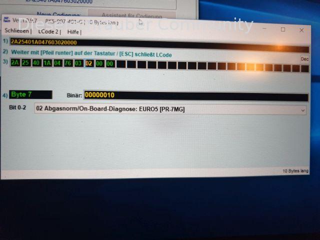

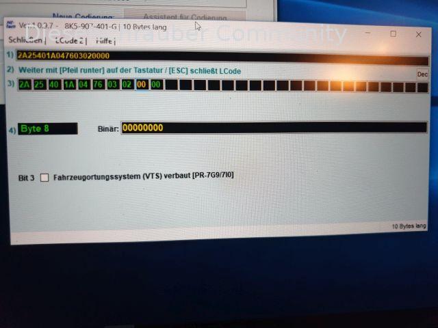

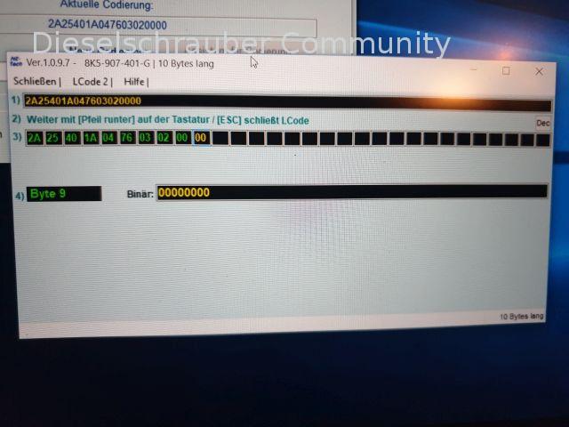

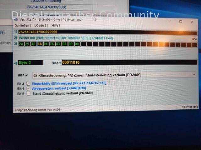

Post23-10-2019, 13:08    Subject: Coding Quote
Hello Rainer,
You're very welcome for the quick response.

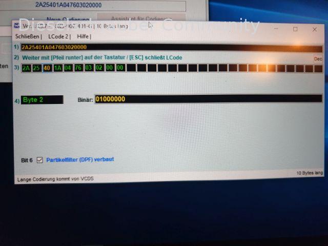

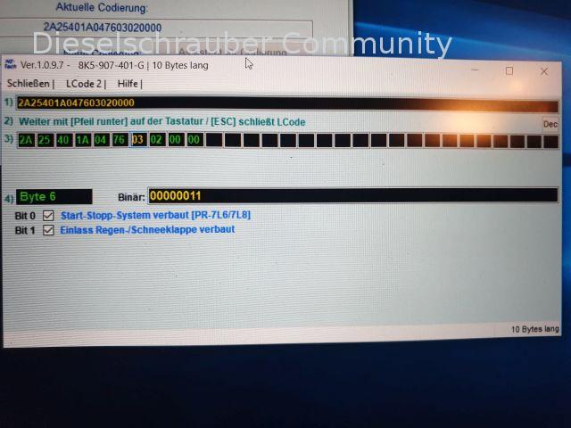

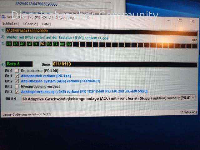

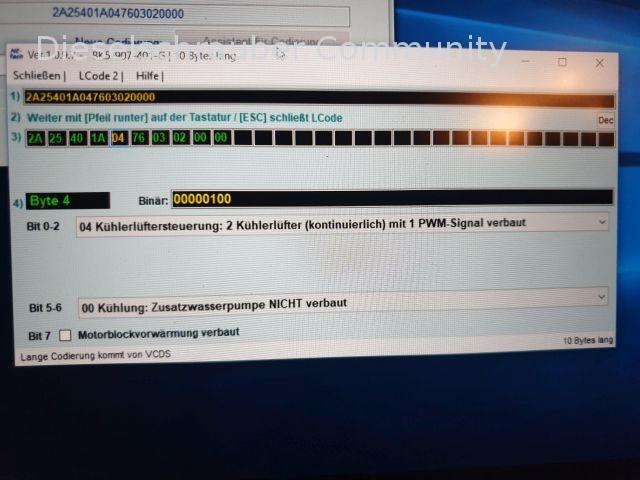

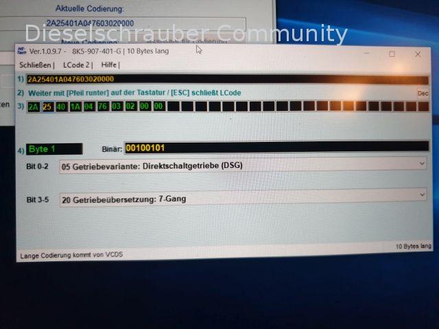

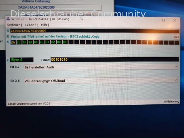

I have rechecked the engine control unit, and according to the selection in the long coding help, the trailer hitch is activated.
I've attached pictures of all the available options for your consideration, just to be sure.
Regarding coding, I once received a document for the B8 S4 that clearly showed how each control unit needed to be coded. So, I was wondering if anyone here might have something similar for the Q5.
My suspicion is still that the trailer control module is responsible for the error, but I would appreciate a brief confirmation that you would also confirm that the coding in the engine control unit is correct.
You're welcome.
Best regards,
Marco Isler.
