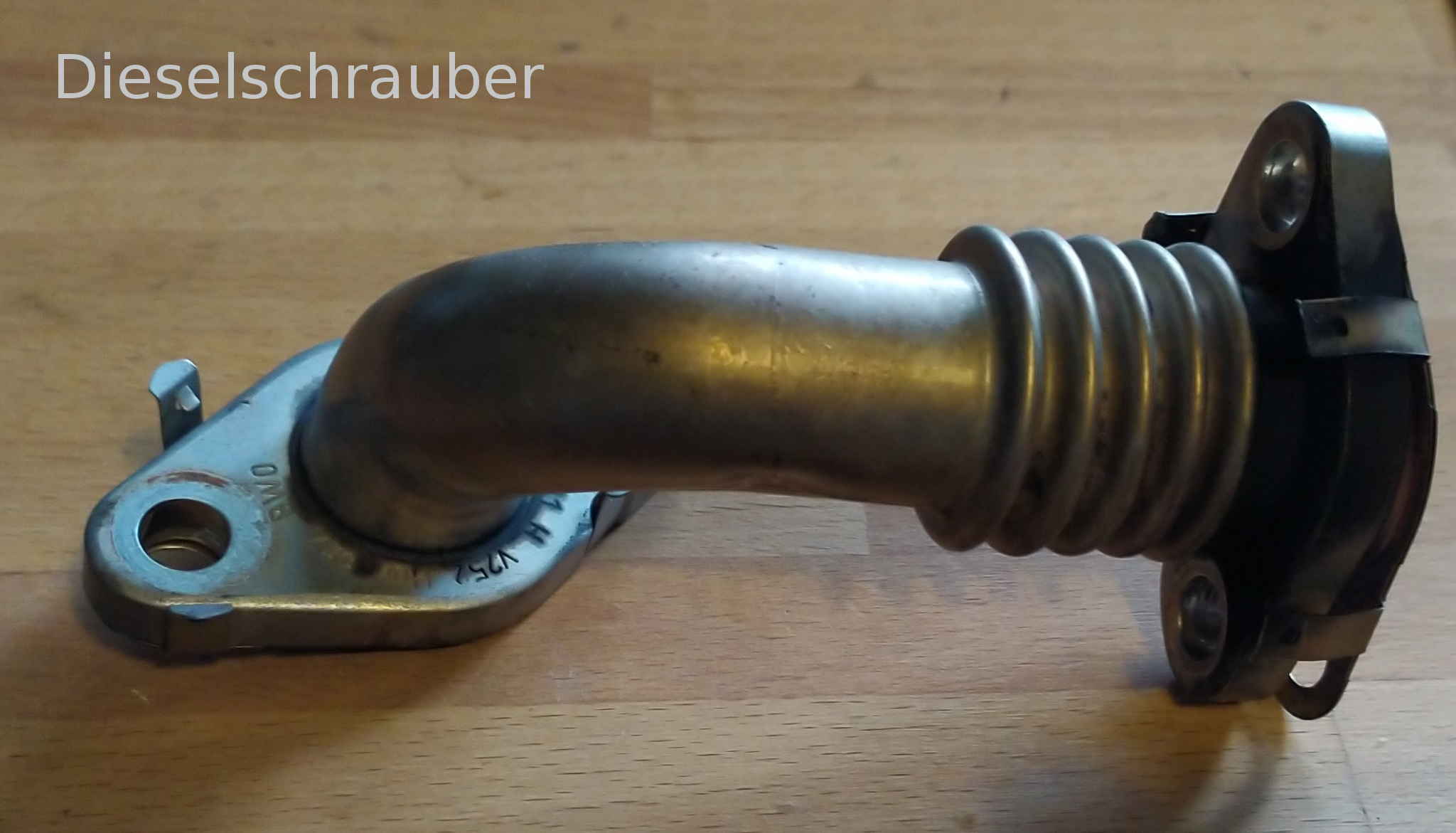

When there's a smell of exhaust fumes inside a VW T6 with a TDI engine, the EGR pipes are prime suspects in the investigation of the cause.
The AGR pipes can either tear at the corrugated sections or directly at the flange. The cracks can be identified by slight traces of soot, hissing sounds under load, and the smell of exhaust fumes when the vehicle is stationary.
The AGR pipe at the front is relatively easy to replace, but accessing the one at the back, near the turbocharger, requires a lift.
A 1/4" ratchet with a swivel head and a short extension is useful for the screws on the turbocharger.
Generally, extensions are very helpful because you often need very long arms, or the workspace is somewhat limited.

| Description: |
| Riss am AGR-Rohr eines 150PS TDI im T6, Rußspuren rechts am Ende des gewellten Bereichs. |
