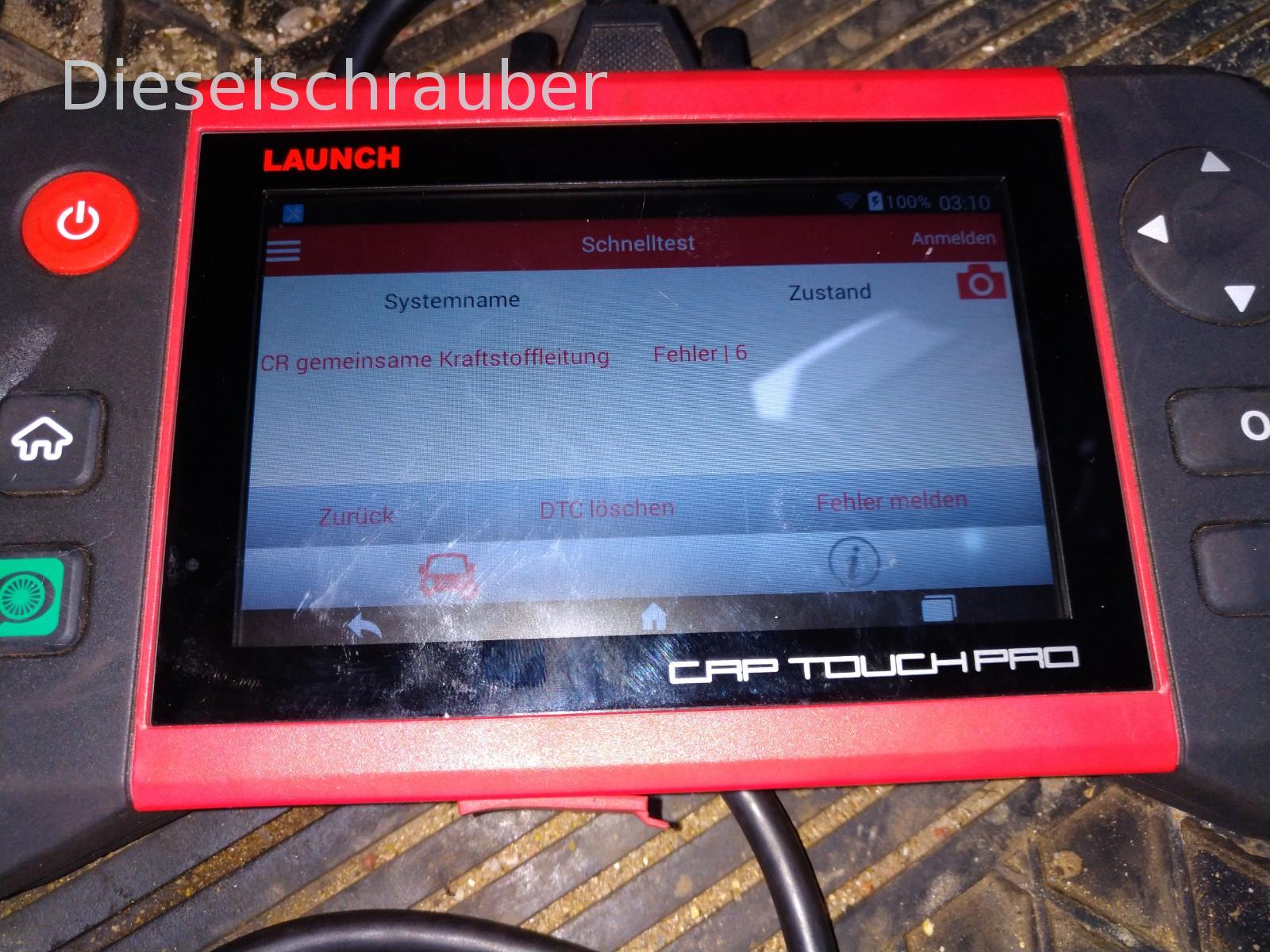

I'm getting another one, a third one this time. I borrowed a screen reader and was able to make a little more progress with it.

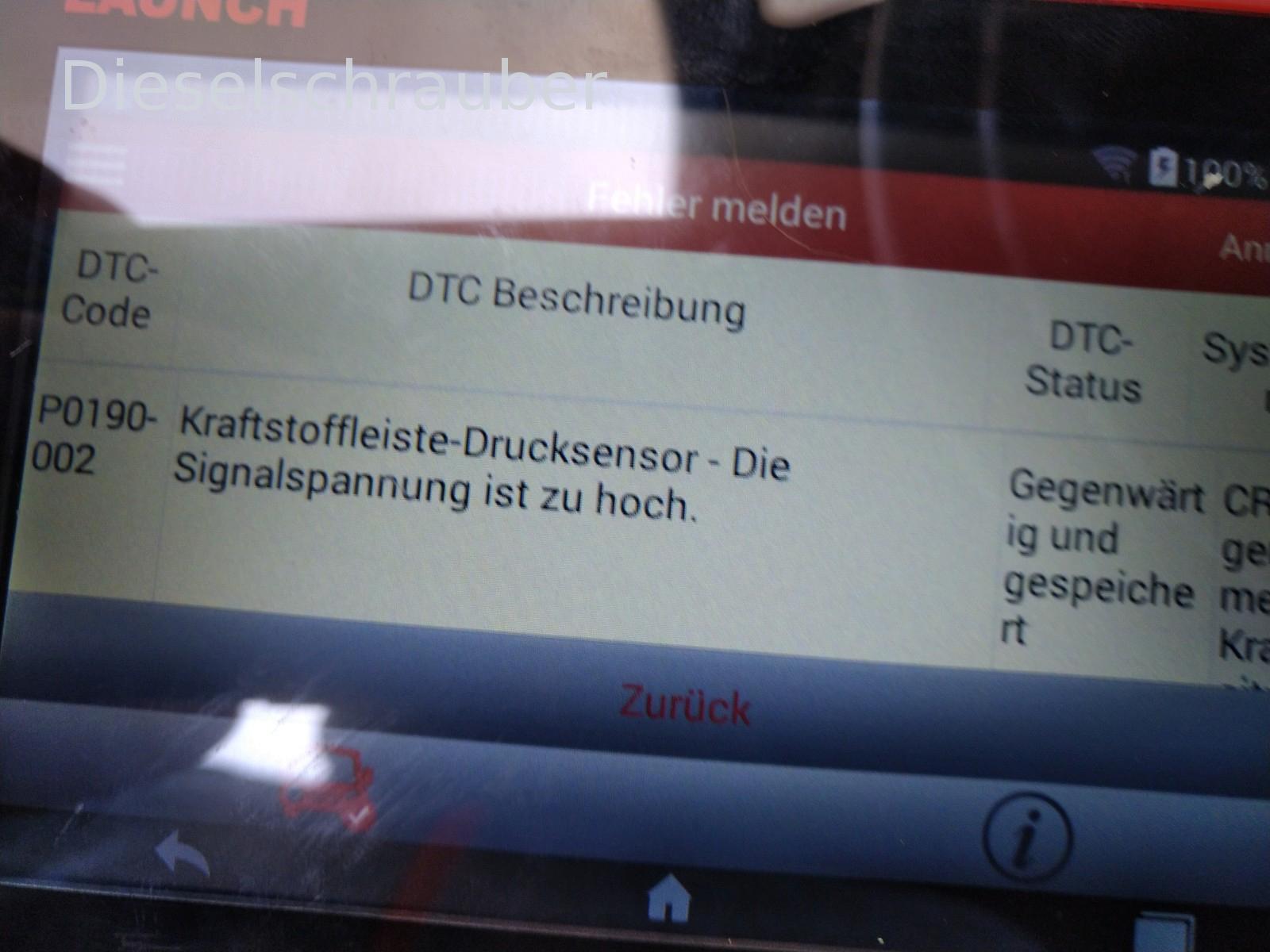

- Fuel rail pressure sensor (fuel rail sensor?).
Signal voltage is too high.

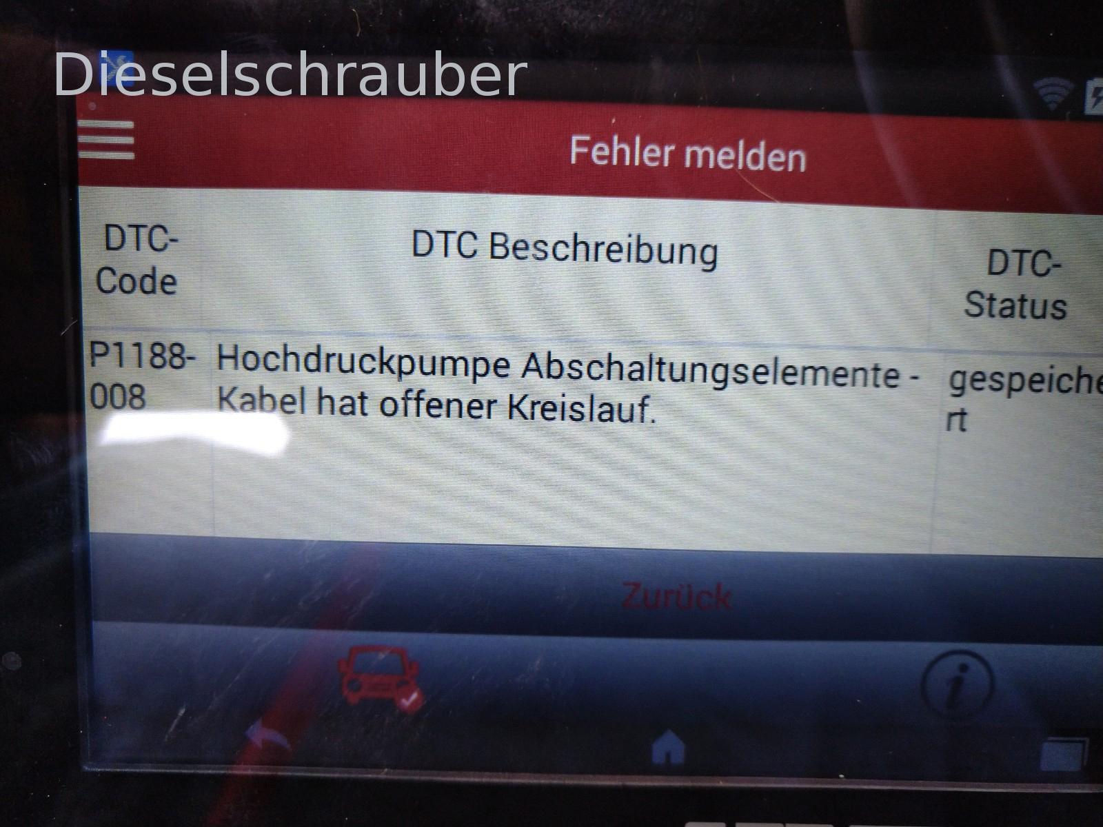

- High-pressure pump shut-off components - Cable has exposed wires.
Circulation.
I disconnected the plug at the pump, and there was some diesel fuel inside. I also replaced the fuel lines, and I might have spilled some fuel in the process.
I set my multimeter to 20V and measured it at the plug. It displayed 860. The reading on the rail sensor cable was also 860. Are these values within the acceptable range? I haven't measured the sensors themselves.

The error has been found and fixed.
The connector to the rail pressure sensor had a corroded ground wire.
