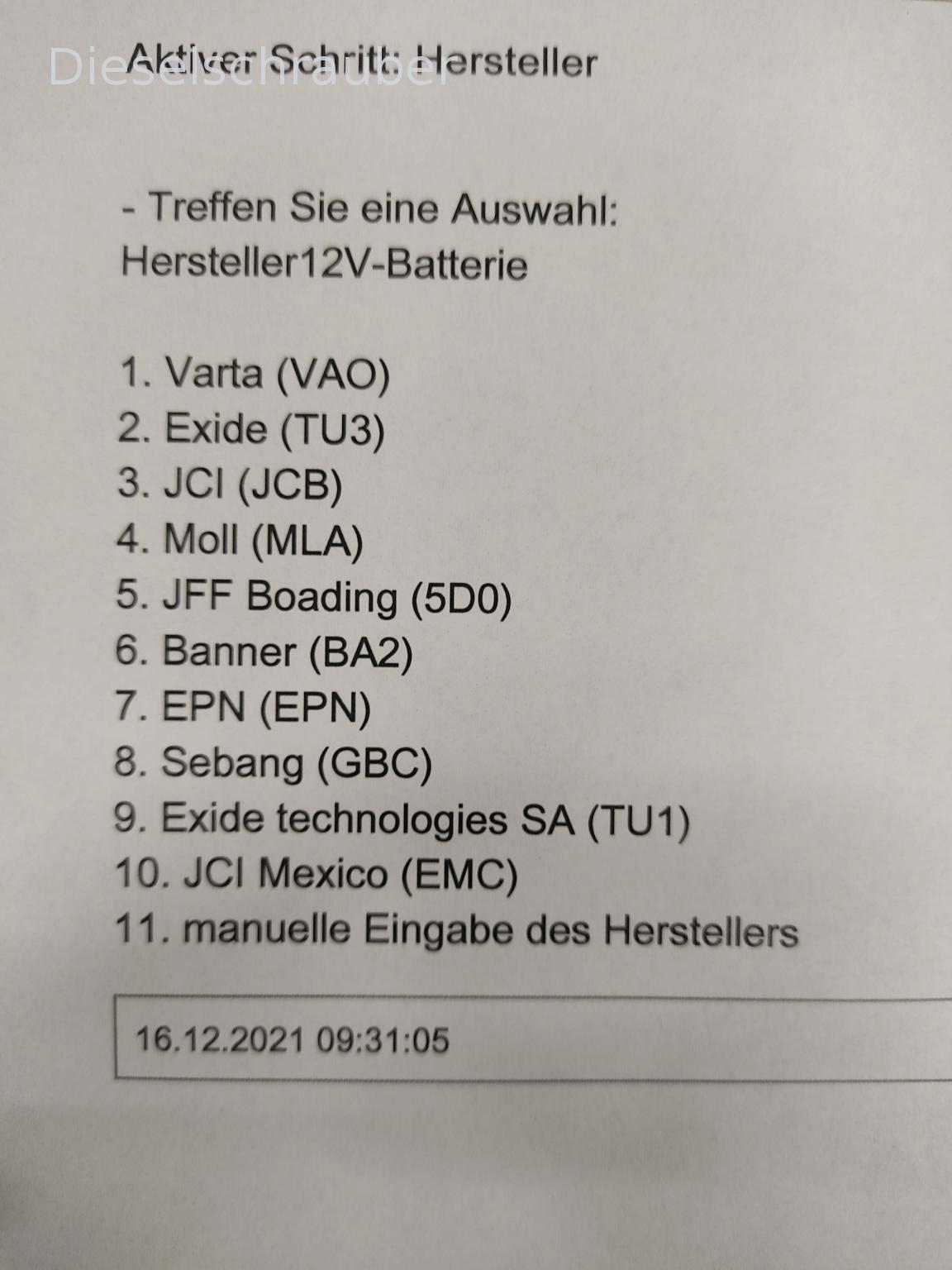

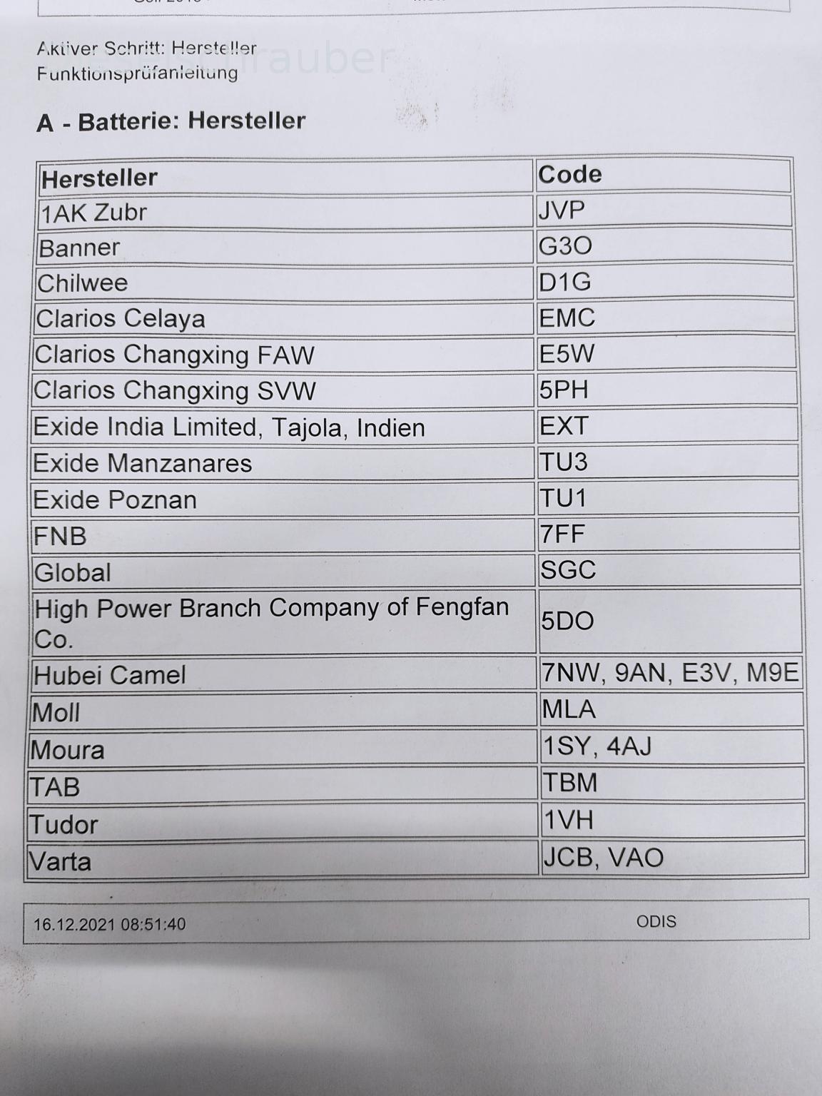

Attached is the list of battery manufacturers' codes.
Best regards,
Dago

Post16-12-2021, 10:11    Subject: Sebang Battery Coding: How To & Guide Quote
