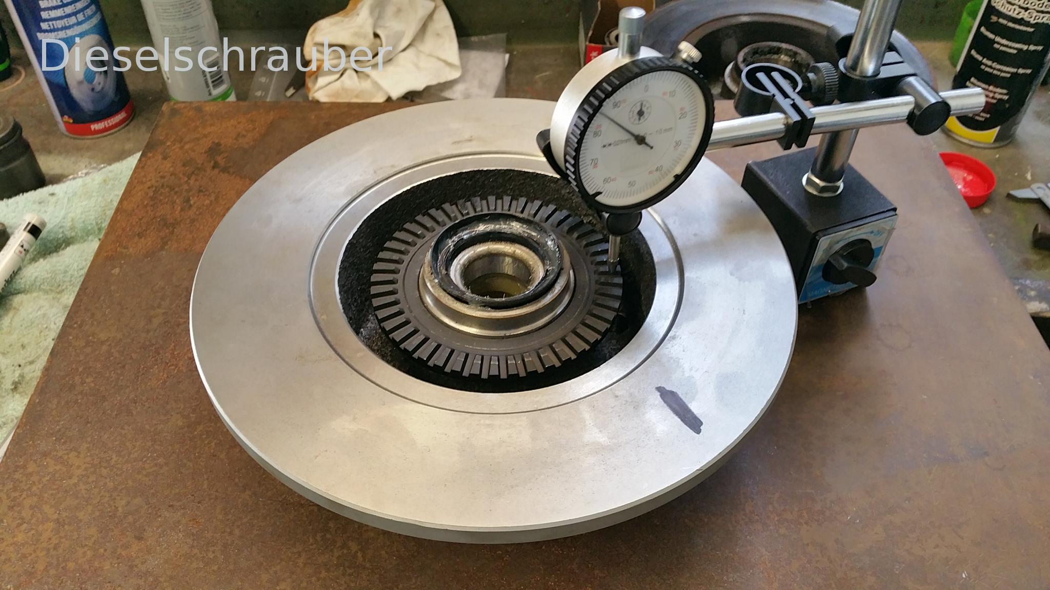

Post21-05-2022, 22:23    Subject: Rear ABS rings for Audi A4, 1997 Quote
Hello!
I'd like to share how things turned out:
So, the car is finally put back together and working properly again.
I don't have any vehicle data right now, and it's not necessary anymore.
That was a 1997 model, gasoline engine.
In the picture, you can see the black sensor ring for the ABS system. It was something that could have been purchased pre-assembled, but it wasn't.
This brake-wheel bearing assembly is constructed in a similar way to the wheel bearings found in Golf 1, Golf 2, and Golf 3 models, using a classic design with tapered roller bearings. The outer storage compartment was larger than it used to be in the older 2-door Golf models.
The oil seal has an additional dust lip on the outside, which makes it more difficult to install.
I adjusted the wheel bearing exactly as I'm used to from previous experiences with Golf 2 models, etc.
Okay, I then carefully adjusted the toothed rings into the correct position, achieving a runout of less than 0.1 mm and a distance of 0.5 mm from the ABS sensor.
The correct approach would have been to use a flat plate and turn an aluminum ring that is approximately 10 mm high, but I didn't have suitable material available.
I could have used that to press something properly. However, it's also difficult to accurately measure whether it's exactly 10 mm or 9.5 mm beforehand.
Once the oil seal was in place, and since I didn't have a new one, it just wouldn't work. It would have interfered with the pressing process.
So, it's quite a flimsy construction.

Post23-05-2022, 9:58    Subject: Rear ABS rings for Audi A4, 1997 Quote
Hi Steffen,
Does the "stub" of the wheel bearing housing that interfaces with the brake disc have a flange that, after the rotor is pressed on, sits flush with the inner edge of the rotor (as visible in your picture)? This would explain the purpose of the simple tool 32-119. Press until the tool is flush with the stop.
Otherwise, there would either have to be a gauge or a stop for the rotor.
Besides, since I don't have a press, I always run a threaded rod through the center whenever possible, and use appropriate plates or rings to secure it.
Joined: 03/05/2005
Posts: 1506
Karma: +641 / -0   Thank you, like it!
Location: Nord/Osthessen
dieselschrauber, olli and Herbert likes this.
Post23-05-2022, 21:03    Subject: Rear ABS rings for Audi A4, 1997 Quote
As I said, the wheel hubs have sensor rings, specifically the original ones that are simply knocked out by drilling through the holes for the wheel studs.
The distance to the sensor is adjusted using the sensor itself, which is loosely mounted in a sleeve... adjust it all the way until it's flush, and then pull it back just a tiny bit.
To install the sensor ring, I use an outer ring from a wheel bearing that I've taken from my collection of spare parts. I place a flat piece of iron on top, align it carefully, and then use strong blows to press the new sensor ring into place. Of course, the old sensor ring is cleaned of any rust beforehand.
Furthermore, there are different rear wheel bearing variants for the A4 B5, and a change occurs around 1997, so it's important to pay attention to that as well.
