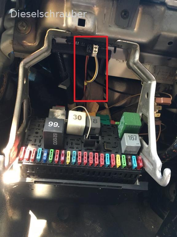

is this the diagnosis section?

This symptom can have several causes, and there are plenty of examples here in the forum. However, it seems that the WFS is already identified as the likely culprit...
Has everything else that might be relevant already been checked?
I have replaced the ignition switch, starter motor, and pickup coil.
Does "starter motor" refer to the electrical part of the ignition switch, specifically the starter solenoid?
The item marked on the photo is the 2x2 diagnostic interface.
Okay, I meant the ignition switch.
Okay, then I'll look for a workshop that still carries the "2x2" device. Thanks.

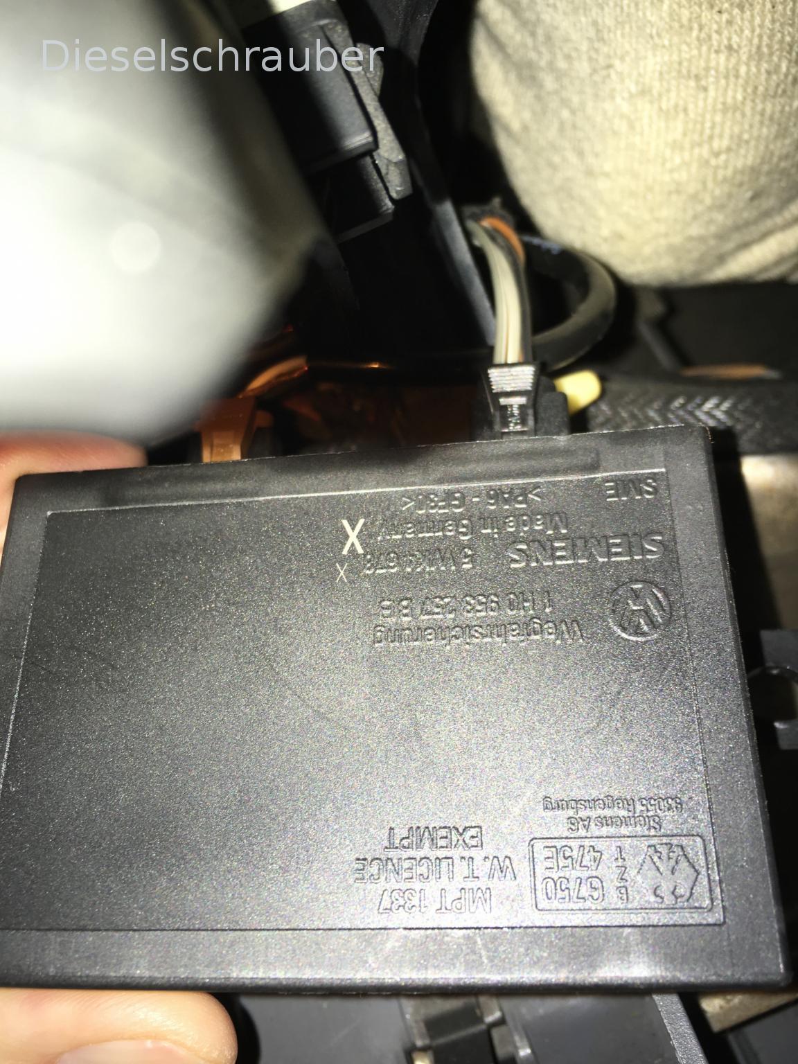

Morning, I'm confused, does the WFS need to be addressed through MSG?
I thought I would solve that within the WFS itself.

johnwolf wrote:
Good morning, I'm confused, does the WFS need to be accessed through MSG?
I thought I would solve that WITHIN the WFS itself
Who controls the engine icon_wink.gif?
The engine control unit (MSG) communicates with the wheel theft system (WFS) via a data line. It checks whether the WFS has recognized a valid key. If not, the MSG shuts off the engine.
A corresponding control module (MSG) doesn't even check if a water pump system (WFS) is installed and simply allows the engine to run.
Therefore, only the MSG needs to be swapped with one that has its WFS disabled.
