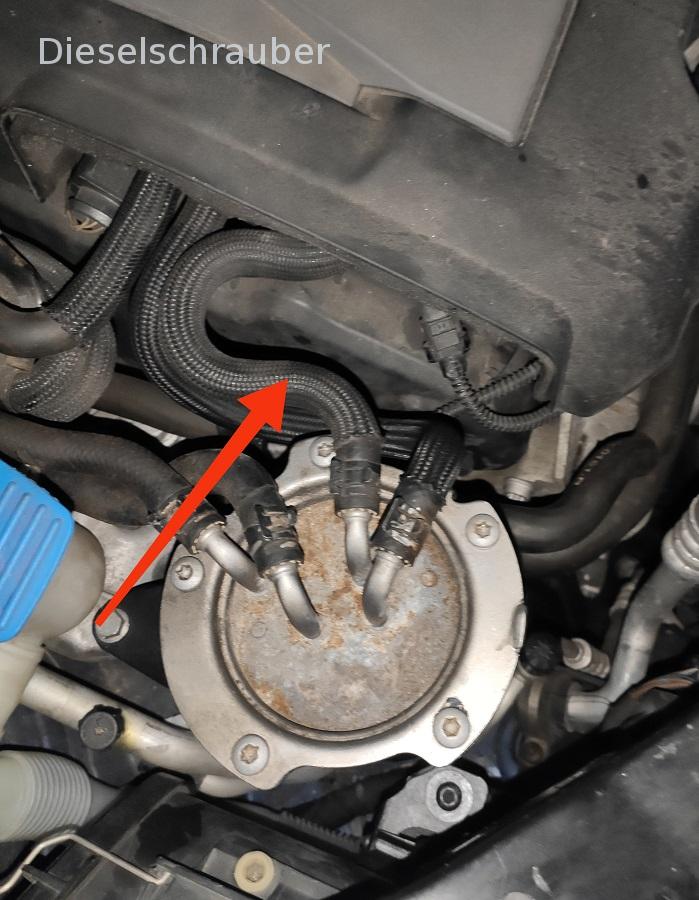

Hello everyone.
Okay, here's my feedback. Unfortunately, as suspected, attempting to access the fuel pump procedure didn't yield any results.
However, I have found a solution, and I would like to briefly describe it here, especially for laypersons like myself.
After some consideration, I've concluded that there must be air somewhere in the lines. No matter how many times you activate the fuel pump, if there's air between the fuel filter and the high-pressure pump in the lines, these actions – activating the fuel pump or using a selective actuator diagnosis with the fuel pump relay, as in my case – unfortunately won't help.
My solution was as follows:
I disconnected the hose (in the picture, hose number  [Admin: likely the fuel return line from the diesel filter], and there wasn't a drop of fuel in it. Then I used the hand pump to pump until fuel started flowing, reconnected the hose, and tried to start the engine, and it immediately started.
So, if adjusting the fuel pump or using (selective actuator diagnostics) with a fuel pump relay doesn't work, here's another option that might help.
To the guys in this forum, thank you very much for the tips!

Due to unclear image rights, I have temporarily removed it.
Please verify information before posting anything. I've followed up and hopefully I'll receive a response soon.
Was was bleded out at the fuel return line, correct?

Hello Rainer,
Sorry, I didn't have the "rights" issue in mind. Here's my photo of the part with the arrow. I'm not sure which line it is, whether it's the return line or not. Unfortunately, I suspect it's the supply line to the high-pressure pump.
Best regards,
