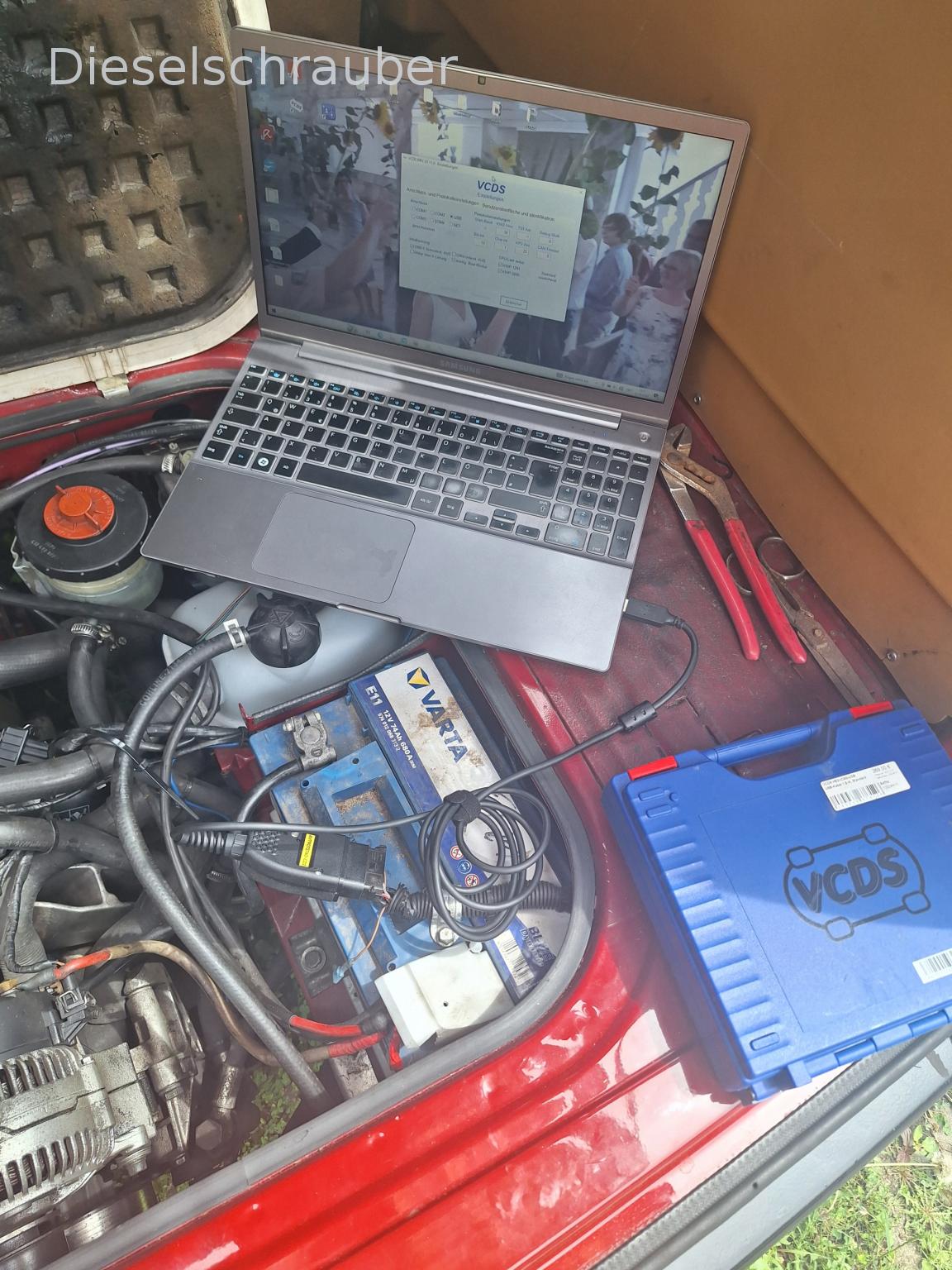

So, it was clear to me that I would now have to deal with the engine. So, I bought a VCDS diagnostic adapter in the blue case and downloaded the software. It seems to be working so far. The self-test recognizes the adapter and detects that the car is not connected. Unfortunately, it still says the same thing even when I connect it. So, the control unit is not being recognized.
Okay, I've checked everything for leaks and things like that, but I don't know how to check the electronics to see if the control unit is even working.

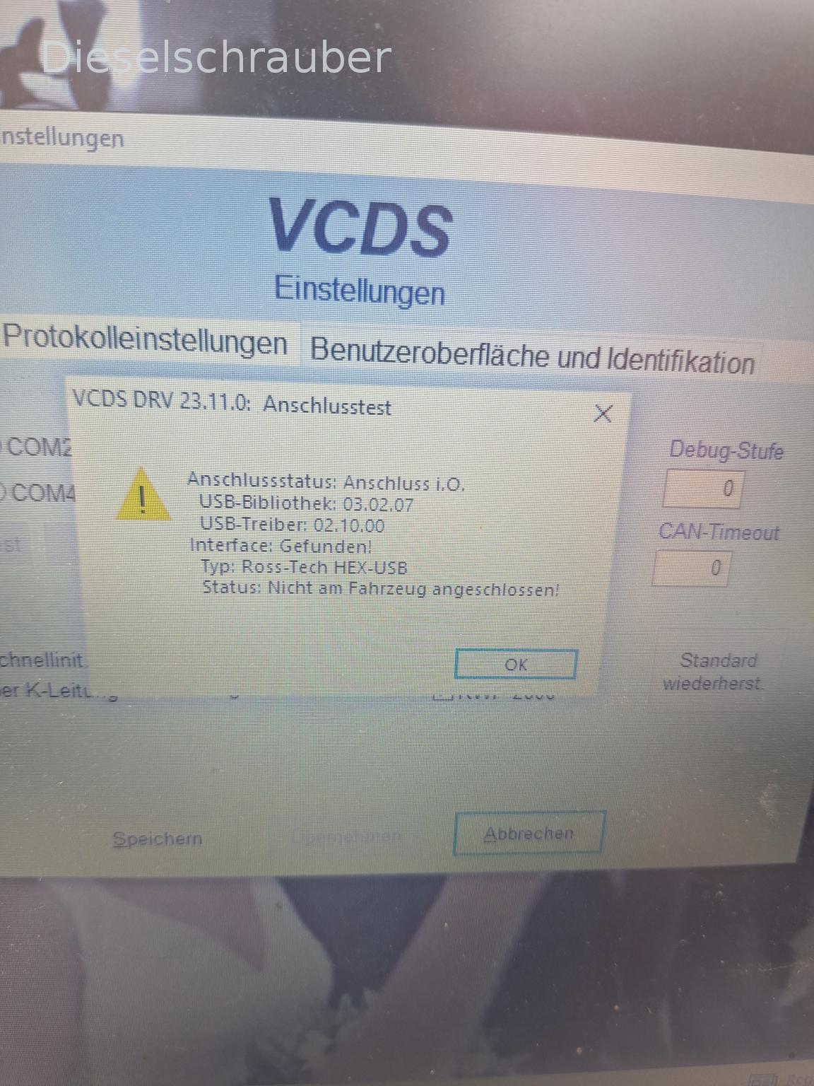

Unfortunately, the same issue persists even when connecting it. So, the control unit is not being recognized.
So, is a diagnostic port (2x2 or 16-pin OBD) already installed? Which version? The pins in the 16-pin connectors sometimes slide backward and lose contact.
Regardless, please post a Screenshot of the VCDS interface test. When the ignition is on, the K-line is pulled to +12V by the engine control unit.

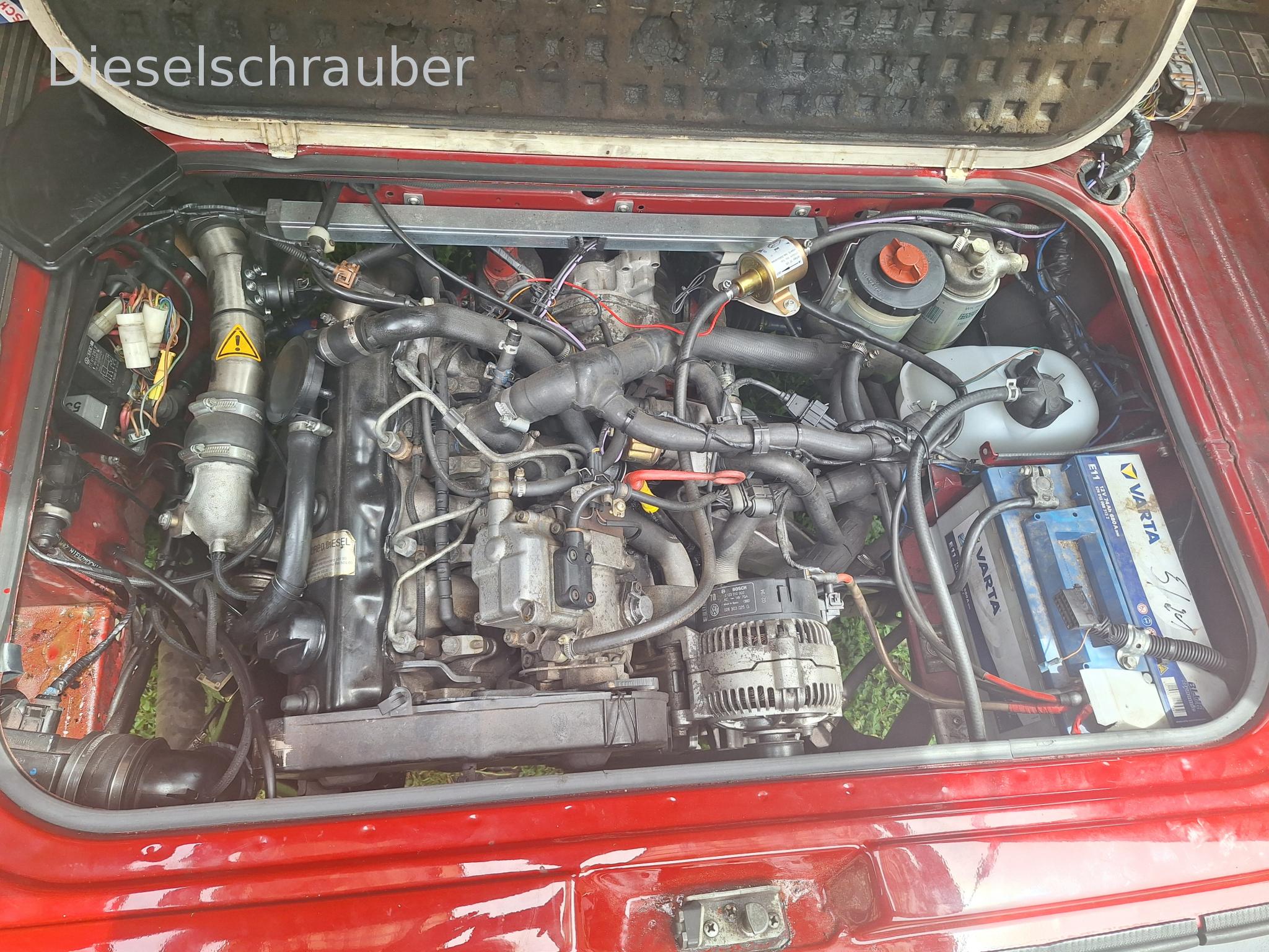

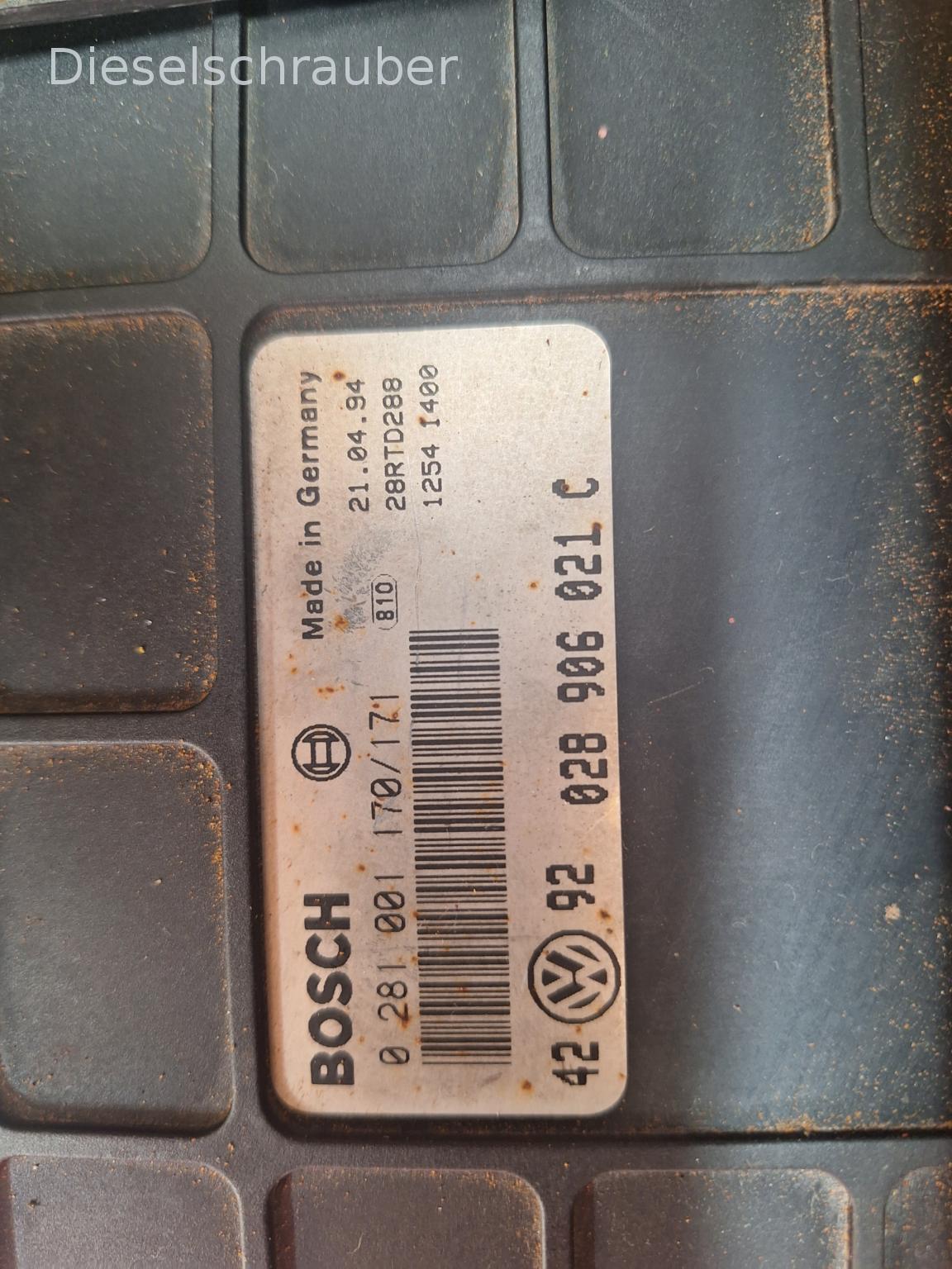

Post31-05-2024, 13:02    Subject: 1Z stutters Quote
T3 with 1Z engine conversion - what was the original engine? What year was it manufactured? And was the connection between MSG and 2X2 rewired?

Post31-05-2024, 13:22    Subject: 1Z stutters Quote
I would say that there was probably a JX engine in it before. However, I don't have any more specific information about that. The van is from 1986. I can't say what modifications were made to the engine control unit or the original wiring harness. I'm still in the early stages of my research and I'm quite inexperienced in this area.

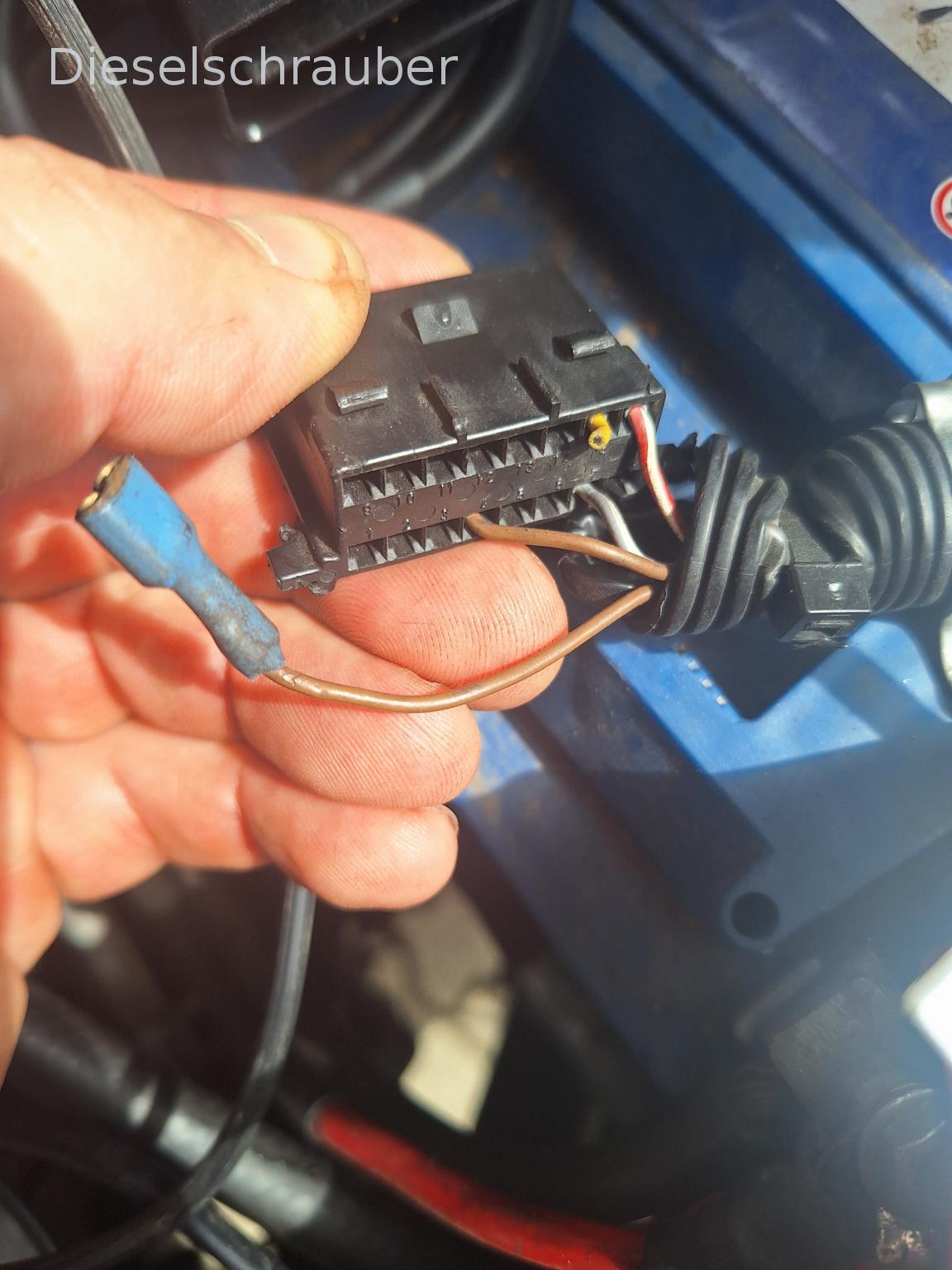

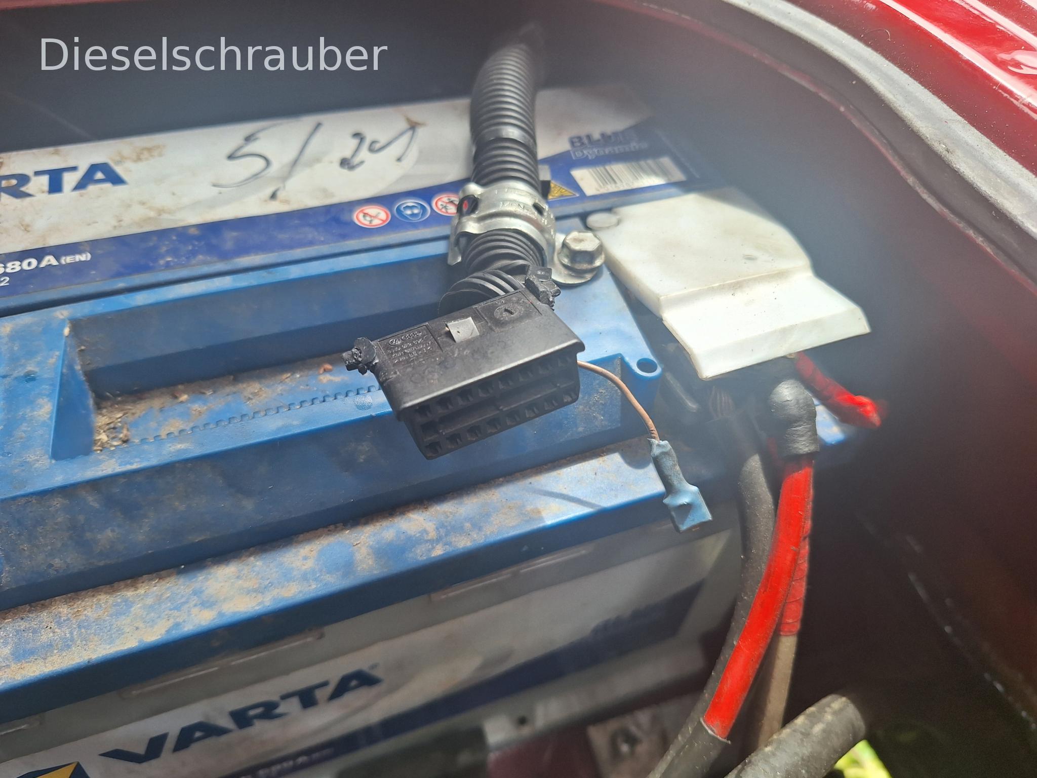

Post31-05-2024, 13:36    Subject: 1Z stutters Quote

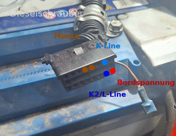

https://www.obd.wiki/obd-2-buchse
Unfortunately, I can't clearly see in the picture where the gray and white cable connects to your OBD-2 port. Pin 7 is the correct one, as you can see in the image in my link, which shows the view of the OBD-2 connector when looking at it from the front.
Diagnosis can only be performed when the ignition is on. Then, using a multimeter, you should be able to measure the on-board voltage relative to ground.
I'll see if I can find the pin/wire color on the connector that goes to the engine control unit.
It should be pin 61.
Okay, I'm ready. Please provide the German text you want me to translate.

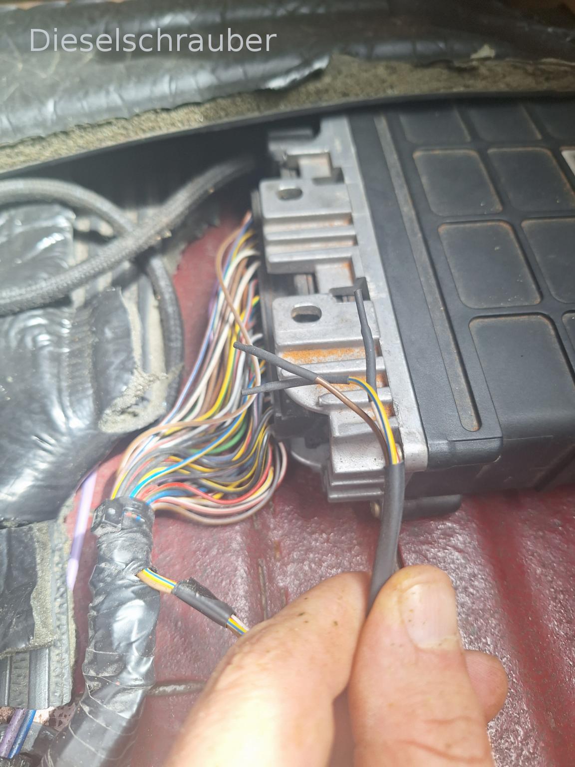

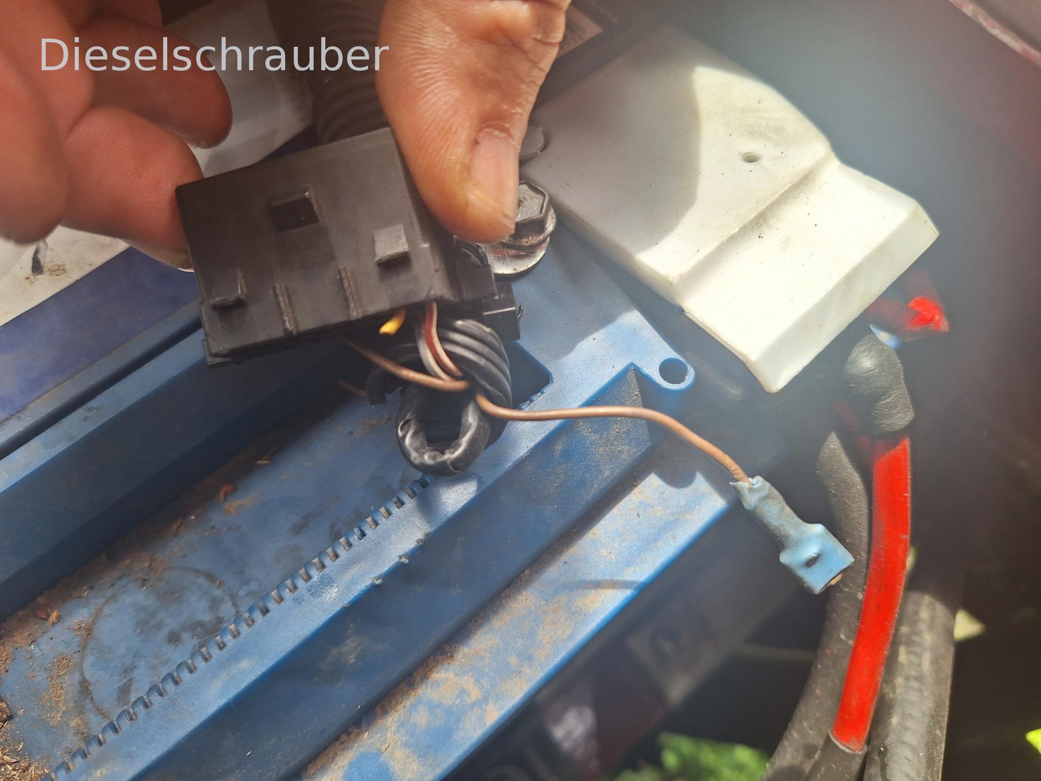

Post31-05-2024, 13:58    Subject: 1Z stutters Quote
To-do list for you:
Connect the K-line from the engine control unit (pin 61, see details in the link in my previous post) to the correct pin on the OBD2 connector.
The three wires, which have been stripped of their insulation with heat shrink tubing, also appear to be heading towards the correct location on the engine control unit.
Since we don't know what modifications have been made, I suggest the following:
- If the K-line is connected to the OBD2 connector, determine which control unit (e.g., auxiliary heater) it is connected to. In this case, the K-line can be connected to pin 15 of the engine control unit (K2/L-line). The interface recognizes both.
- If the K-line connector is not available on the OBD2 port, connect the K-line to the engine control unit.

Post31-05-2024, 14:28    Subject: 1Z stutters Quote
Hello, so the k2 l line is disconnected and yellow. However, it's not present in the tree. Also, there seems to be a missing ground connection, as there's something else nearby. I just found this corroded relay, part number 109, hanging loose behind the battery.

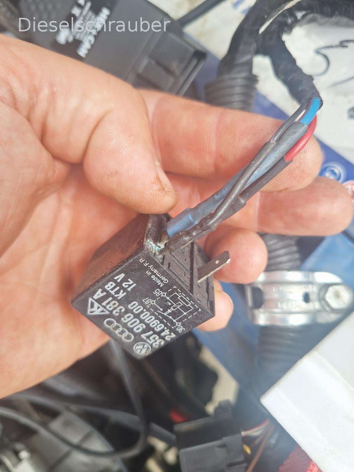

Post31-05-2024, 14:36    Subject: 1Z stutters Quote
I just saw some cables running down from behind the battery, and there's an extra box attached under the battery that's not original. There must be something inside that box. I need to take care of my child now. I'll check it out later.

Post31-05-2024, 15:28    Subject: 1Z stutters Quote
Relay 109 provides power to the engine control unit. Without voltage, the engine will not run, and diagnostics are also not possible.
Is the dashboard light connected to the engine control unit (ECU)? If so, does it turn on for a second when the ignition is turned on and then go out? (This would be an indication that the ECU is receiving power. Otherwise, you may need to measure the voltage directly at the ECU). While this isn't your original problem with the limp mode, it's possible that the engine has more than just the initial issue.

Post24-06-2024, 10:33    Subject: 1Z stutters Quote

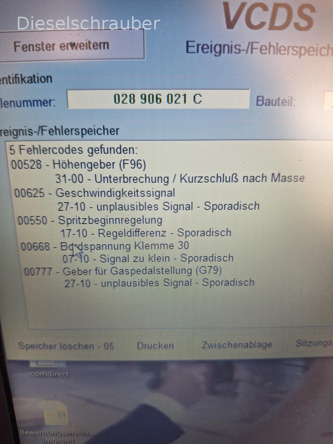

Hello, first of all, thank you again for all your help. Today, I finally had some time to work on the van. I figured out which pin is assigned to which function. So, relay 109 is defective and unfortunately, it can't be repaired by soldering. It looks like someone has already been working on it before. I ordered a new one.
I bypassed the relay, which finally gave me access to the control unit and the diagnostic tool. That's a good start. I took pictures of the error codes. Unfortunately, the car still won't start even after clearing the error messages. It sputters, then starts up erratically, revs cleanly once, and then dies again.

Post24-06-2024, 19:43    Subject: 1Z stutters Quote
Hello, thank you for the feedback!
The altitude sensor is likely external in your case. You can see which pins of the engine control unit it's connected to by examining the wiring diagram.
/viewtopic.php?t=22938
With all these error messages, I suspect you have a problem with the wiring harness. Also, check if the height sensor is receiving its supply voltage when the ignition is on. Make sure the +5V isn't shorted anywhere.
