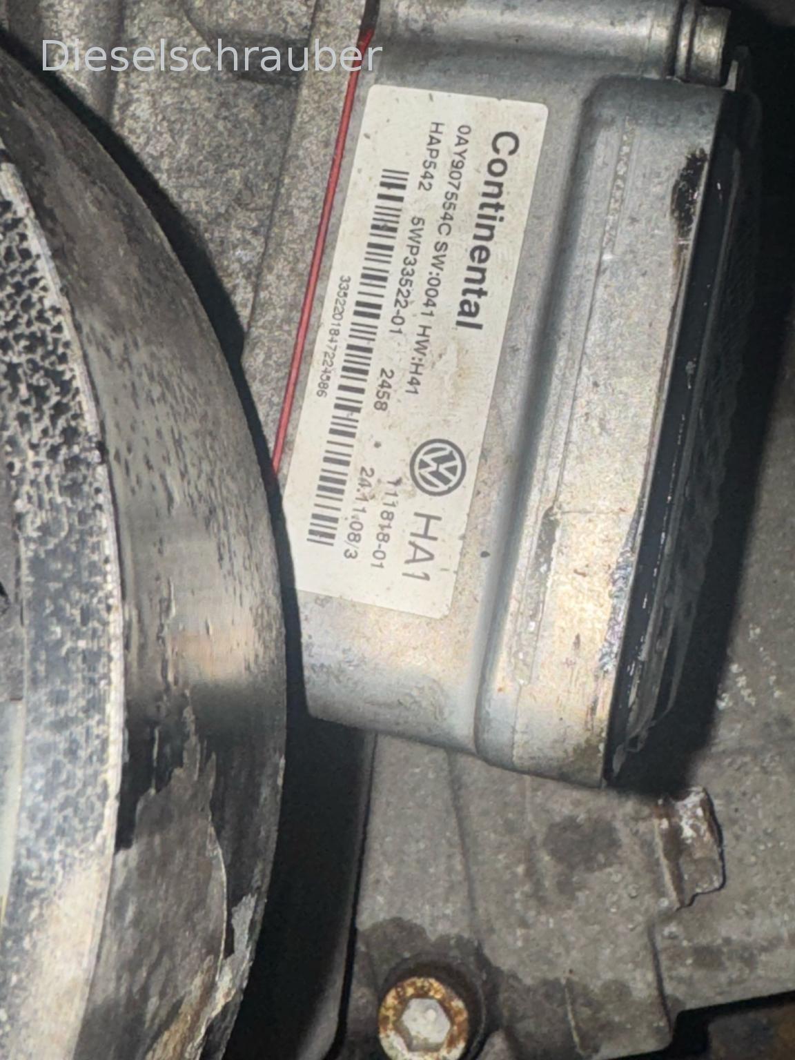

Hello.
I hope someone can help me here. I installed a new Haldex unit, using what was supposed to be the same Haldex control unit. Now I'm having a small problem: the diagnostic system shows "Transmission control unit, no communication." I thought it might possibly be related to coding.
Unfortunately, VCDS doesn't provide a list; it directs me to contact support via email. I disassembled the old ECU, and to my dismay, it was completely corroded. I'm attaching everything to the email.
I hope it can be resolved. Available tools: VCDS, VCP, Odis S, Odis E.
Thank you for your help.
Vehicle: VW Tiguan, Year of Manufacture: 09/2009.
Engine code: CBA, 103 kW.
 Haldexstg. Original
 File size:  340.77 KB
 Viewed:  1691 times

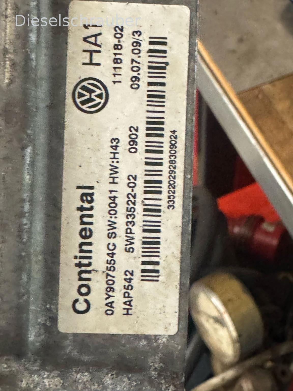

 Haldexstg Gebraucht
 File size:  322.97 KB
 Viewed:  1588 times

I am aware of that. But with the old TCU, I had the DTC code 02248 from the pressure control valve, and everything was fine after I cleared it. I will test tomorrow to see if the all-wheel drive is working, but I won't receive the filter package and oil until tomorrow. Then I will test it. It's strange, though, that the numbers 5WP33522-02 0902 from the O-ring and 5WP33522-01 2458 might be related to this. I've never experienced anything like that before.
