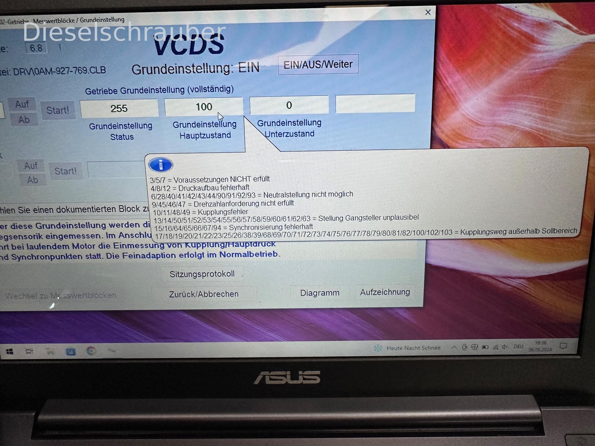

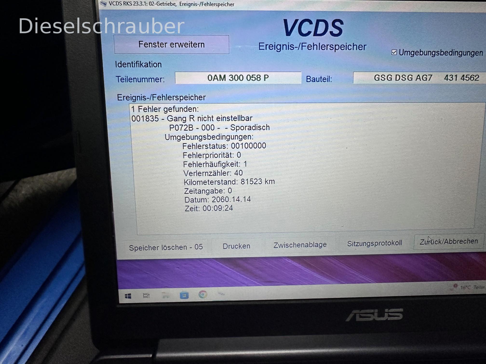

Since we engaged the clutch for the first time, I've been getting the following error message in the transmission control unit.
Gang R. Not adjustable. P072b
And right at the beginning, there was also an error in section 7.
Shifted the gears down, replaced the shift fork detents even though they didn't appear to be broken. Everything was reinstalled, and the basic configuration was started with VCDS, but it stopped after about 10 seconds with error code 101.
Error: Gearbox control unit memory - only reverse gear (R) cannot be adjusted.

DSG DQ200 failure - Video.mov
 Video von der Grundeinstellung.

 Abbruch im VCDS Grundeinstellung

 Fehlerspeicher VCDS

It would also be interesting to see the errors in the DSG (direct shift gearbox) that were present during the Autoscan, but apparently, those have been deleted. icon_smile.gif
So, does that mean "001836 Gang R cannot be adjusted"?

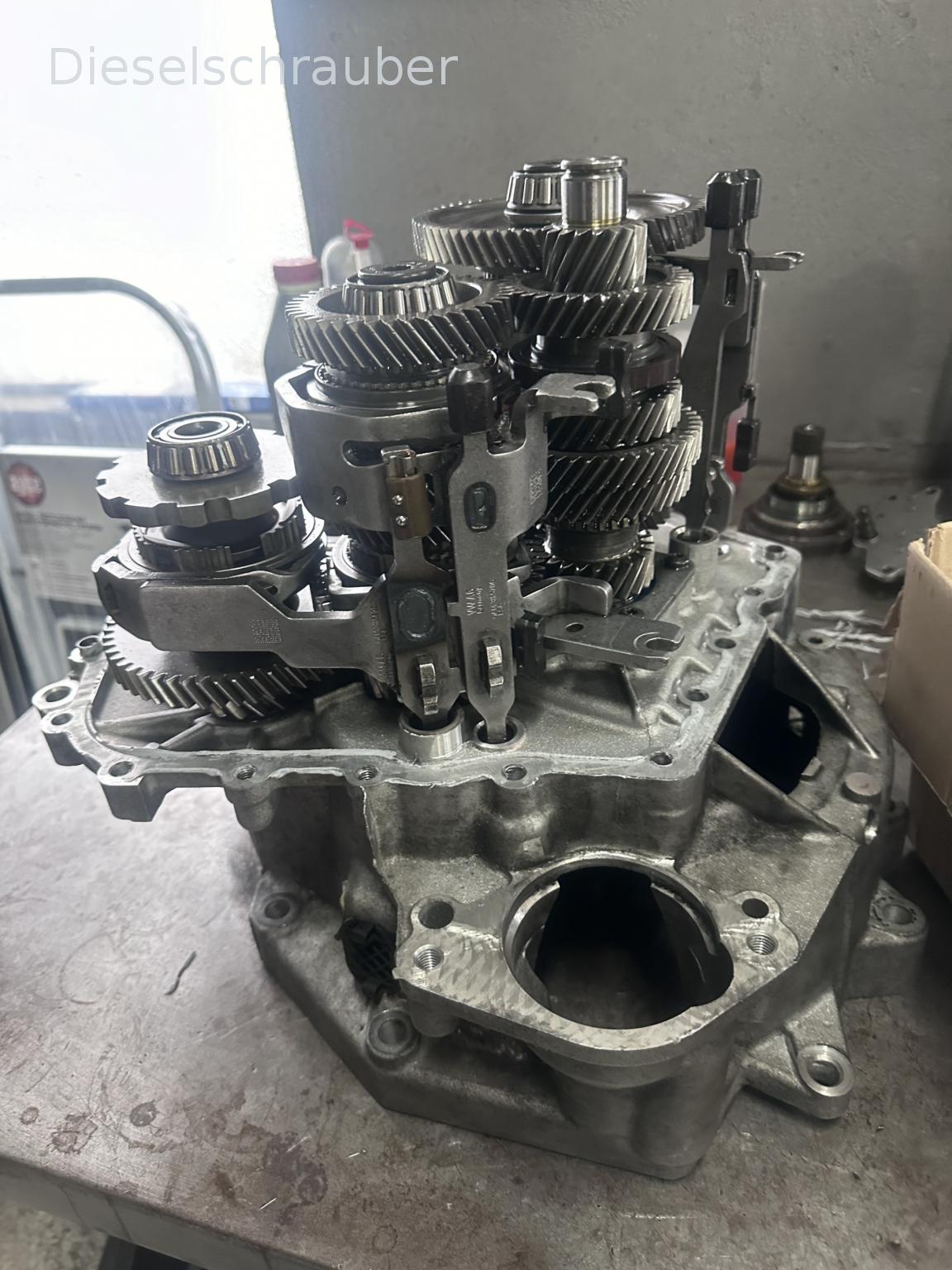

If it's not possible to engage the reverse gear manually with significant force even when the mechatronic unit is disconnected, then the problem is likely not the mechatronic unit itself, but rather the transmission.
The slip beads have already been replaced. When doing this, you usually manually check everything. Why wasn't it noticed (or ignored) that the R-fork cannot be shifted? That would have been the perfect moment to notice the error and continue researching in the disassembled state to determine the cause.
I would say: The seller probably "forgot" to mention a part of the history. Without disassembling the DSG (direct-shift gearbox), I don't think we'll be able to get any further. The cause is of a mechanical nature, and VCDS will only be able to provide very limited assistance.

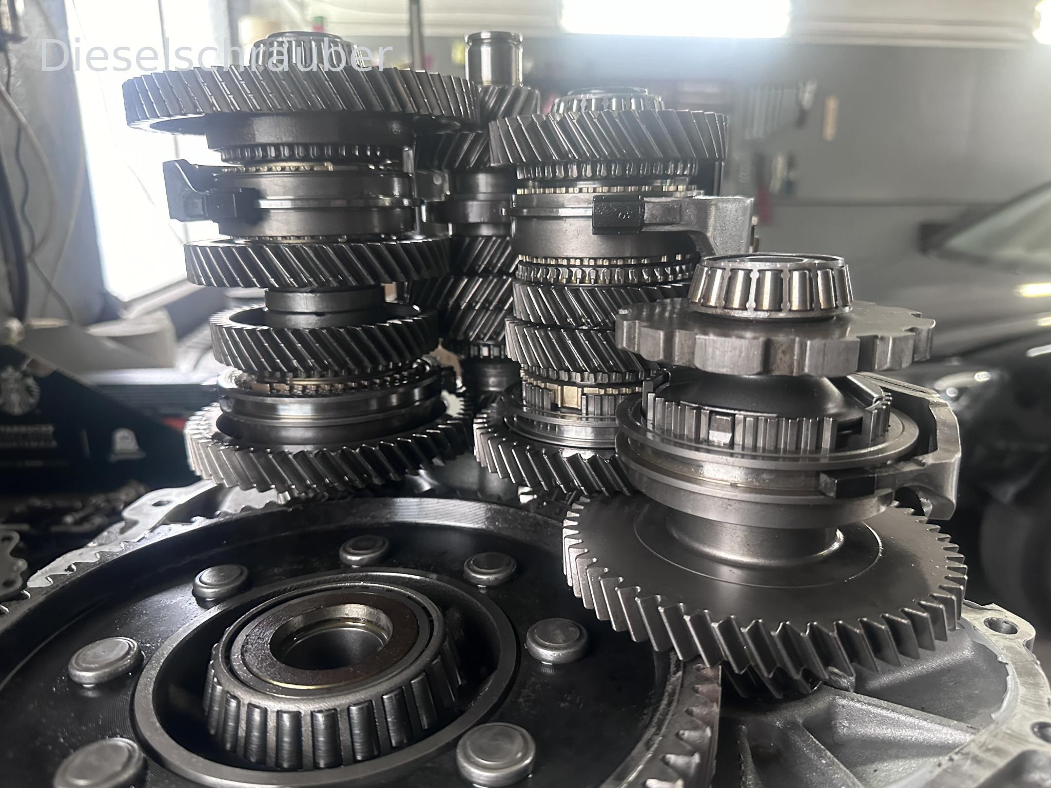

Post23-09-2024, 10:52    Subject: Pictures Quote
Here are some more pictures.
 DSG DQ200 failure
 File size:  2.07 MB
 Viewed:  270 times
 DSG DQ200 failure
 File size:  2.14 MB
 Viewed:  380 times
Joined: 06/22/2005
Posts: 4606
Karma: +1325 / -0   Thank you, like it!
dieselschrauber likes this.
Post23-09-2024, 13:25    Subject: DSG DQ200 failure Quote
Can the gears, specifically reverse gear, be shifted on an open gearbox?
Tomi79
Joined: 10/07/2018
Posts: 8
Post23-09-2024, 17:32    Subject: DSG DQ200 failure Quote
Hello.
Yes, as you can see in the video.
