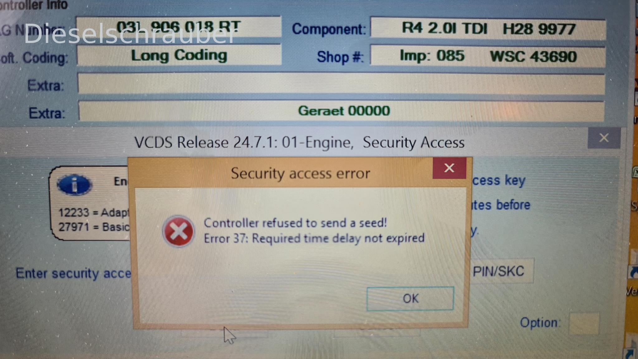

Therefore, I wanted to change the mileage through the "Initialize DPF" menu option, but I was unable to do so because of an error during the login attempt.
Access permission failed (device is not sending a "seed"). Error 37: Lock time is active.
permanently prevails.
The login "12233" was used.

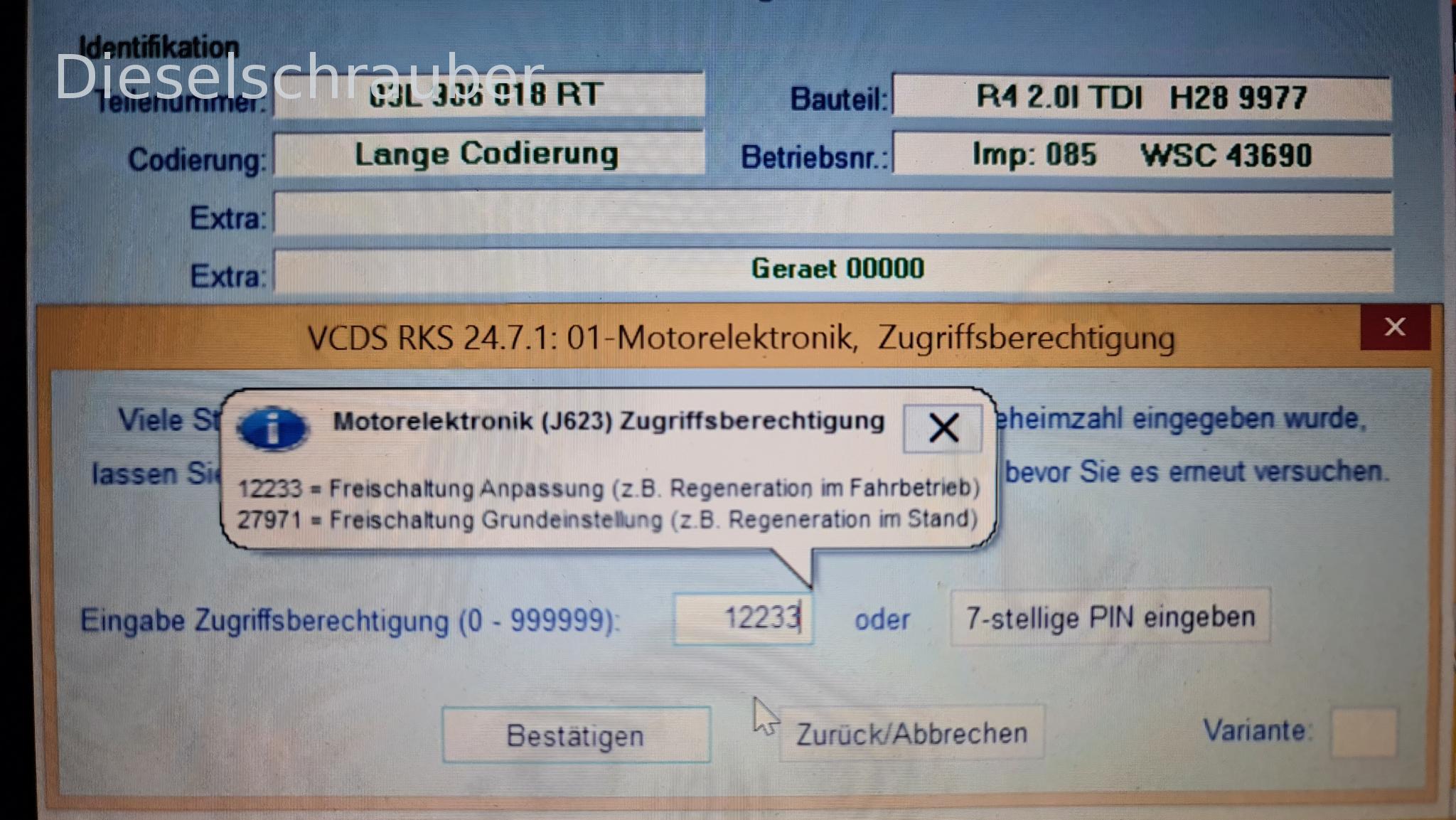

Post09-11-2024, 21:08    Subject: *PERMANENT* Error 37, ban period active. Quote
Hello, and good evening.
The two logins shown in the appendix are proposed.
Neither of them works; the same error message remains.

Post10-11-2024, 5:15    Subject: *PERMANENT* Error 37, ban period active. Quote
Good morning!
If I have the time today, I'll try out the English version.
I will get back to you as soon as I have any news.
Sure, no problem!
Best regards,
Alex.
Aunt Edit says: The same error occurs in the English version as well. Just for a change, let's do it in English icon_biggrin.gif.
