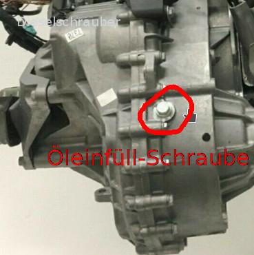

Do I have Pattex glue on my eyes? I can't find an oil filler screw anywhere. Just the bleed screw.
"Where is the oil filler cap? According to the SSP (Service Service Publication), it should be located behind the driveshaft on the passenger side. However, it's not there." Not even at the front, near the starter motor.
Is that the screw in the picture? It's located at the rear of the differential.

I was struggling under the car, and it turns out it was actually the filler cap. However, there is no oil that can be felt inside, the screw smells like transmission oil, and it has a sealing ring.
I'm just going to fill it with 1 liter for now, since quite a bit will have been lost due to the leaky shaft seal.
I'm not comfortable filling it up to the bottom of the screw, as it seems the screw is positioned a bit too high for a reliable level check.

There are two versions of the 6-speed manual transmission: one with a fill plug and one without.
If you have the version without the fill screw, the reverse gear switch (02T 945 415 P) must be removed to fill the fluid.
The gearbox is filled with 2.7 liters of oil through a hose with a 10mm diameter and a funnel.
Org. Part number G 052 527 A2.

"Thank you very much!" I just filled it in through the screw at the back of the transmission.
