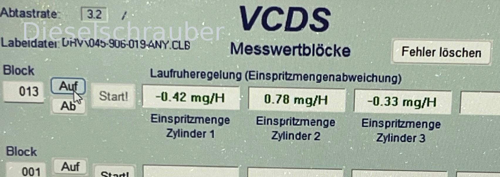

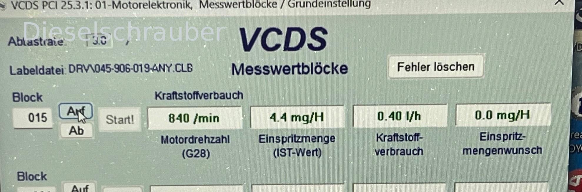

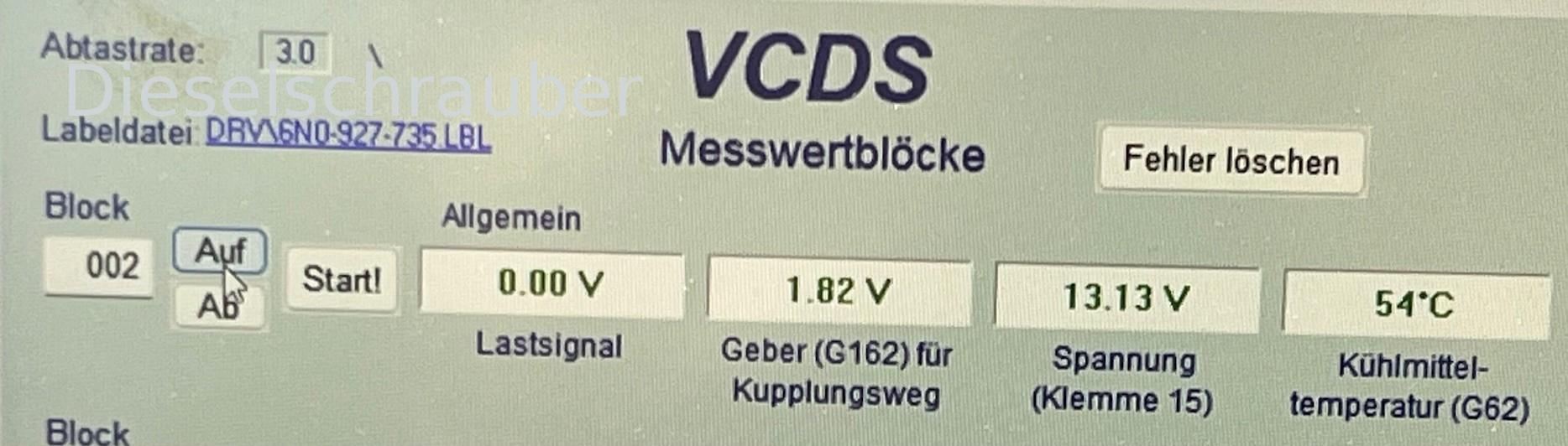

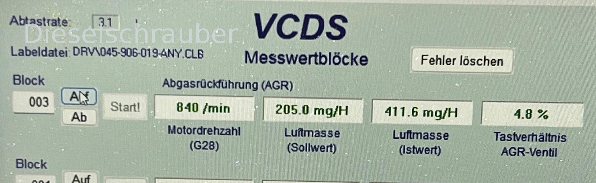

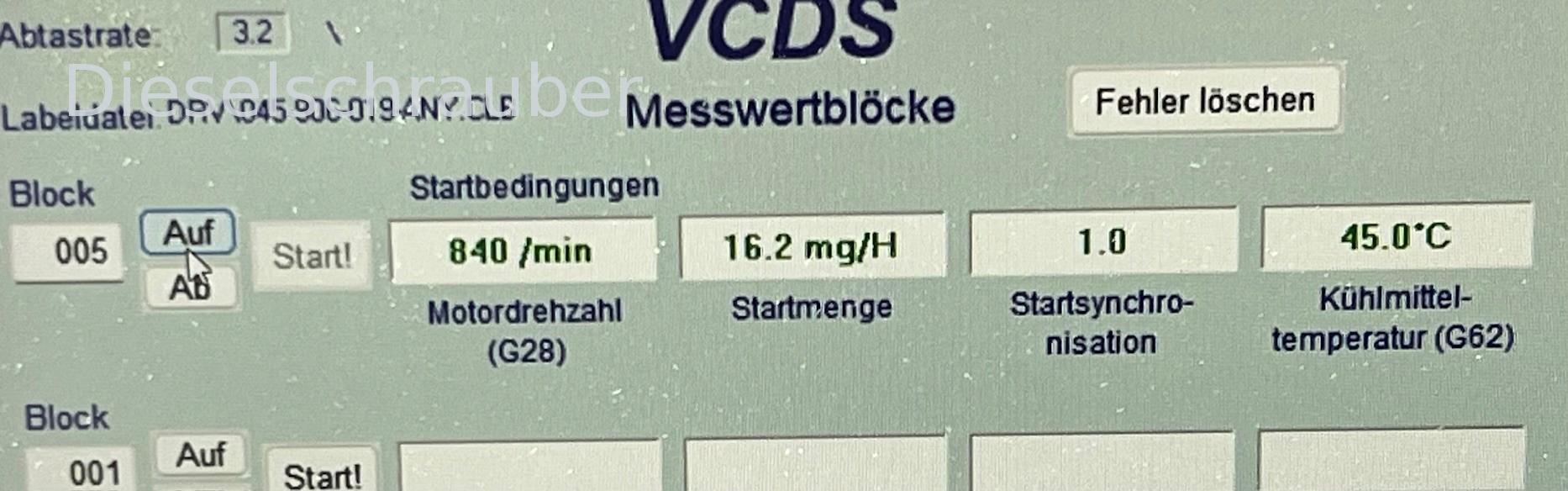

Post28-10-2025, 13:25    Subject: Lupo 3L: No Power, Blue Diesel Smoke Quote
Thank you again for your ideas!
Unfortunately, I didn't have much time to watch it, but I tried again this weekend.

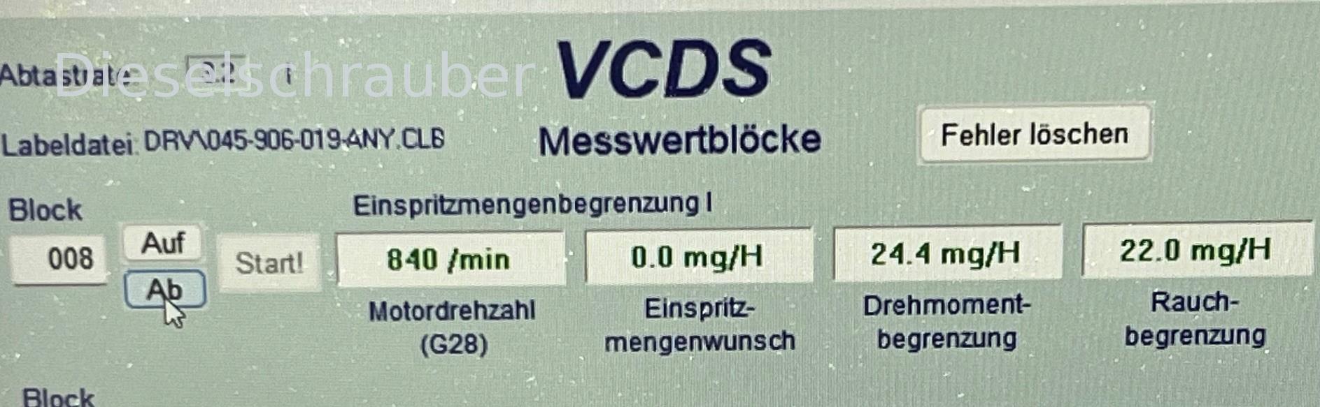

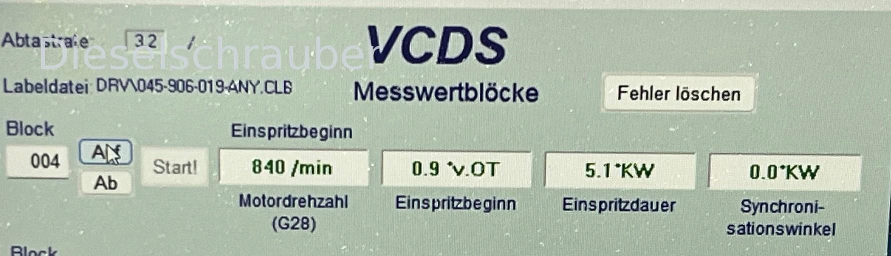

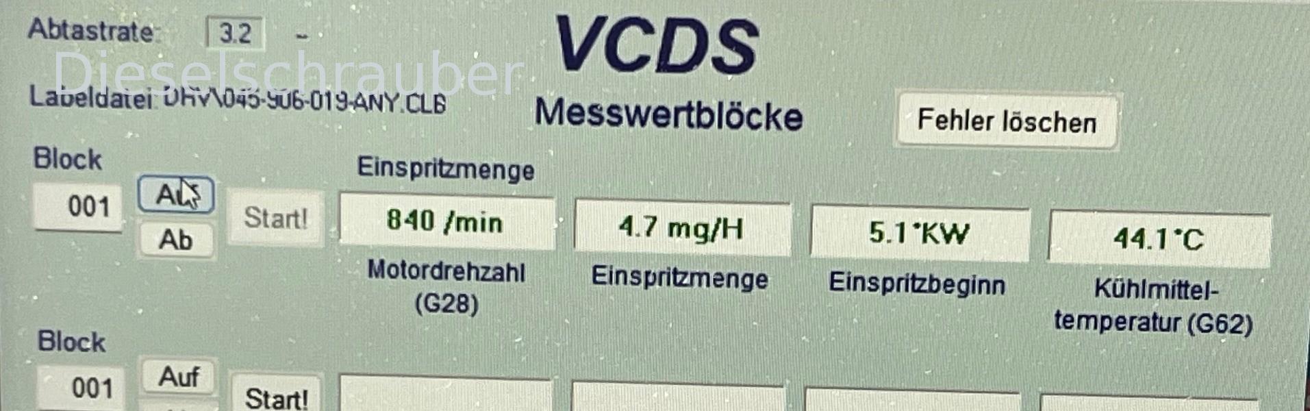

In my opinion, all the measuring devices show optimal values.
Finally, I inspected the external condition of the PD elements and checked the tilt lever play. It was exactly 180 degrees for all three, as if someone had just adjusted it.
The new tandem pump is definitely suspicious.
Perhaps the old tandem pump produced debris that is now clogging the positive displacement elements.
I will be removing the PD elements this week.
I experimentally adjusted the synchronization angle in advance, and I immediately observed a reduction in smoke emissions.
Then I tried setting it to +4 degrees again, and with the engine warm, I no longer observed any smoke, and there was noticeably more power. However, when the engine cools down and is then started, it smokes again, producing a bluish smoke with a smell of unburned fuel.
My suspicion definitely lies with the fuel injectors. They might be clogged, or possibly damaged due to incorrect adjustment attempts. If they are, for example, dripping fuel, this could explain the good starting behavior combined with late injection timing.
The thermostat, like in most Lupos, is also defective and barely reaches above 60 degrees Celsius. It's a good thing the Lupo doesn't have a temperature gauge...

Posts: 18130
brezelmann01 likes this.
Post29-10-2025, 22:16    Subject: Lupo 3L: No Power, Blue Diesel Smoke Quote
The fuel injection volume at idle and the long-term fuel trim appear to be normal.
No performance: What is the maximum fuel injection amount at full throttle?
Check MWB 8 in the ECU; the power curve is defined by the transmission's torque limit.
Is the airflow through the machine okay? As a rough estimate, a ratio of 20:1 between air (in mg/h) and diesel (in mg/h) at the rated power point would be good.
If that's appropriate: Does a Schlaubi have two cylinder head gaskets installed, or one that is excessively thick?
Translated on 12-09-2026, 2:08.

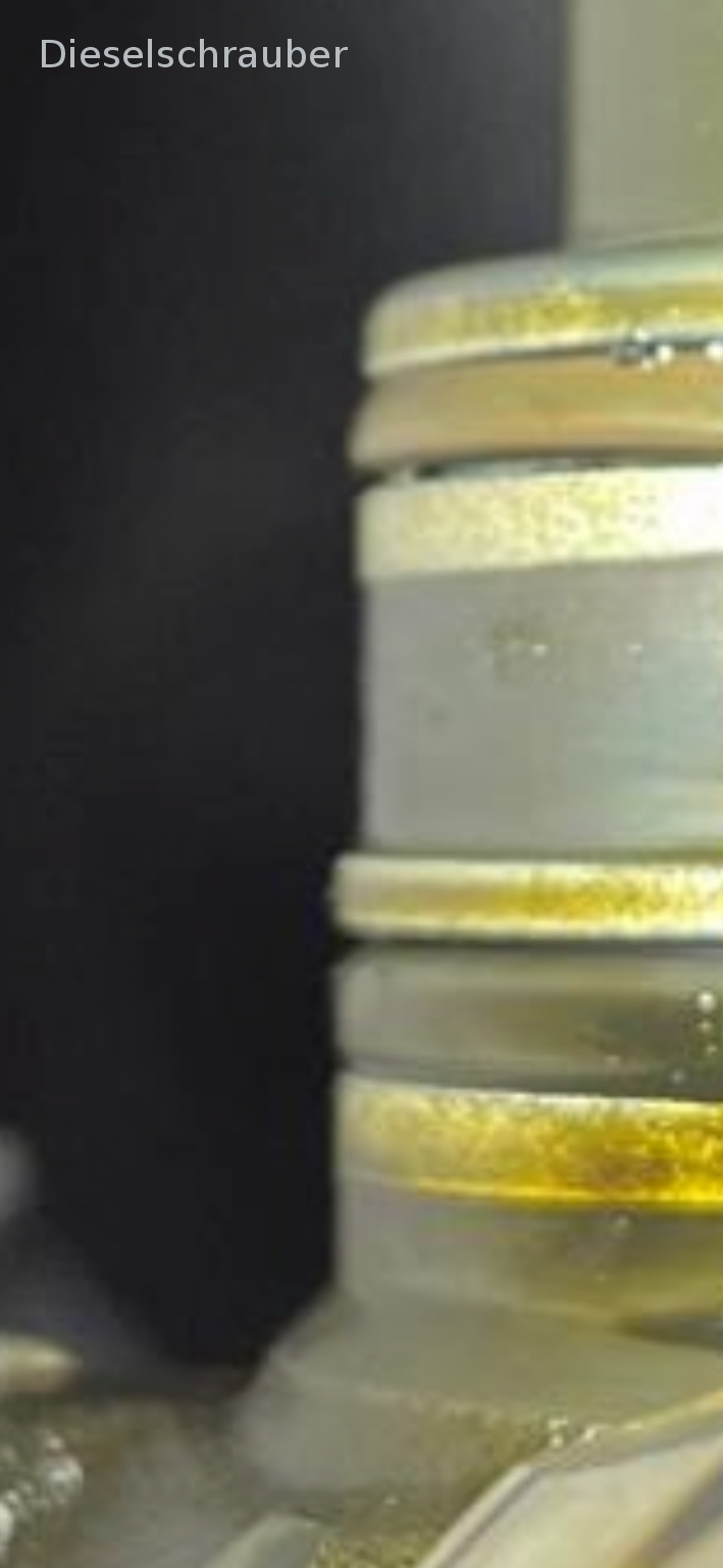

Post14-12-2025, 16:36    Subject: Lupo 3L: No Power, Blue Diesel Smoke Quote
After a long period of inactivity, I finally started working on projects again.
As a last resort, I wanted to take a closer look at the pump nozzle elements.
They were surprisingly easy to pull out.
It seemed like the sides were already very worn down where they would rub against the cylinder head.
I replaced the seals, and lo and behold, the engine runs without blue smoke and with all its 60 horsepower icon_biggrin.gif.
Apparently, the middle O-rings were leaking so badly that the diesel was flowing directly back into the tank, and the PD elements were unable to draw in enough fuel.
In the process, the workshops have already replaced everything they could, including the tandem pump, diesel filter, air filter, and apparently also the turbocharger.
Now, the little Lupo is running on diesel again.
Thanks again for your great support!

Post14-12-2025, 19:36    Subject: Lupo 3L: No Power, Blue Diesel Smoke Quote
Thank you for the feedback! X
Without a genuine lambda sensor, it's difficult to detect the problem through diagnostics unless the system is disassembled.
