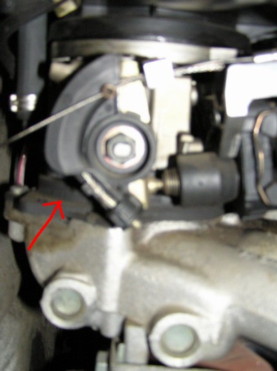

Post21-11-2004, 21:50    Subject: Gas Price Panic: Desperate Measures? Quote
Avenga wrote:
I don't understand the function!
What is there to understand about that?
The part only needs to seal the intake manifold from outside air.
In carburetor engines, the oscillating element serves to decouple the fuel-air mixture preparation from the intake manifold. This allows for a (desired) oscillation of the air column.
Since monoblock injection systems function similarly to carburetors, they often also incorporate a similar oscillating element.
Attached is a blurry picture of the fuel injection system in a Golf 3.
At the very bottom, you can see the intake manifold, above which is the vibrating element (red arrow), followed by the mixing chamber with the throttle valve. On top of that (in black) is the snorkel that leads to the air filter.
On the Golf 3, the swirl flap is a single component and can be replaced separately with a total of 4 screws. On my Golf 2, the entire intake manifold with the throttle body had to be replaced.
