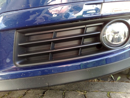

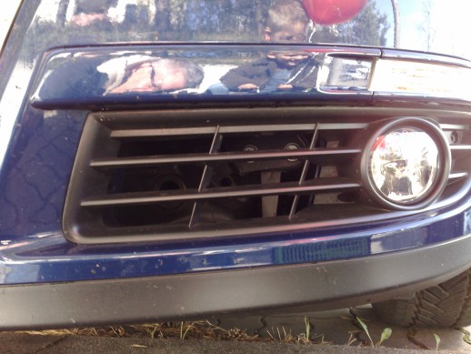

Post17-10-2007, 10:24    Subject: Quote
Okay.
Here's a direct comparison of the grilles: "for Nebler - all models" == summer, and "for Nebler Bluemotion" == winter.
 File size:  61.92 KB
 Viewed:  3541 times
 File size:  54.27 KB
 Viewed:  3465 times

Post17-10-2007, 23:29    Subject: Quote
It looks much better now.
I think your BMR will thank you for it, especially in the winter icon_smile.gif.

Post22-10-2007, 9:24    Subject: Quote
The "WinterGitter" has been installed.

Post15-12-2007, 23:36    Subject: Quote
I think I've found out why there are open grids at all.
As with the Golf 3 era, under certain circumstances, there is a supplementary radiator. It seems to be located directly in front of the left front wheel and is being drawn in through the open grille.
Since I don't have an automatic transmission, and I don't live or drive in warm climates, the grille remains closed!
