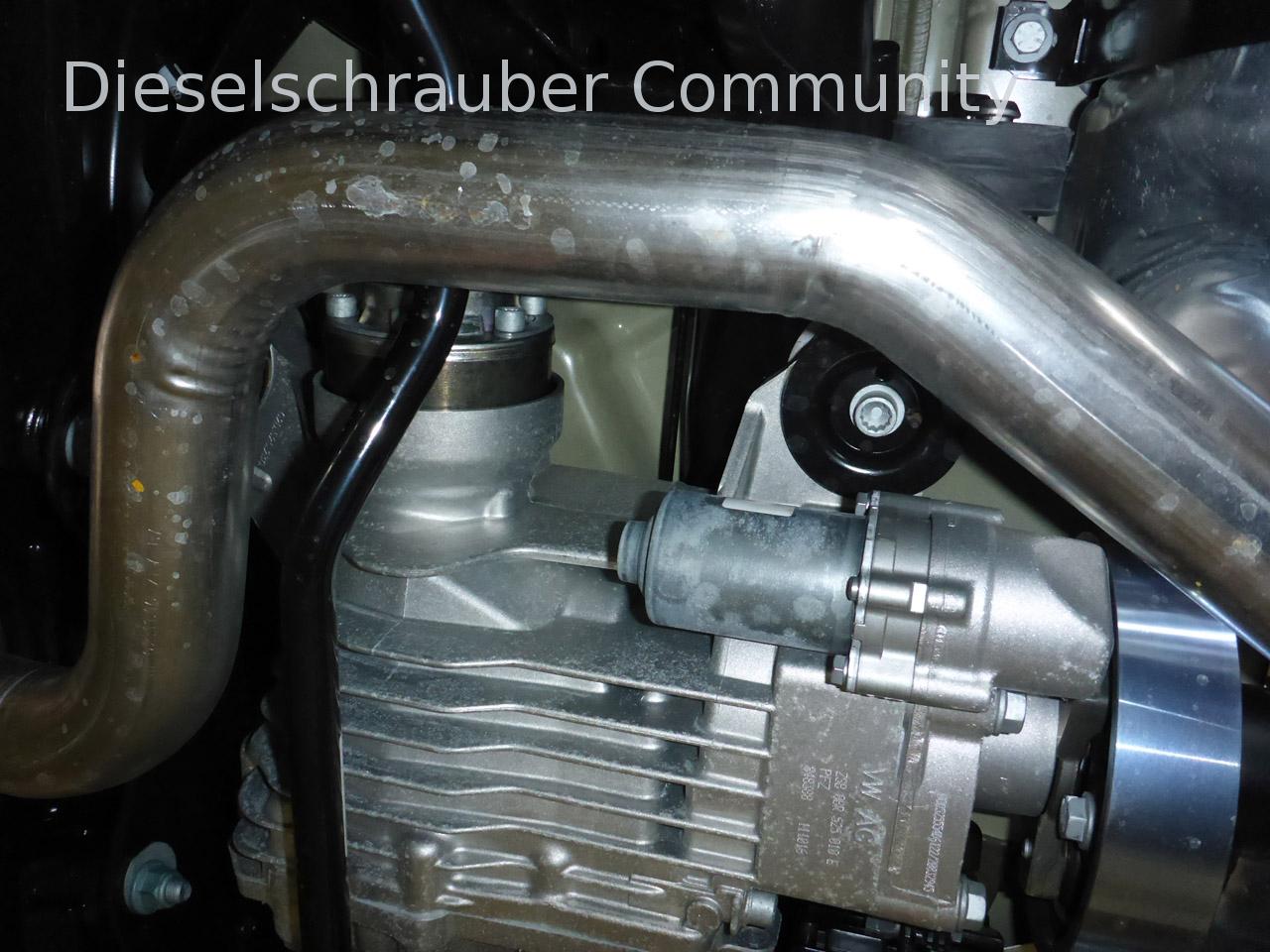

The two right-hand Torx screws are for the differential. The bulge in the center at the top, with the Torx screw, should be the reservoir for the Haldex oil.
(everything below the image)
Unfortunately, I could only find one SSP (Service Service Publication) online for an older Haldex version, specifically SSP414.

The complete scan will follow as soon as I get it back from the underbody protection treatment. icon_redface.gif

Post12-01-2017, 20:13    Subject: Quote
dieselschrauber wrote:
The two right-hand internal hex screws are for the differential. The bulge in the middle at the top, with the internal hex screw, should be the reservoir for the Haldex oil.
Best regards, Rainer
I can confirm that. The two on the right are for the differential, and the upper left one is for the Haldex oil. That's also where we top it up.
