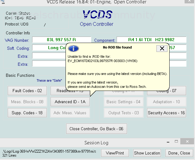

Post01-12-2016, 23:46    Subject: Norton VCDS-16083: Removal Guide Quote
Okay, here's the translation:
Thank you.
It already provides a certain level of security.
The version 16.8.4 downloaded from RossTech was not the same.
Deleted by Norton.
Following your encouragement, I was then able to find the courage to take on some responsibility for the version that was still not very widely used.
The vehicle is currently missing a .rod file for the engine.
I believe it has been reported.
Is a different .rod file required after the diesel update?

Posts: 18128
Post02-12-2016, 11:03    Subject: Norton VCDS-16083: Removal Guide Quote
If the VAG part number of the engine control unit or the corresponding ASAM identifier has changed, of course.
You would probably have had more success with the current German version of VCDS, as many of the models driven here in the USA are not available there.

Post02-12-2016, 16:12    Subject: Norton VCDS-16083: Removal Guide Quote
The German VCDS version: RKS 16.8.3.4 recognizes the code.
EV_ECM16TDI02103L997557R
Not with the ending "R", but perhaps with some other endings (-B, -G, -K, etc.).
*******read today********************
Address 01: Engine Control Module (J623-CAYC)
Label file: None
Part number SW: 03L 997 557 R, HW: 03L 906 023 A.
Component: R4 1.6L TDI; Part Number: H23 9982.
Revision: --H23--- Serial Number: 00000000000000
Encoding: 00114036032401080000
Operating number: WSC 01357 011 00200
ASAM Dataset: EV_ECM16TDI02103L997557R 003003
ROD: not applicable.
VCID: 4B92C5AEE2C37D66DB-801E
No ASAM data available: "EV_ECM16TDI02103L997557R" (VW36)
No error codes found.
Readiness: 0 0 0 0 0
The old EV_ECM16TDI02103L906023HM.rod file exists.
in the old UDS_EV folder, but not in the new one...
Should I wait for an update now, or is there another option available?
Have you ever managed to get a .rod file like that?
Does it ever happen that manufacturers intentionally create such "gaps" or loopholes?
Thank you very much.

Posts: 18128
Post09-12-2016, 12:07    Subject: Norton VCDS-16083: Removal Guide Quote
flexscan33 wrote:
dieselschrauber wrote:
Does it ever happen that manufacturers intentionally create such "gaps"?
Regarding the letters in the VAG part number? Of course, the numbers themselves aren't sequential either. icon_wink.gif
"By 'gaps,' I meant missing data."
Is it possible to only "forge" the ending of a word?
to even be able to start it?
What do you want to start? Starting VCDS has absolutely nothing to do with the ASAM description.
If your antivirus software repeatedly deletes the vcds.exe file, then disable the relevant directory in the real-time protection settings, or disable the scanner completely, and use the method I recommend.
Just wait until an updated VCDS version is available in the customer account.
Newsletters / product notifications ensure that you receive the appropriate notifications.
