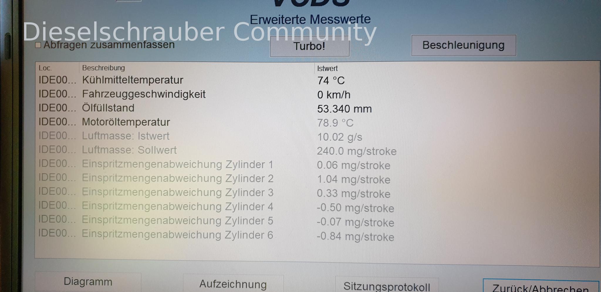

Hi everyone,
I drive an Audi A6 3.0 TDI from 2012 with the 245 hp CDUC engine. Current mileage: 275,000 km.
The engine makes a noticeable rattling sound when accelerating, and there's also a noticeable lack of power.
The error memory is clear.
I've attached a photo here that shows the injector readings at idle with the engine almost warm.
Before I damage the engine by running it with worn or clogged injectors, I'd rather ask a question first...
Cylinder 1 looks good, but cylinder 5 occasionally shows a value of up to 0.27.
Should I exchange them all?
If I understand correctly, based on what I've read here and on the internet, cleaning doesn't really make much sense.
Edit: Brand new Bosch injectors are available for significantly less than 300 euros per piece.
While the action might not be cheap, it's still better than having a broken engine.
Thank you very much for your efforts, and best regards.
Wolfgang.

The values all look good, but number two is a little elevated. If you want to know more about the condition of the injectors, you can check the injector timing correction values.
Your problem, however, stems from a different source. Are the throttle valve and/or the swirl flaps in good condition?

Post07-08-2020, 9:57    Subject: Should injectors be replaced with these values? Quote
Hi Herbert,
Thank you for your reply.
Of course, I'm pleased that the values are within the acceptable range.
I guess I'll have a lot more reading to do online. It seems I had misunderstood something regarding the values.
I'll take a look at the timing correction values and try to understand what they're telling me.
Regarding your question about the flaps, I am unable to answer it at this time. I'm completely at the beginning again regarding the investigation into the causes.
I'm going to look into the flaps now.
Thank you for the tip.
