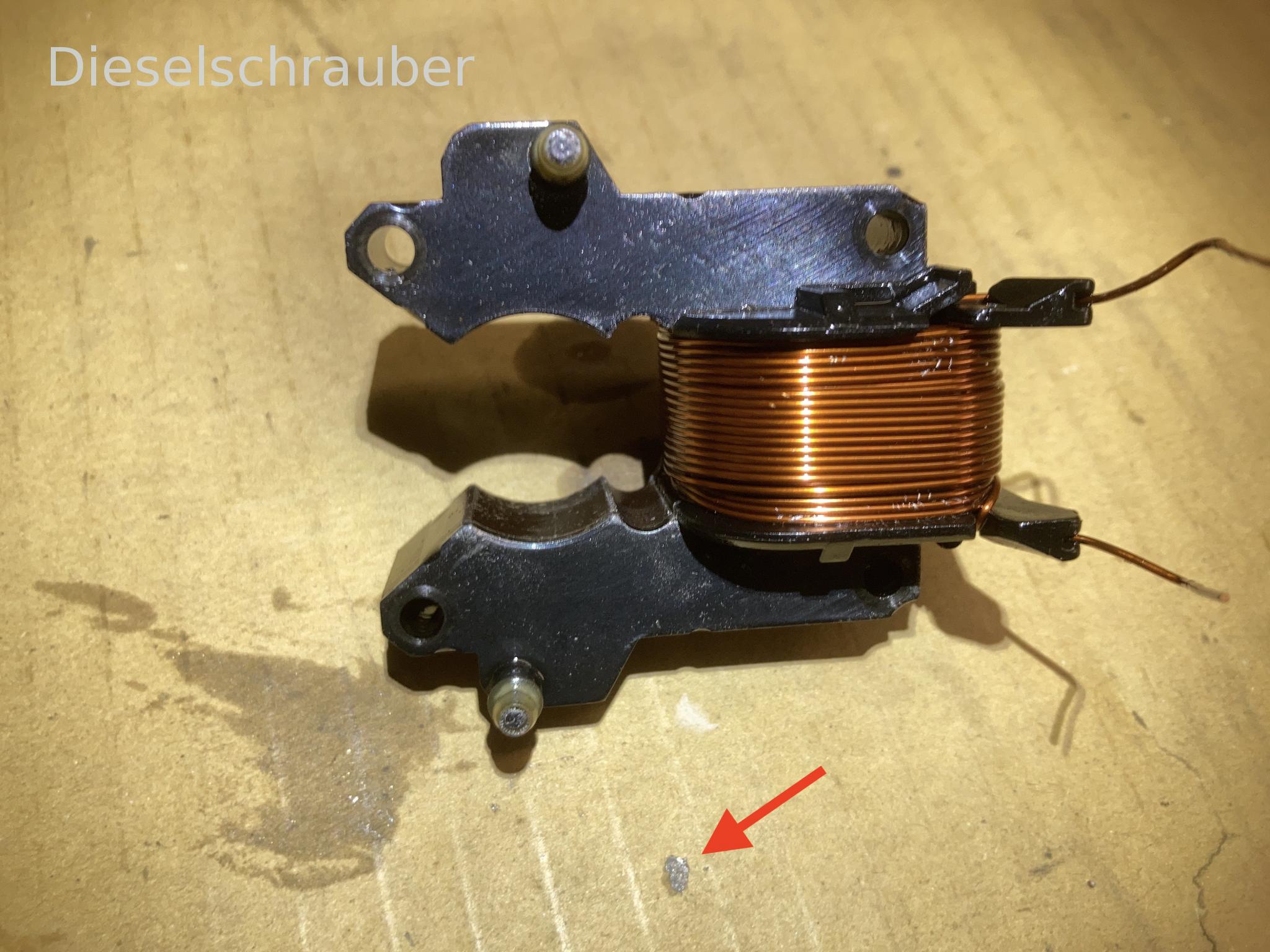

Post21-11-2022, 23:02    Subject: Quote
Oh no, here he is again.
Same issue after almost 6000 km.
Error codes 17969 and 17970, no other error entries found during the automatic scan.
This time, I skipped the usual troubleshooting steps and went straight to the source: I removed the cover of the engine control unit (ECU) and saw that the shaft of the mass airflow sensor (MAF) was stuck and wouldn't turn.
The ESP has been disassembled; the amount of debris is minimal and mostly consists of wear particles. However, a single chip was blocking the shaft, as shown in the picture (arrow).
Now I'm wondering where the shavings are actually coming from, and whether I'll have to stop every 5,000-6,000 km on the road, tow the bus, and remove the ESP system.
Therefore: how does the abrasion/chip formation occur, and how can it be avoided?
"Or should I just order a replacement pump and install it?"
 File size:  3.29 MB
 Viewed:  212 times
Translated on 02-08-2026, 17:00.

Post22-11-2022, 7:04    Subject: Quote
Hi there!
I suspect the debris is coming from the pump itself.
Translated on 02-08-2026, 17:02.

Post22-11-2022, 10:33    Subject: Quote
Do you mean from the high-pressure section?
Shouldn't there also be problems with purely mechanical pumps?
Or defects caused by abrasion/chips in the high-pressure section?
Similarly, if the debris were generated by the booster pump – which also exists in non-electronically controlled ESPs.
And eventually, every filter, every sieve, would become clogged.
Or does only the large iron anchor, with its applied tension and resulting magnetism, make the difference and cause the problems?
Translated on 02-08-2026, 17:03.
Posts: 18113
Karma: +799 / -0   Thank you, like it!
Post22-11-2022, 21:16    Subject: Quote
Iron/steel shavings could enter the electrostatic precipitator (ESP) due to broken springs. Aluminum shavings are more likely caused by a misadjusted injection start setting.
Whether I would choose to replace or clean/flush the ESP unit (always including a functional test) would depend on the condition of the rest of the vehicle.
Translated on 02-08-2026, 17:04.

Post22-11-2022, 22:56    Subject: Quote
Hmm. I got this bus for free, but it has a broken timing belt.
Tool cart, a little dented, but in excellent condition regarding rust.
"The engine has been repaired with the following parts replaced: valves, valve guides, pistons, connecting rods, timing belt (of course), water pump (new), and a new starter."
Rebuilt transmission installed, along with the exchange of the left and right drive shafts, and all ball joints were replaced. The front brakes have new rotors. The ESP (Electronic Stability Program) was removed approximately 6,000 km ago, cleaned, and reinstalled, which is what this thread is about.
The car is incredibly fast and a lot of fun to drive, but it's been getting towed lately because of a faulty ESP system. So, I spontaneously ordered a refurbished ESP unit and hope it arrives by the weekend.
I'm willing to take the risk with the ESD issue, but I might find some time during this repair to remove it and have it tested.
I'm not saying that leaving the country solely for financial reasons can only lead to a better future, but the only thing I foresee needing repair on the van is the rear brakes when the pads wear out, and I also want to replace the windshield, which has some scratches.
It's manageable, the cabin is now worth it to me, and the rest is either new or refurbished.
Unfortunately, the ESP can only be replaced. So, I'll have to get rid of it, but right now I don't feel like fixing it myself in a way that would make it last significantly longer this time. It seems like last time I only addressed the symptoms and not the underlying cause.
This time, it was all just debris; I didn't even check if it was magnetic or not, but there was a significant piece that blocked the impeller again.
Translated on 02-08-2026, 17:07.

Post23-11-2022, 20:00    Subject: Quote
I'm willing to take the risk with the ESD, but perhaps I'll find the time during this repair to remove them and have them tested.
Life experience:
- Generally usable up to 250,000 km, of course depending on whether it's mostly highway driving or city traffic.
- It's generally safe to replace it after 300,000 km. You can skip the inspection if you don't have spare parts available.
Translated on 02-08-2026, 17:10.

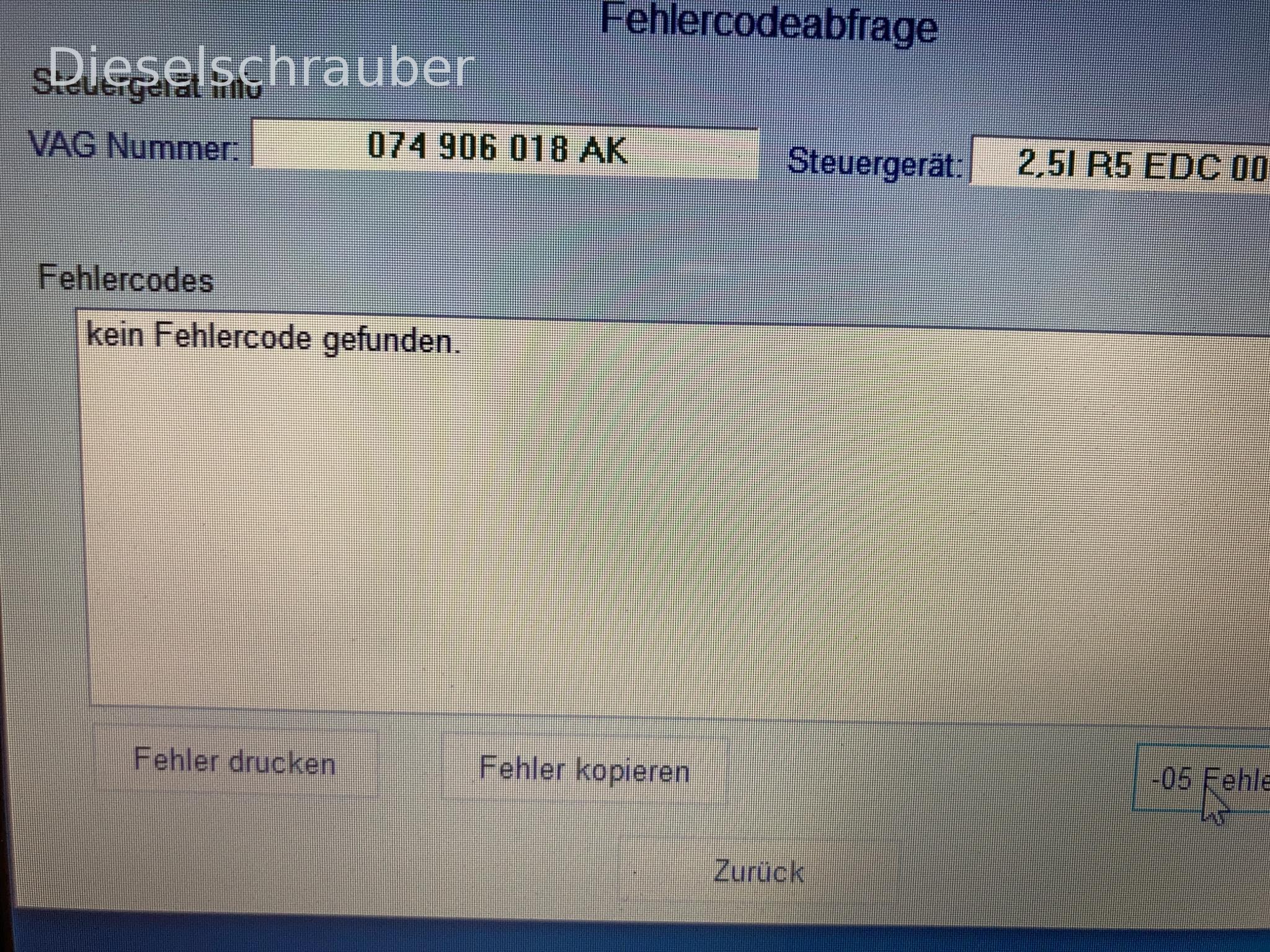

Post23-11-2022, 23:56    Subject: Quote
Generally, or specifically regarding TDI engines?
The car is 21 years old and has 259,000 km (approximately 161,000 miles) on the odometer. I suspect that, on average, it hasn't been driven very long distances each year.
Okay, well, let's see. I'll definitely keep an eye on the ESD (Electrostatic Discharge).
The "new" ESP arrived in less than 24 hours, I installed it just now, and the engine is running again.
Tomorrow I'll retrieve the tent from where it's been and re-attach the front panel; hopefully, the dynamic adjustment will reset itself.
Translated on 02-08-2026, 17:12.

Post26-11-2022, 18:17    Subject: Quote
Okay.
I wasn't initially happy about buying a refurbished ESP directly without at least thoroughly inspecting or even repairing the old one. Then, I was immediately overwhelmed by the speed at which the new one was delivered, but I managed to set it up temporarily and install it on Wednesday, with all the settings finalized by Thursday.
Wow, what can I say: it's the difference between night and day.
It starts up better when it's cold, and it doesn't smoke at all anymore, especially not during acceleration.
It's kind of a situation where you're forced to find the right solution through the circumstances.
 File size:  2.29 MB
 Viewed:  214 times
 File size:  2.29 MB
 Viewed:  191 times
Translated on 02-08-2026, 17:13.
