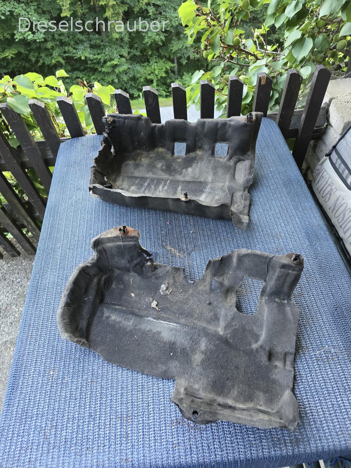

Post28-06-2025, 20:43    Subject: Quote
Today, I removed the oil pan insulation from a Passat and a Golf 7.5! Both were Alltrack models with the massive steel oil pan without cooling fins. Sure enough, the oil temperature is now noticeably lower in the Passat. The Golf will be tested soon! Best regards, Manfred.
 File size:  6.63 MB

alevuz wrote:
Habe heute beim Passat und Golf 7.5 diese Ölwannendämmung rausgeworfen!... Beim Passat ist die Öltemperatur jetzt deutlich geringer...
The oil pan is still in its original packaging. While it could be a good idea to replace it for the summer, even with the heater off ("AT" - ohne Zuheizer), the car barely reaches 70°C water temperature on the dashboard after 20 minutes of driving. I wouldn't want to make that situation any worse.

Post01-07-2025, 19:24    Subject: Quote
As I mentioned before, with my Golf 5, I drove 507,000 km without this insulation. It's worth noting that I was using the same LL3 oil as I am now... it simply didn't exist back then. However, the temperature never exceeded 125 degrees Celsius. I could monitor it through an additional module in the FIS (multifunction display). Honestly, I prefer a constant 80°C to temperatures above 130°C, especially with this start-stop nonsense (which I have deactivated in both of my cars). In that situation, the engine works harder and you come to a stop before the construction site, and then the car shuts off completely.When I look at our trucks now, I always wonder why the start-stop system doesn't activate until about 5 minutes of idling.
