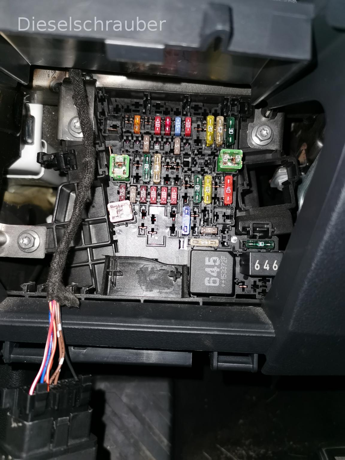

Thanks, Rainer! I can read the gateway. It was contact 1 (permanent plus) on the gateway. I first connected a cable to the battery, and suddenly, I could see something on the display.
I've been searching and found out that pin 1 of the gateway should be powered by terminal 30. I've checked all the fuses again, and none of them are broken or burnt. Surely there are still other things connected to terminal 30, right?
Can anyone give me a tip on where I should look next?
Best regards and many thanks,
Carsten.

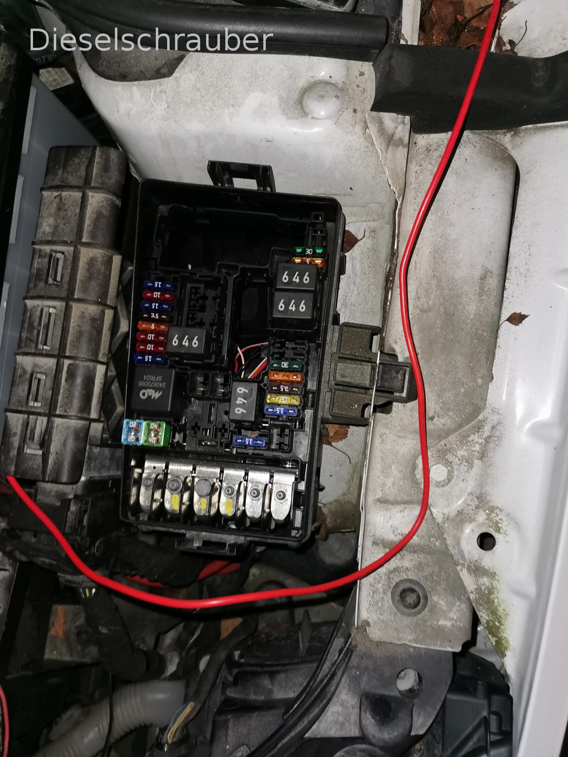

Post02-12-2025, 17:55    Subject: Image of engine compartment fuse box. Quote
Image.

Post02-12-2025, 19:09    Subject: Re: No power is reaching the CAN bus gateway Quote
Hi.
How is the cigarette lighter/12V socket connected, and is it not connected via terminal 30?

My last mistake was that I had expanded too much and also the fuse box insert. Well, that's very central, I realized. So, I put that in and connected a permanent positive cable to pin 1 of the gateway. And suddenly, many errors disappeared!! I turned the key, and the Octavia started running!! Awesome!!
After almost a year of being on standby, there's still a lot to do!
I have one more question. According to the wiring diagram, the cable comes from fuse 13 in the ebox. I actually want to run a new cable from there. To do that, I need to access the ebox. Unfortunately, I haven't been able to find a video showing how to disassemble it. Does anyone have any tips?
